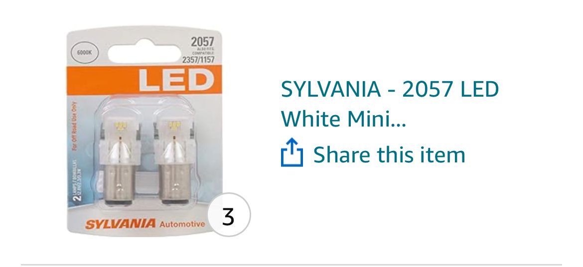

Ok so it’s the “park lights” causing the issue but I am still curious how the turn signals function fine with the “park lights” off. The LEDs used were Osram Sylvania wedge base LED bulbs. Not sure you can put them in wrong because the are poke yoked such that one ear is higher than the other.
OK now the picture is becoming clearer.
Take out the bulbs and see if the problem goes away. The TSs won't flash but the other things, like the dash indicators coming on, should clear up. If so, you should probably get some other kind of bulbs.
Did they work mostly right (except maybe some not lighting up) when there were regular bulbs in there?

Update- incandescents back in and they seem to work.
The mystery is the Osram Sylvania bulbs are 2057s and appear to have two filaments. They have the same nubs for poke yoke so one cannot put them in wrong.

:shrug:
Oh well, it is what it is, and now you know what that is. Maybe those just won't work in this kind of car. Which would suck.
With different flashers, one specifically for LDEs, the results might be different. Iunno. Kinda expensive to find out. Butt also, kinda expensive to buy all those bulbs. So don't dive too much into the "sunk cost fallacy", butt, if you REALLY want the LEDs, you might want to try that. Maybe one flasher and see how it does.
Also, the side marker bulbs work by being in series with the TS/brake filaments. If those are still incandescents, might wanna try swapping those to LEDs as well, since having the 2 types mixed, probably isn't going to play nice together no matter what flashers you have. You can get red and amber 194 replacement LEDs for those. Those aren't polarized in any way though; be careful to swap them to the polarity that works, if the ones you get happen to need to go in the right way.

ok so I was looking at the contacts of the Osram Sylvania LED vs the incandescent bulb. I am wondering if the contacts are touching both the park positive and the turn signal positive causing the issue.
