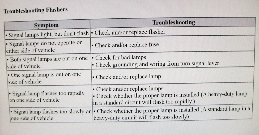

Did You Troubleshoot Your Flasher
Attached Thumbnails turn signal/binker not working...-006.jpg

nope, they dont flash with the flasher on, they just stay on... ill use that chart and troubleshoot it... is there a blink module??
