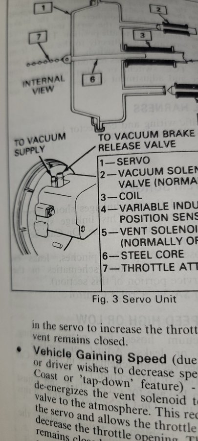

I'm checking the vacuum. The ball is good, however if I apply a vacuum pump to the large line that connects to the servo, should I hold vacuum. This is the line that goes to the brake switch. I unplugged it at hooked up a hand vacuum pump and it's not holding vacuum. It's my understanding that, that line goes to the brake pedal switch, and when the pedal is depressed, it dumps the vacuum. So that line should hold a vacuum, no?

That was indeed the problem. The clutch switch was out of rig. It wasn't in far enough so the switch was never depressed so it was dumping the vacuum. Works now. Wonder if the engine saw that as a constant vacuum leak?
