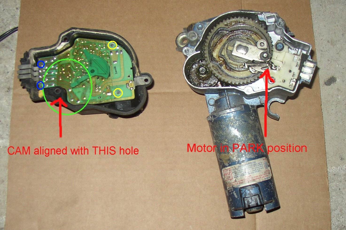

...............And if you need the little arm piece, I have some spares (thanks to the minimum order requirement from the place that printed mine) as well as the STL file I will send to anyone who requests it.
Funny, You just came up in a conversation with another Berlinetta owner with Wiper issues about a week or 2 ago. ( his Wiper cover got busted while pulling his engine.
) I'm glad to hear that you were able to craft / restore a fully functional Wiper Assembly; these things are ridiculously hard to find these days.I'd be interested in obtaining a spare cam "arm" or 2........ Send me a PM so we can maybe work something out !
If you have one of these, do yourself a favor and find the manual that tells you how to put it back on right or YOU WILL REGRET IT!
Picture of actual Wiper Assembly and Cam arm orientation:
Hope this helps !
