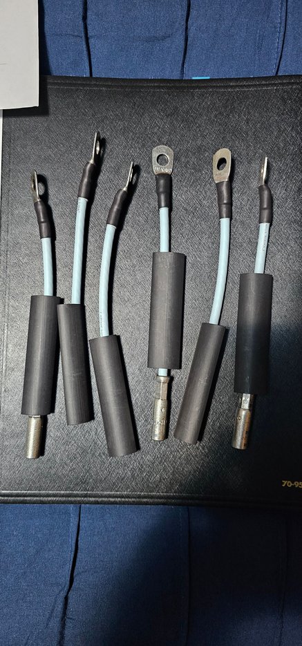

I just got my order of new fusible links in 8 AWG size since I'm running 2 gauge positive and negative alternator and battery cables. A bit overkill and since I'm down by the starter, going to heat wrap the wiring there. Grounds are ok btw. As for the battery, I'm just going to ditch the Costco one in there now and get an O'Reily's one even though I'm fairly certain they're both made by the same manufacturer.
