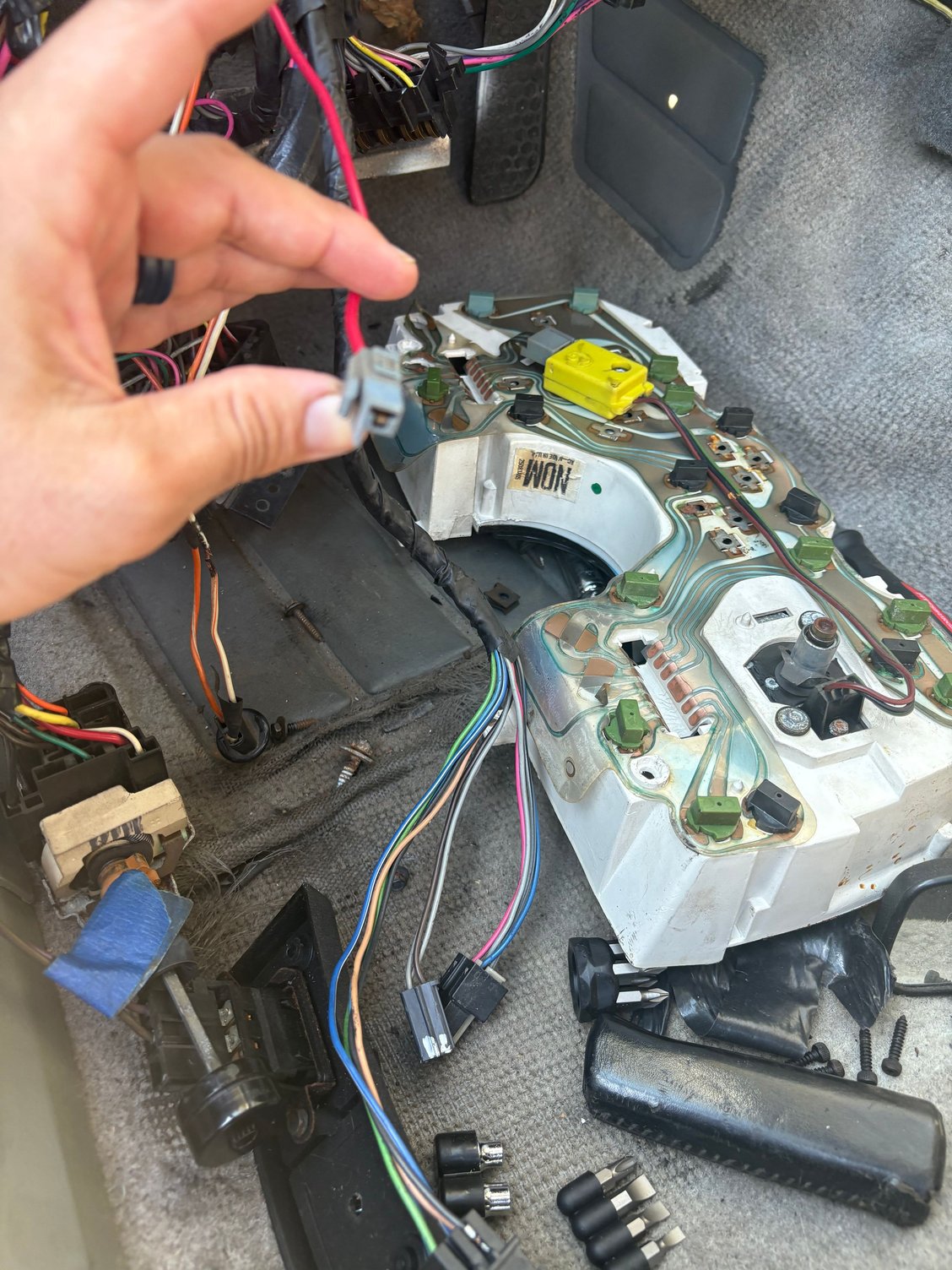

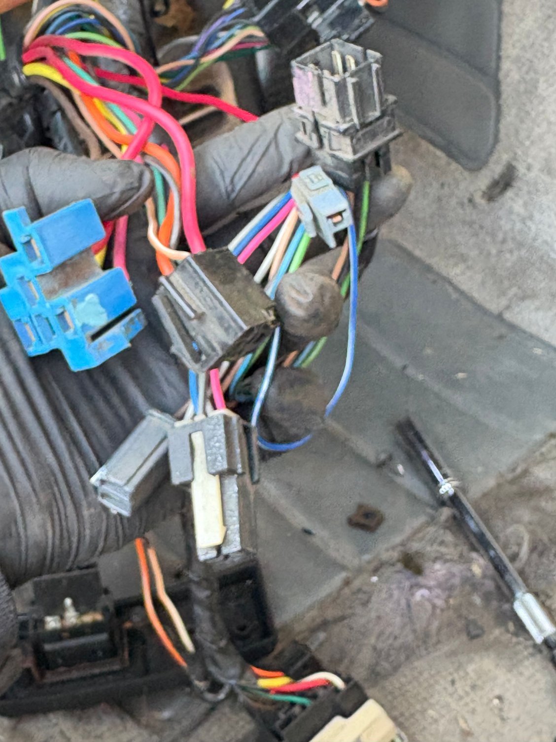

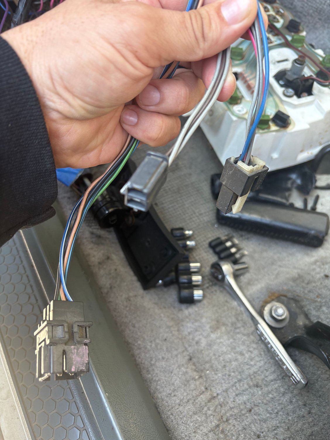

I’ve looked everywhere, I can’t seem to find where these connectors go
Old Mar 23, 2025 | 11:04 AM
LSZ28Ss's Avatar
Joined: Mar 2023
Posts: 27
All of these are under the dash.

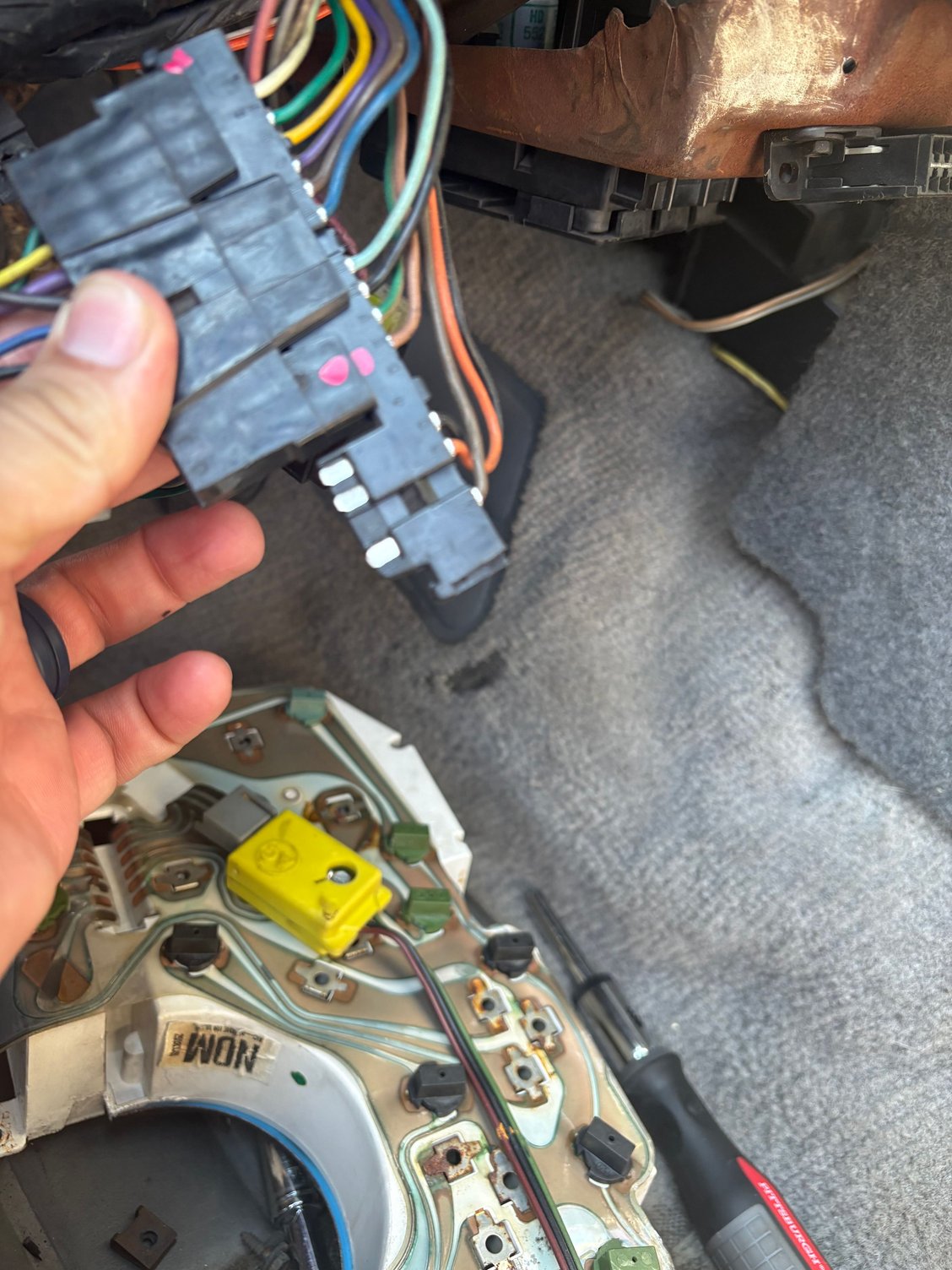

Re: I’ve looked everywhere, I can’t seem to find where these connectors go
The blue & black connectors with the big thick red pink yellow brown & orange wires included in them go to the ignition switch.
The long white one with pins on both sides goes to the instrument cluster.
The one with tan, light green, & light blue goes to the dimmer switch.
Can't really see the wires going to the others well enough to be sure about those.

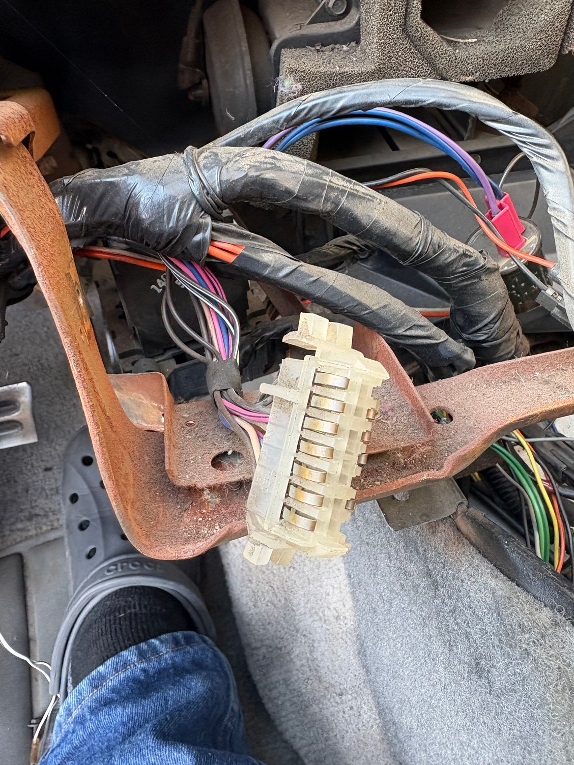

Thanks for the reply. Looks like my ignition switch is missing or I can’t find it. Here’s some more pics. I reply appreciate it.
Do you even have a column in the car ?
its mounted to the lower portion of the steering column

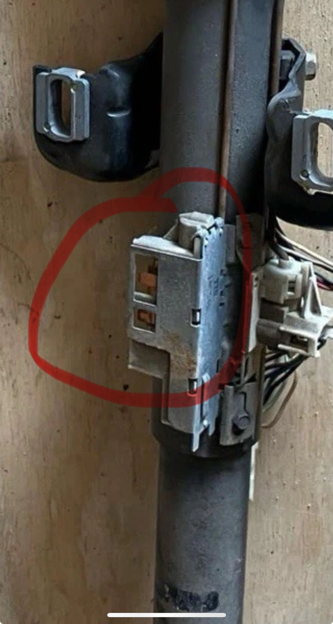

The ign sw sits on top of the column about 6 - 8" above where it goes into the firewall. The dimmer sw is kinda more on the side of the column just above the ign sw.
The 2 long connectors are for the turn signal switch. Also on the column.
The flat one with three very small wires is for the cruise control. Their mate is also hanging out of the column.
I don't mean to come across as a jerk, butt... if the column is in the car, and those connectors are hanging right next to it (as they are), and the places they go are plainly visible (as they are, except maybe the ign sw, butt that's SO obvious you don't need to see the whole thing), are you SURE you should be working on this car's wiring? Like REALLY REALLY sure?
yes, the column is there. Can’t find the ignition switch anywhere.
I think it’s missing the if ignition switch. I’m not the best but I’ll get it figured out eventually, this was my old SS I repinned. I’m new to the Iroc world. Just need some help. Thanks for the reply.
mine is missing. I ordered a new one. Thank you.
