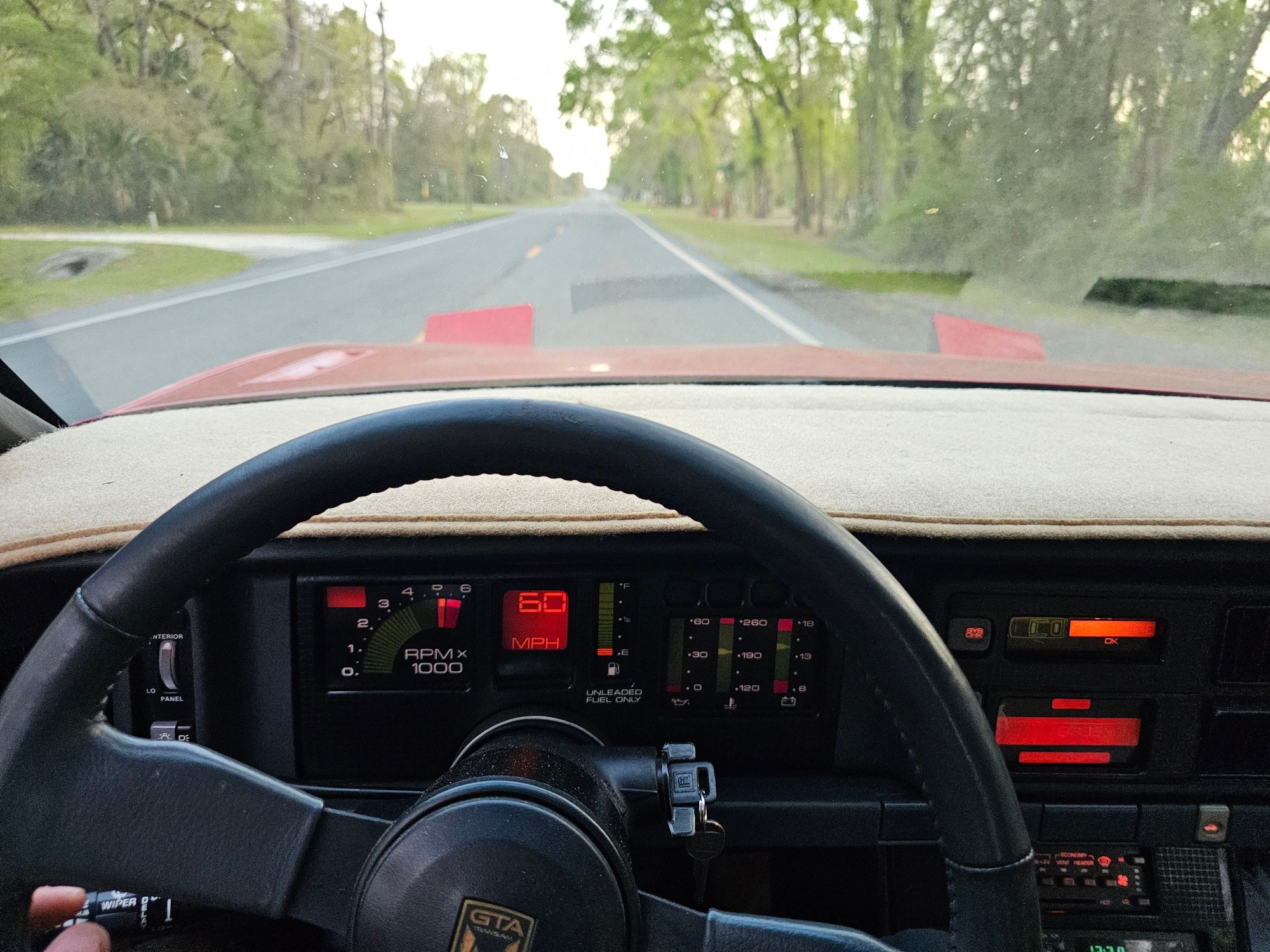

I have confirmed via gps that my speedometer is accurate to a T. However, my digital dash tach is way off. It must be. Warm idling at 2k, and when I'm cruising at 60mph... it shows 4,000 rpms... 1987 Trans am GTA factory digital dash car, with stock tpi 305 and a 700r4 odometer is only ahowing 67k miles. What should I check first? I would like the tach to be accurate. Everything is bone stock on the car outside of headers.

I spy that your 1987 GTA has the digital dash with a tach that has a 5000 RPM yellowline and a 5500 RPM redline. Your GTA being a LB9/MX0/MD8 car should have the "Peanut" roller camshaft (same roller camshaft in an 87 LG4 engine and 88+ L03 engines) version of the LB9 engine that runs out of breath at 4000 RPM and comes with a tach having a 4500 RPM yellow line and a 5000 RPM redline.
It's highly likely the digital dash in your car had some sort of fault at some time in its past and was swapped with another one from a car with a LB9/MM5/ M39 or MK6 5 speed manual transmission or B2L/L98/MX0/MDB car which has an engine with the "Hot" roller camshaft that runs out of breath between 4400 RPM to 4600 RPM.
The true mileage of your GTA would be unknown unless whoever swapped it found one with a very close mileage or was able to reprogram the chip with the actual mileage the car had before swapping the digital dash into it like the guys below have figured out. Probably not likely they did though.

That actually makes ALOT of sense... I imagine that finding a proper digital dash would be near impossible, however I do have plans to possibly 6 speed swap the car in the future, maybe a 5 speed.... Is it possible that someone could tune the prom to get a proper reading? Like If I crack open the diff to get gearing, tire size, etc...
