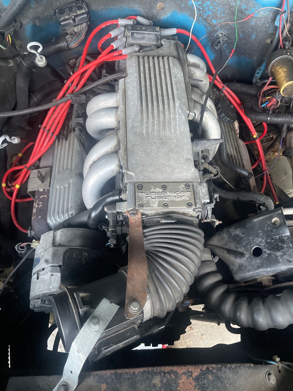

Old Jun 16, 2025 | 02:09 PM
poljung's Avatar
Joined: Jun 2025
Posts: 11
Re: TPI 1992 start and running problem
I will check more tomorrow based on your comments, the distributor har never been checked since years back. Cables and sparkplug yes. I reply once I digged a little bit more.

Originally Posted by poljung
oh wow, that’s not a 92 tuned port
Old Jun 16, 2025 | 06:08 PM
Tuned Performance's Avatar
Community Influencer
iTrader: (94)
Posts: 16,734
Likes: 993
From: Mile High Country !!!
Car: 1967 Camaro, 91 z28
Engine: Lb9
Transmission: M20
Btw what is this engine even in ? Looks closer to 85-86

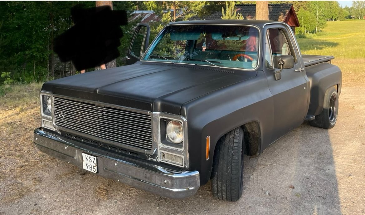

Old Jun 17, 2025 | 05:26 AM
poljung's Avatar
Joined: Jun 2025
Posts: 11
The engine is in this pick up.
Old Jun 17, 2025 | 04:17 PM
poljung's Avatar
Joined: Jun 2025
Posts: 11
Some updates, I continued on the fuel tip and I have another fuel pump. I changed it and needed to replace some poor wiring. And the engine changed behaviour to the better. Although I would not say it solved yet I need to run it more.
that was a surprise regards to the engine if it’s not 1992 it’s more like 198X? Really a surprise since I trusted the previous owner and so far I haven’t digged anything in this.
Old Jun 17, 2025 | 05:44 PM
iTrader: (94)
Posts: 16,734
Likes: 993
Engine: Lb9
Transmission: M20
Valve cover are 85-86, the ecm if it’s a 1226870 it’s a 85 1227165 more than likely a 86. Tpi Maf was 85-89 speed density 90-92.
Old Jun 18, 2025 | 05:06 AM
poljung's Avatar
Joined: Jun 2025
Posts: 11
ECM no is 1227165 so most likely-86 than, thanks for clarification.
