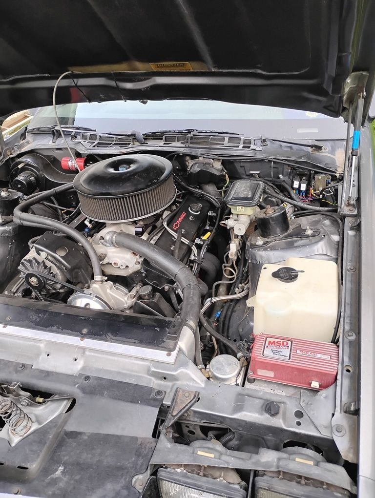

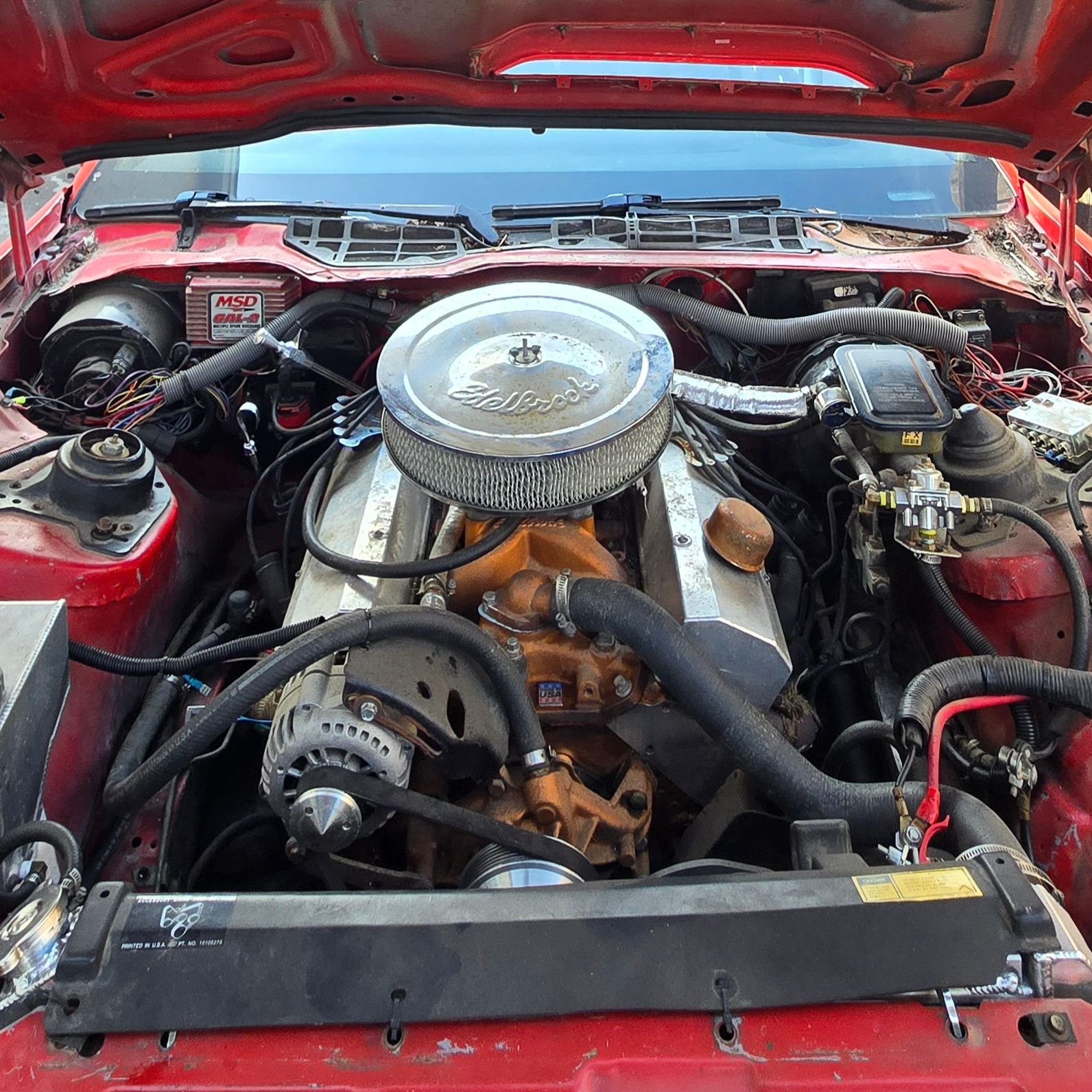

Here or there in the engine bay may not swing too much between minimum and maximum temperatures. Up high on the firewall, as far away from the headers as you can manage I think would be the best if the firewall is the only choice.
I've had an MSD 6AL box under the hood in my Camaro for more than 20 years but I chose the coolest location I could think of to mount it.
So far so good.
On a similar note, I've been noticing an increased bashing of MSD products in general. What used to last doesn't anymore. I can't relate anything specific on my end but that's the rumblings in the forum world as I've seen it.
