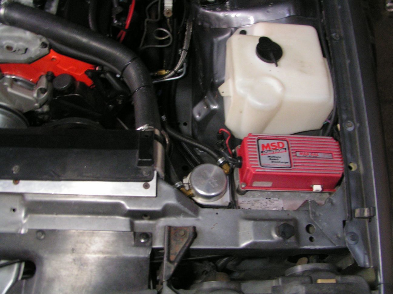

I'll try and get a better picture tomorrow. Mine is up behind passenger valve cover on firewall.
by https://www.flickr.com/photos/62639173@N03/, on Flickr

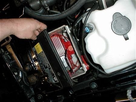

Hidden in the battery where it belongs. Being its a MSD product, I have it setup to be bypassed quickly if I suspect a failure. (Been through about 5 or so)

That's an awesome hiding place, in a fake battery!!

I have used an MSD 6xx box on all mo hot rods since the 80s. I continued to buy because it keeps the spark plugs clean and improves idle quality. I've had only one fail and it got fried because the voltage regulator failed and I didn't have a fuse between the MSD and the battery. I have a non-A/C car and mine is mounted in the same place as Boom's. You might be able to mount it under the battery or charcoal canister so that it is out of sight.

Mine is also located right there on the firewall by the blower box. I've never had any issues with it, but deep down I also know it's not necessary. I can bypass it literally in 60 seconds if need be.

TTop350 - Great idea on that Battery box !

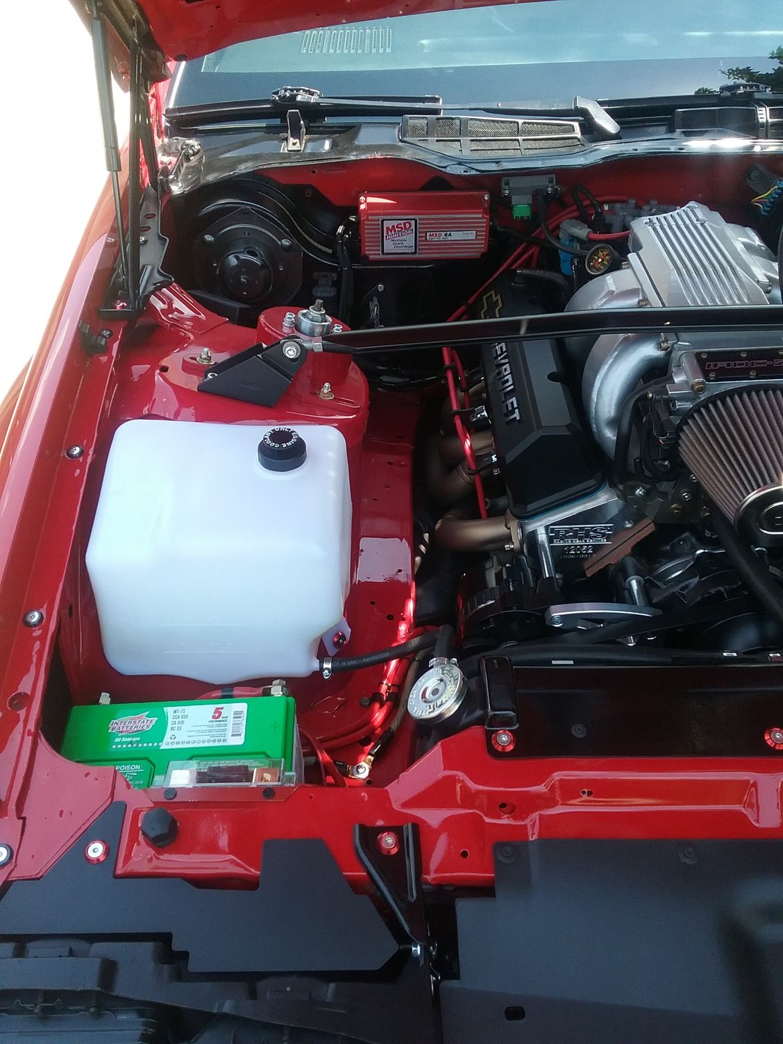

I mounted mine on the relay bracket between the master cylinder and the fender. Fits perfect.
Did you mount the battery in the spare tire spot? What bracket did you use, or did you fab one?
The world may never know!!!!
I had a 97 WS6 with a hidden nitrous kit. The fuel, nitrous and purge solenoids along with the RPM window switch and fuel pressure safety switch were all mounted inside a gutted out Delco battery. I ran the actual battery inside the spare tire area with the bottle. Yes, there was a plate separating them. No one had any idea the nitrous was there. Remote bottle opener and heater switches along with a pressure gauge were mounted inside the center console. It was a WOT setup so the micro swtich was mounted on the TB which had an OEM cover on it.
Dont ask how I gutted out a battery and disposed of the contents.

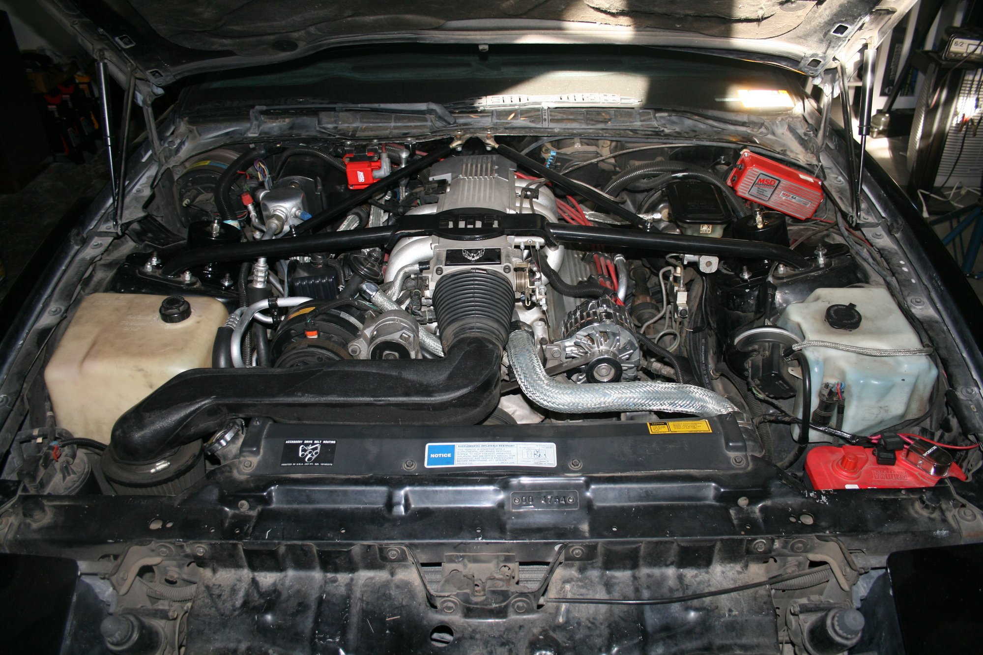

PO moved the relay bracket from the firewall to the top of the wheel well. The 6A fit right at the top corner of the firewall.
See post 109.
https://www.thirdgen.org/forums/tech...irebird-3.html
Note that's manual brakes so easier to see.

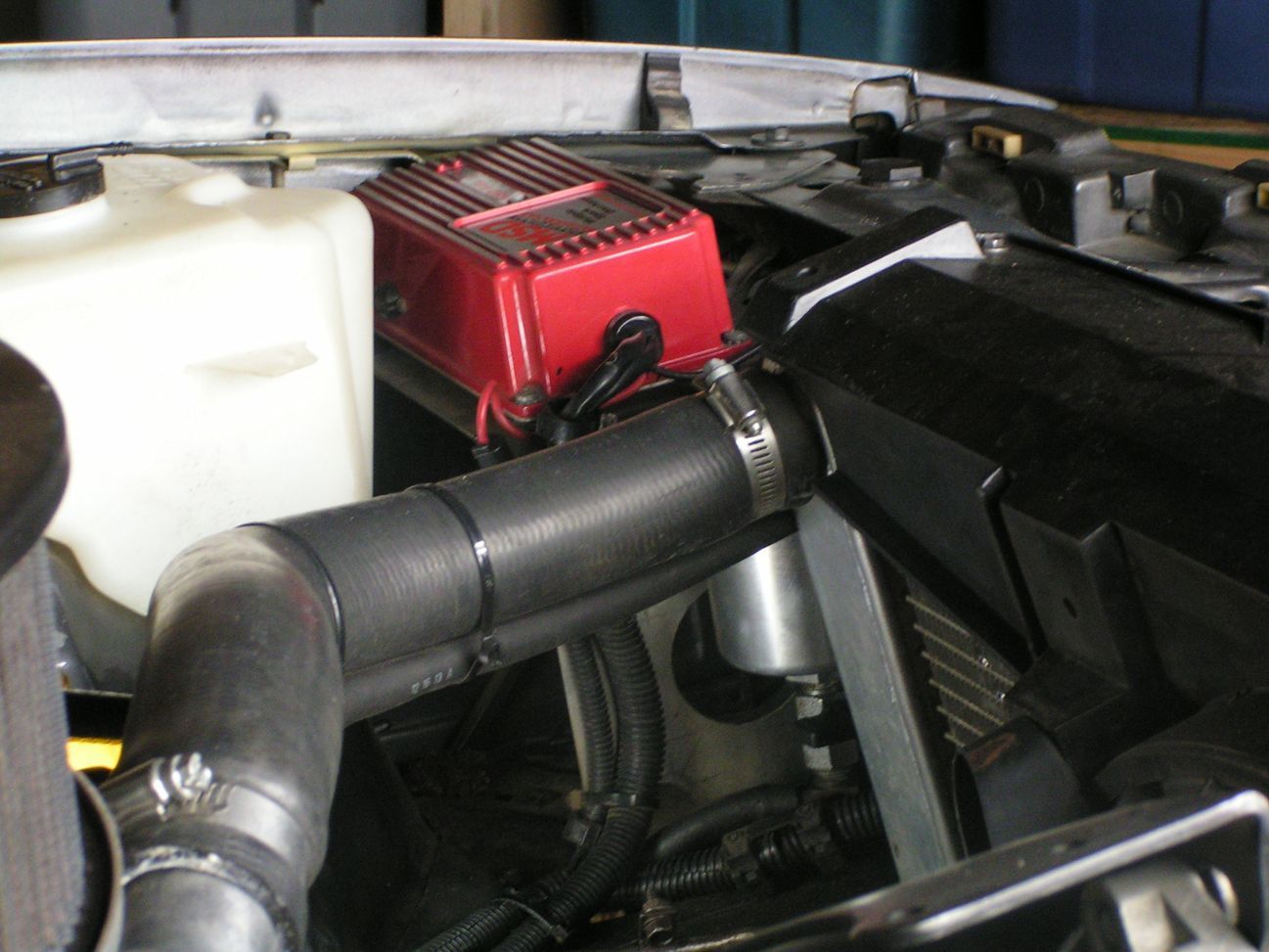

Bent up some aluminium sheet into a platform that fits over the charcoal canister.
