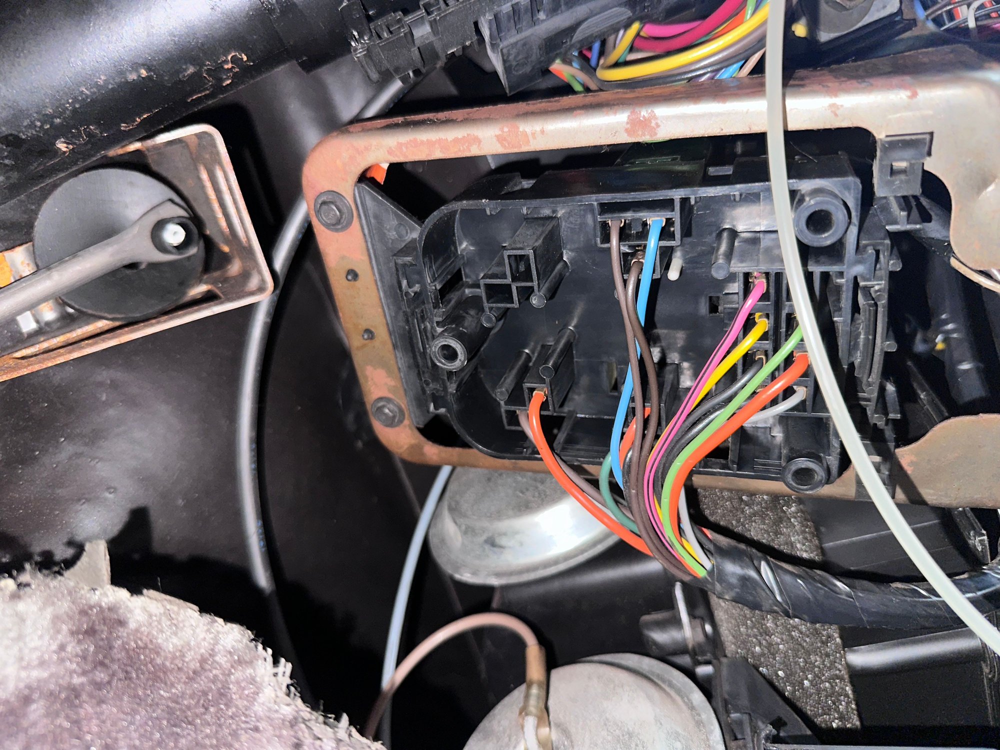

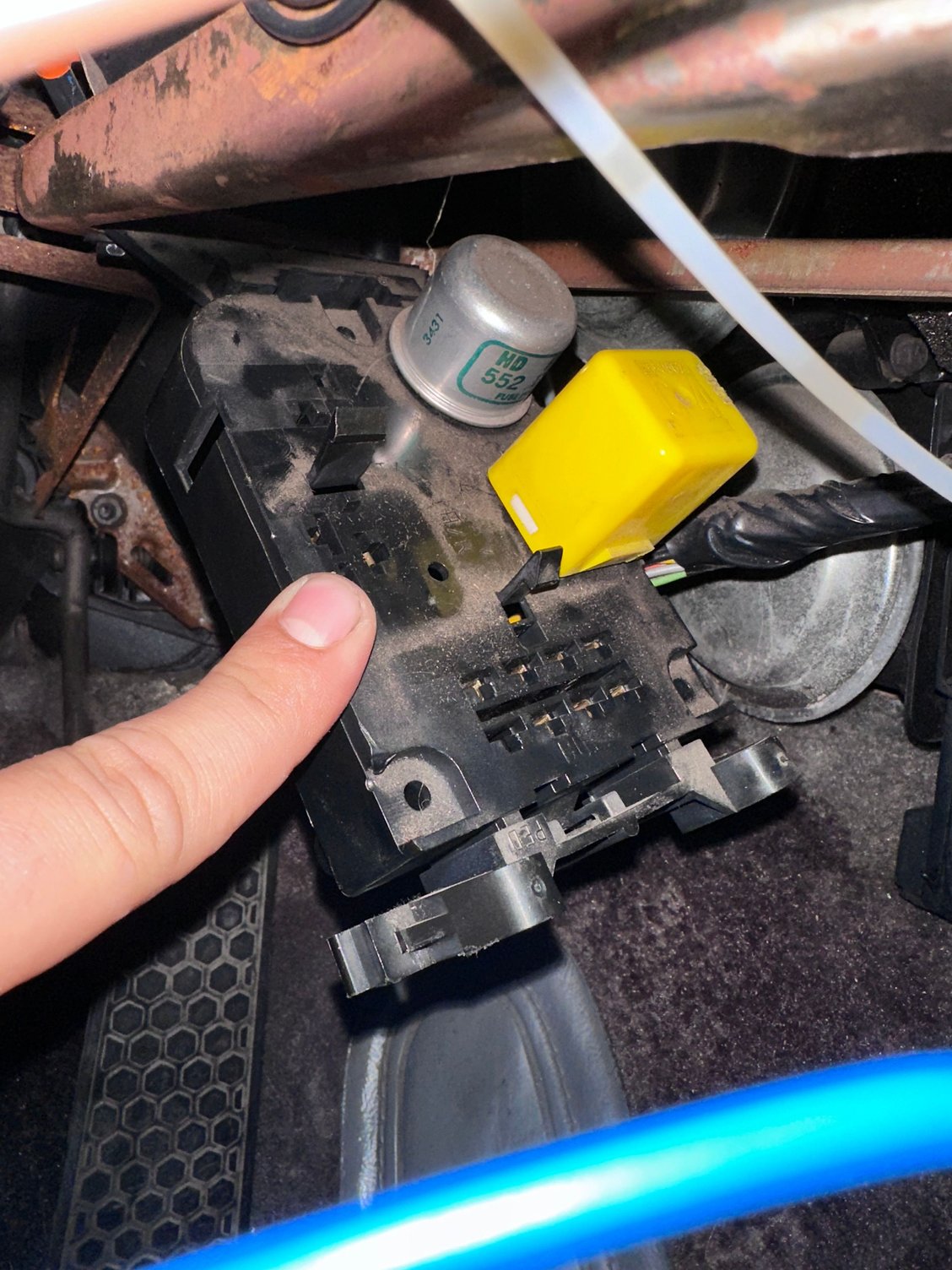

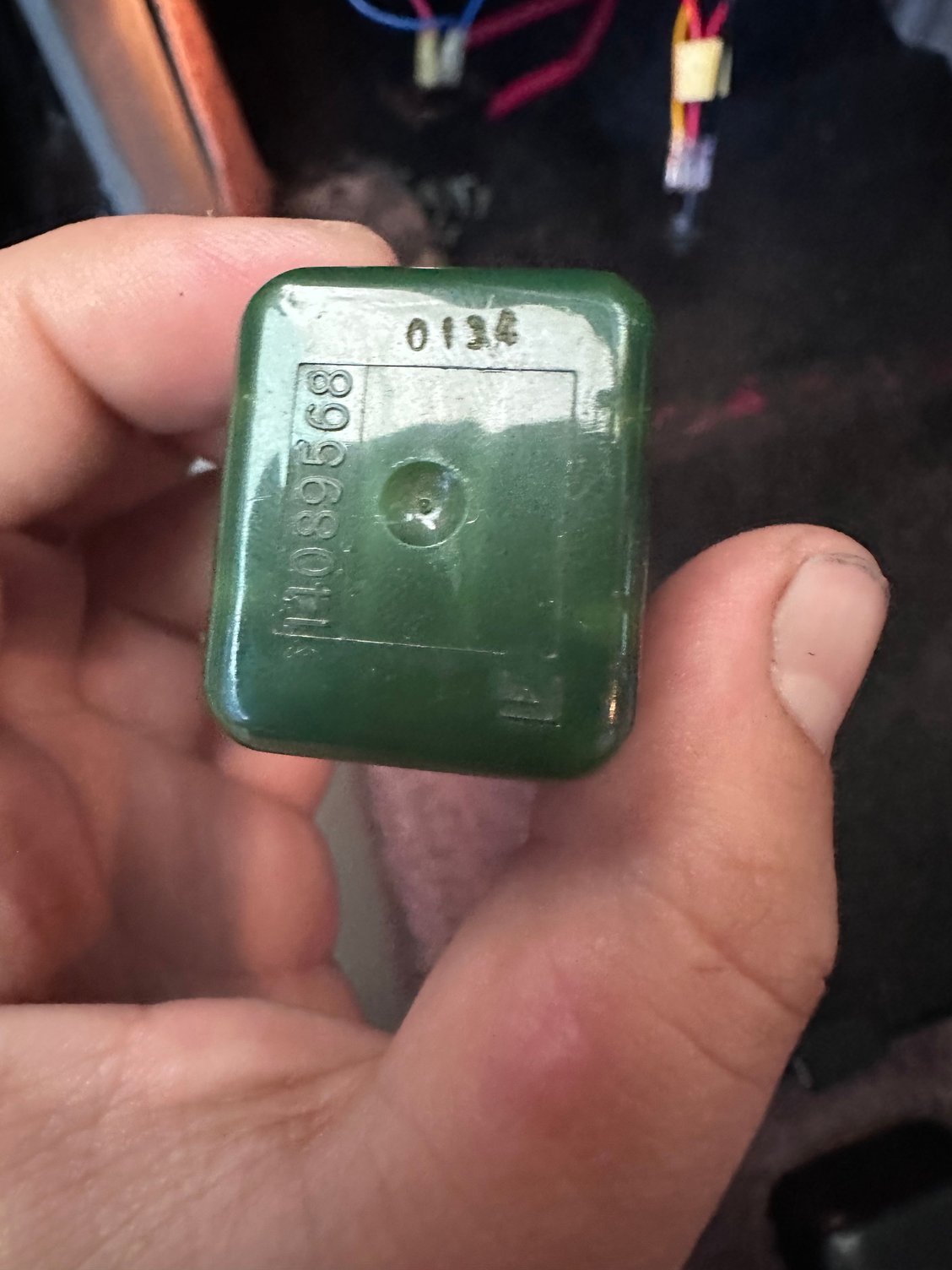

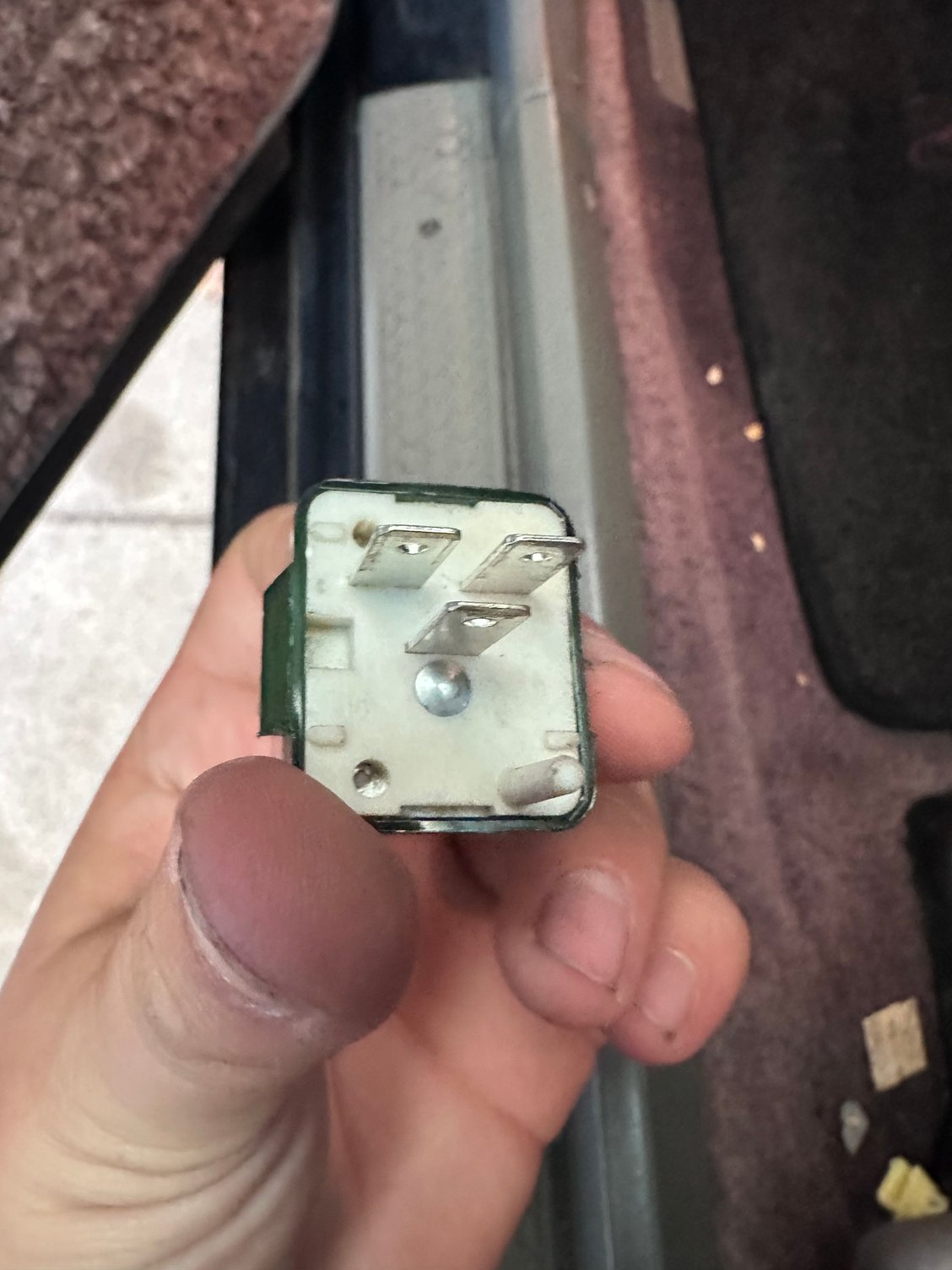

Edit definitely a relay, It's whatever this one here with two brown one blue is, 82z28 going to do some research and try and figure it out but any thoughts appreciated as always
Edit 2: it was this green thing which I believe to be the computer carb relay and since I have hei and electric choke wired separate it was just getting random signal and actuating rapidly, unplugged it while it was running and nothing happened, shut off the car and started back up fine. Going to wait for it to cool all the way down and start up to see if anything if off but if not I think I can finally start putting my cluster/lower dash back together.
The relay , part numbers visible

3 prong relay
3 prong relay
Where it was in the relay block, removed the chime to get access but I think I'm going to swap it with something else I have a few in the garage
Blue brown wire, I can feel the relay on top and feel the clicking from that one
1Blue 2brown wire, I can feel the relay on top and feel the clicking from that

That's the Choke heater relay. With it removed, your "Choke" (alternator) light will be on ...
