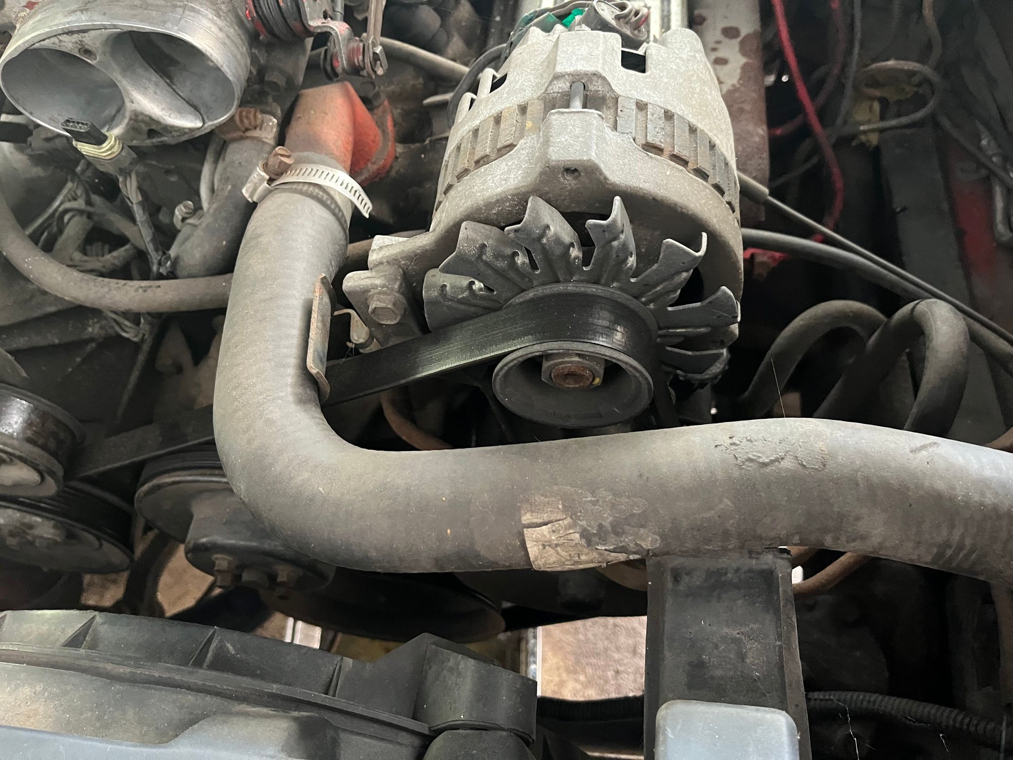

Anybody know what alternator this is?
Trying to determine what alternator this is. Believe it’s going bad as brand new battery is drained, and after jump start and running for a bit battery volts are reading even lower.
The cars an 87’ but I know the previous owner switched it over to a Serp Belt system as I needed a 88’ water pump when I replaced that.

Re: Anybody know what alternator this is?
That's an 88-92 style CS alternator. You should be able to buy a replacement for a V8 in that year range and have it bolt in.

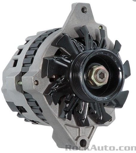

Looks like a 105 Amp CS130 made by ACDelco
$133.17 at Rock Auto.
You can buy a rebuild kit from Tuff Stuff for about $55 if you are good with your hands.
I’m gonna have it rebuilt found a local guy that gave me a half decent price rather than trying to tackle it myself. The battery is showing 12.5 when off, but I had it running after a jump start and it when down into the 8-9 range.
