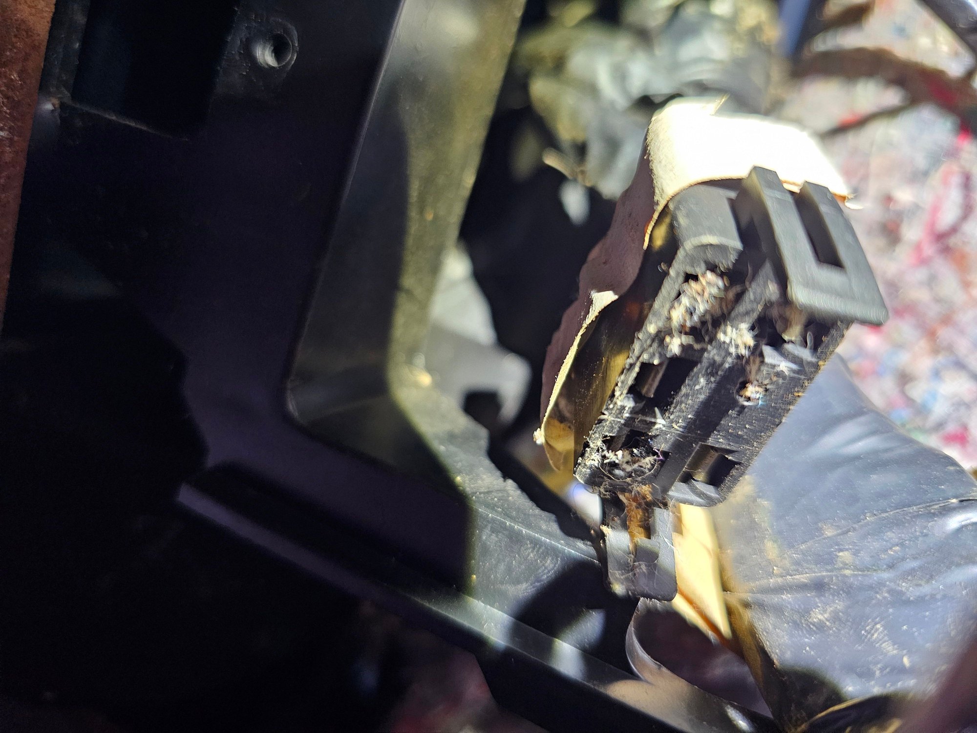

Also. Does anybody know what this circled in red plug might be? Looks like a purple, grey or tan and black wire. Up under dash near fuse block. Wasnt plugged into anything.
