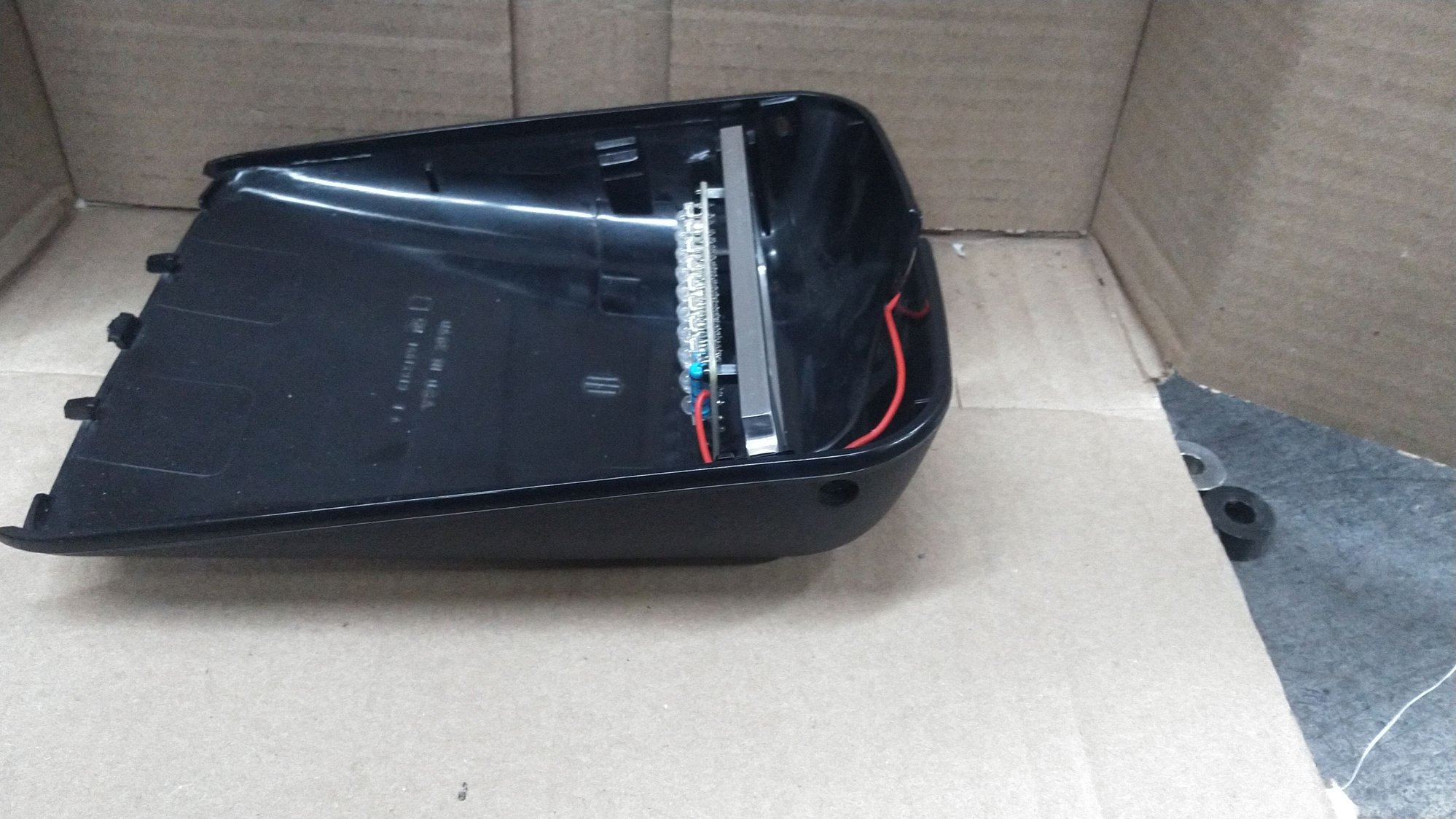

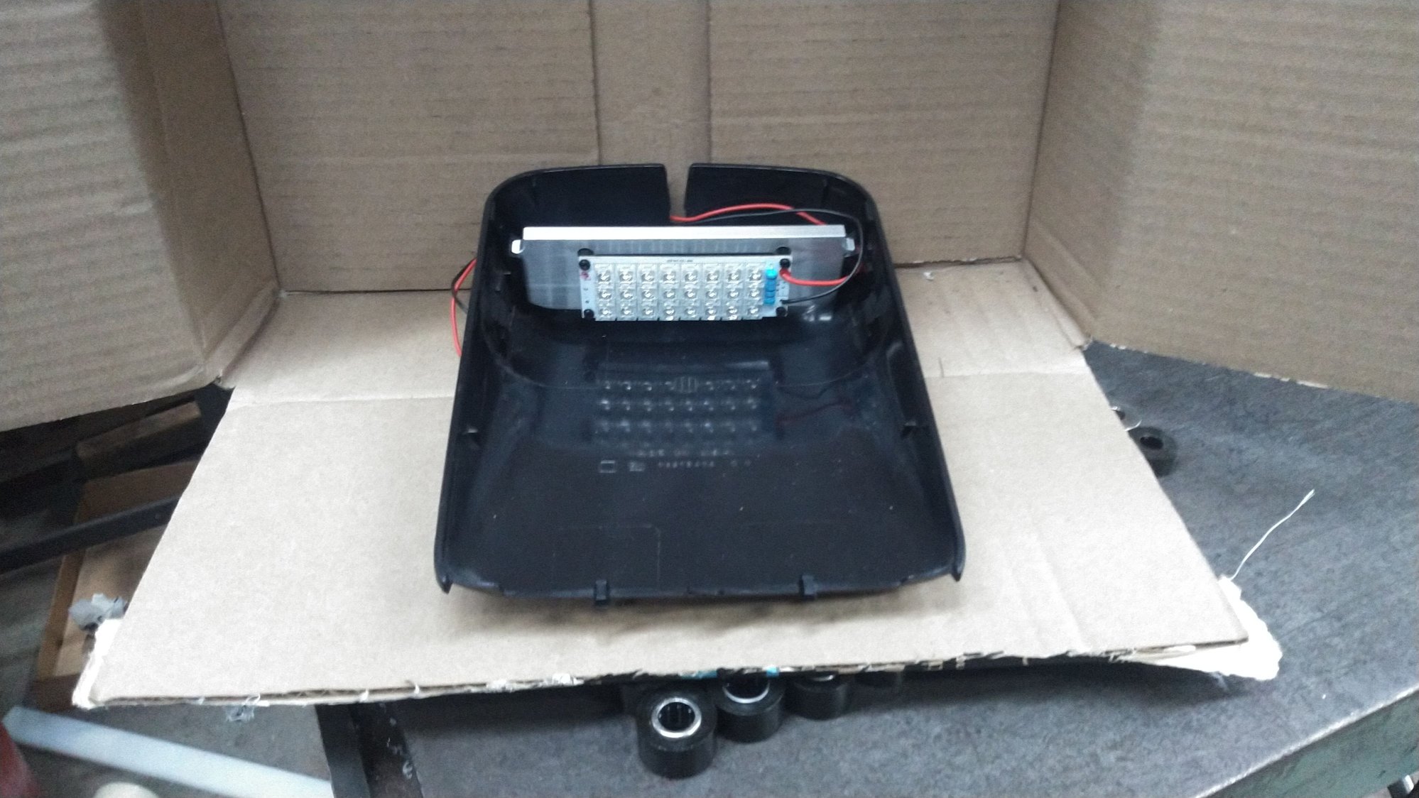

My refector/bulb mount was cracked and would not hold a bulb. When I tried to mess with it it totally shattered. My fix is a plastic plate holding a flat panel LED board. Made this one in aluminum. I made another in plastic with the board angled to be more vertical.
I could not find a reproduction reflector for sale anywhere.
This is all part of putting the car back on the road after being parked for 17 years.

Nice job. Any pics of it installed and lit up?

Working on that
