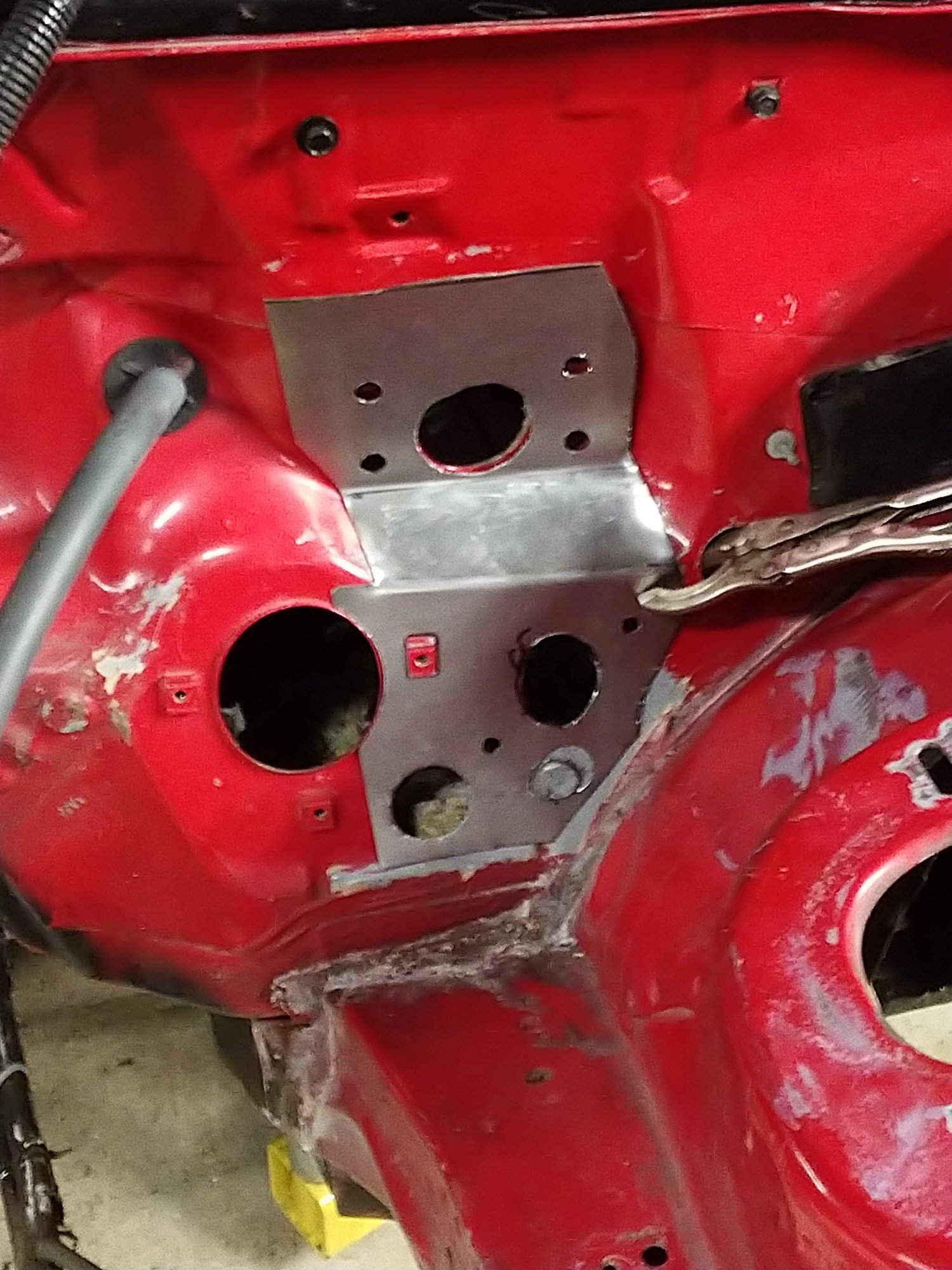

For my car I made one that covered that area. while I sure it helped it still flexes... I plan on making a "bumper" to go from the STB to lightly touch the nose of the master cyl.

It's really easy to get a piece of steel and just cut one out.
