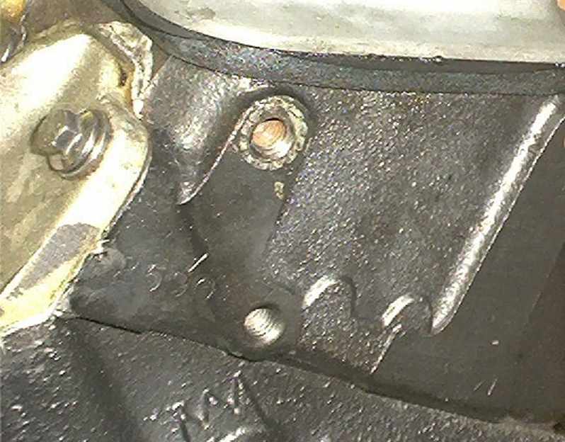

Here's a set of double-hump heads from the outside. Note that this set, unlike the 461 casting mentioned earlier, has accessory bolt holes, so they will actually install into one of these cars without any .... ummmm, alternate engineering schemes ..... required.

Old Nov 1, 2002 | 06:00 AM

And the other end...
Don't let anyone with old heads tell you differently, these are The Heads to have if you want a junkyard performance motor. There are none that are "almost as good". The version with bolt holes also has a modified combustion chamber compared to the older ones without the holes, so they will actually almost run on modern gasoline if matched correctly with the rest of the engine.
