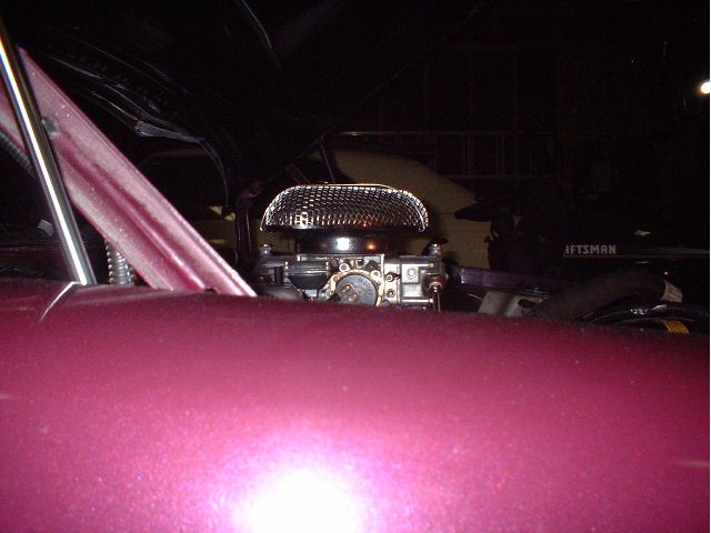

Here are some of the pics of clearance of my victor jr. and holley setup. And just a reminder that I do have a 2" spacer on there. But even without that you can see that it would be a real struggle to get it to fit. I know I couldn't.

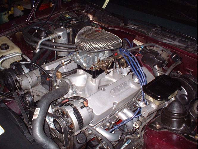

Here's another.

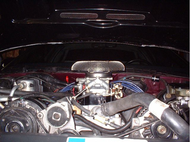

Here's one of my hood.

Nice pics! So with out the spacer, you still think you would have had problems? That sucks, because I want to keep my stock hood, you know like a sleeper look... he he, maybe catch me a mustang and wip his little a-s-s! LOL...

Even without it I wasn't able to use the stock hood or I would have because I am on a fairly tight budget. I tried to use the stock hood without the spacer and a aircleaner and the stock hood when laid on the car sat right on top of the carb. There was just no way I could get it to work.

I've heard bad things about that filter from reading this board, just a heads up

You've heard bad things about a normal foam element filter. Like what? I know if you back fire through your carb it will melt it or blow a hole in it. But thats why you time your car with it off. Just wondering what could actaully be bad.
Old Nov 1, 2002 | 09:09 AM
bluegrassz's Avatar
Posts: 3,449
From: LONDON, KY
Car: Camaro
Engine: Carbed L98
Transmission: TH350
Yeah, I have heard of those triangle filters getting the foam sucked right out into the carb. Sometimes pieces get into the motor. This is just what I have been told by some people that have used them. Nice motor though
Old Nov 1, 2002 | 09:57 AM
2laneblacktop's Avatar
Posts: 115
From: Indiana
Yeah I can see that....I haven't had any problems yet and it flows really well. Anyway, I thought i would add one more pic on so you can see the whole engine instead of just the top....i'm pretty proud of it and to say I built it myself. It runs good too.

hehe
this post is about my car lol:rockon:

Sweet setup man! Hows that Tremec workin out for ya? I want one of those real bad.

383backinblack I have a few questions for ya. Maybe you could e-mail me this information, since your car is set up so darn close to what I am doing. First off I LOVE YOUR RIDE... NICE
1) How is that T5 holding up to all that power? That just blows my mind thinking about that set up with a 3rd gen 5 speed.
2) Without an air cleaner, could you have cleared your motor with the stock hood (just leaving the carb bare)?
3) What brand hood is that 4"?

also, to answer gofaster,
1)its not a t5 it s atremec TKO, and its awesome:rockon:
2)The carb may have barely cleared without an air cleaner with a stock hood, but by so little it would be a scary thing to do. The cleaner is off in pics cause it looks cooler, the cleaner (4"k&n) is always on for the street.
3)the hood is a harwood outlaw which is called a 4" but is actually closer to 4.75"
4)power steering pump is stock with a march pully (press on), Alternator pulley is a summit billet pulley, crank and water pump are also summit billet alum. it has a short water pump. The alternator bracket we custome fabricated to work on the passenger side of the motor. (that sucked) im gonna get a sweet bracket set up with heim joints and stuff when i have the cash.
5)It has a single stock fan (which is better than the dual setup) which is wired to be on whenever the key is on (no switch)
6)no i dont, i wish i did people have been asking for them. However, i did explain to someone on here about it and i will find that post and post it here for you guys.
7)the powertrax locker is badass i think it costs 400 bucks(i bought the rear end all together as a unit) its a little harsh at time and is a bit quirky, but it is pretty invincible. i snapped an axle splined end off inside the locker, and i hammered the piece out to find the locker was unharmed. at times it can click, or lock up suddenly making a horrific noise (its all explained in the manual and is normal) but it takes some getting used to. IT can cause the car to buck at low, low speed when turning hard (like into a parking space) but it will never wear out. i like it.
8) if cars are running 10's on a 10 bolt especially without a girdle cover, i doubt its really a 10 bolt....it is worth the money, looks slick, and its easy to work with. provides quite a bit of support
