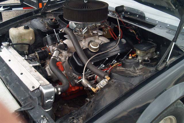

eh i dunno about that bein the nicest engine bay i ever seen tho.. dont like the way he ran that fuel line for the pressure gauge all the way across the engine 2 the opposite fender when he could just put it on the same side as the fuel line on the carb.. the big block looks cool as hell tho hehe
