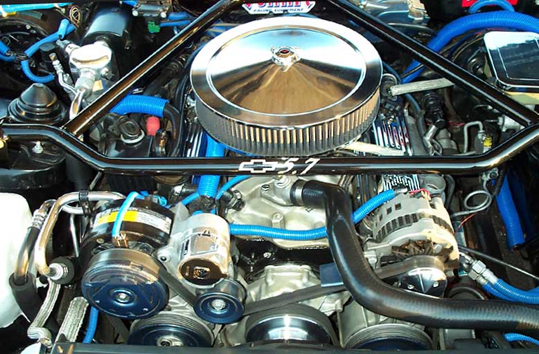

here's an engine pic:
so do you not have a guess at the hp/torque of it?
Posts: 18,457
Likes: 16
From: Loveland, OH, US
Car: 4
Engine: 6
Transmission: 5
First, screw the "from a Corvette" crap. Don't fall for the oldest sucker bait line in hot-rodding (well, maybe not the oldest, since the Vette has only been around for just under 50 years now, and has only been a contenda for the last 48 of them). Since you copied and pasted all that from somebody's sales pitch, it tells me that the seller is trying to take advantage of what he perceives as an inexperienced novice by using the "from a Vette" this and "SLP" that method of putting stars in your eyes and making you think that somehow it's automatically .... attractive to the opposite sex or something, like maybe it will cure bad breath or shower you with instant self-confidence and pheremones, I don't know what.
Now that we've gotten past the buzzwords, let's get to the facts. Exactly what heads are on it, what has been done to them, and exactly what cam is in it? Part numbers please. Casting numbers for the heads, and a cam grind number or part number or lift & duration specs, not "from a Vette" foolishness. No vague "fully ported and polished" or "¾ race cam" type of evasion. Without real facts, nobody, including yourself, is going to be able to do anything more than make a blind guess.
edit: the pic appeared as I was typing this. I can tell nothing useful whatsoever about it from the pic. It looks like a small block Chevy. It could be a 305 with 882 heads and dished pistons and a LG4 "peanut" cam for all I can tell.

Posts: 18,457
Likes: 16
Car: 4
Engine: 6
Transmission: 5
If it is the absolutely stock L98 long block with the right heads and cam, it shouldn't make a whole lot of difference whether the induction is TBI or TPI, the HP should be about the same. It might make a little more HP with TBI but noticeably lower peak torque than the TPI, but overall it shouldn't be too radically different. I'd expect somewhere around 250 HP in that case.
It would take a great deal of convincing before I would ever believe the "from a Vette" line, without proof (CASTING NUMBERS!!!). I don't know how old you are or how long you've been doing this sort of thing; but if I had a dollar right now for ever time over my career that some shyster had tried to sell me s*** on a stick as platinum-plated gold "from a Vette", and for every time I've seen people get ripped blind paying Hemmings Motor News prices for 350 2-barrel crap straight out of the junkyard, I'd be able to retire on it right now.

Posts: 9,067
From: Saskatoon, SK, Canada
Engine: 454ci, 6.1 Hemi
Transmission: TH350, A5
Can't be that hot of an engine if it doesn't even have a good set of headers, and all I see is stock cast iron beside those heads!!!
I give it 270hp tops. But, as said above, we'd need to know what parts are on it before we can help you figure out what she's putting out.
I give it 270hp tops. But, as said above, we'd need to know what parts are on it before we can help you figure out what she's putting out. My original opinion still stands. That engine is crap if it was rebulit by Recon (AutoZone junk) and 305 heads on 350??? if it is one. Still BS, I still think if it originally from Recon its a 305 TBI.
I also like the comment about the Vette Block again, Recon uses any junk block they can get.
