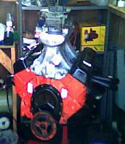

I will see if I can dig up the dyno sheet (the engine was assembled a couple years ago). Off the top of my head, peak horse came in at about 7200 rpm, but didn't fall off sharply until around 7900 rpm. Torque was never a thought of mine when I built it but I think it was a tad over 300 ft. lbs at just over 5000 rpm.
I am going to put the car on the chassis dyno when I complete it, that's where the power counts anyway (at the rear wheels).
I built the internals to withstand 9000 rpm safely. I love the sound of a screaming 327!!
Here is a pic of it on the stand, I hadn't received the new balancer or carb yet, so those are just old items set on there to seal the engine up.

What are the heads ? nice looking motor. I built a 327 myself. but the best I got was 394hp around 6000 rpm and394 hp at 5000 rpm..at the flywheel and dd2000 guestimate...so Im sure a little less
The 406 goes in this weekend The builder claims 525hp we will see. This one will go on the dyno in real life.

The heads started life as Casting #3927186 1969-302/350
64 cc Camel Hump/accessory holes
but I have extensively modified them to flow like mad. I have an engineering background and computer modeling software that lets me design before grind.
Your 406 should be easily capable of pushing that kind of horsepower if built correctly, and at a lower rpm. A buddy of mine was running low 9's with one in his Monte Carlo and he was shifting between 5000 and 5500 rpm's.\
I am curious what this engine will do in my '85 Firebird. I had it in a S10 and pulled a best of 9.89. The 'Bird is heavier though...we'll see.
