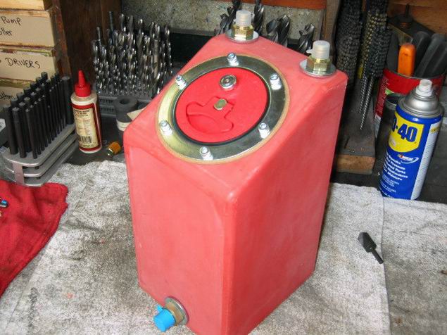

I am doing this same thing. I actually just got my fuel cell today. I will be using a 1 gallon cell with a holley blue pump and return style regulator strictly for the nitrous system. Here is a pic of the cell. I will be installing this soon. I'll take more pictures when it's done.

well I went out and did some more work. My car is about 30mi away. There is now way I will get the 4 gal, cell in there without a lot of Modding. My cell has the to nipples at the bottom and one at the top. just the reverse of yours
The slope of the cell is just perfect for the slope in the luggage compartment. SUM-290110 Here is a pic. so I guess I will be running the hardlines up the passenger side. The stock lines are still running up the drivers side.(this was a v-6 car) I think i may just be able to move them over and use them again .
The instructions with the pump say to run a 2 filter system off the cell into one line out the regulator. Is this necessary or could I just run one line all the way up. Im Running a 800 holly mech secondaries. everything has been ported and polished professionally by" Racing Head Services" even the top of the intake has been ported and the center deal has been cut down. I'm not real sure I will be needing any return line at all.
Any opinions on this. Ive got a ton of money in this project now and things are beginning to get tight. althought I have a malory 3 port already from my first swap

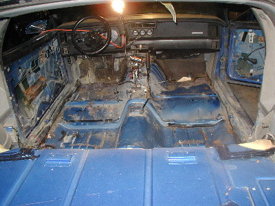

and my new interior
Old Apr 9, 2004 | 06:29 PM
Riley's35089rs+'s Avatar
Joined: Nov 2001
Posts: 2,743
From: heartland
Car: 89rs (previous 2.8)
Engine: 406
Transmission: 700r4 (for now)
oops
sorry
