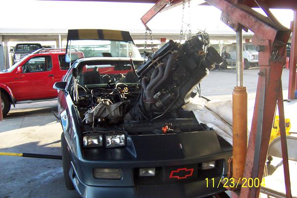

Here is my pull with slp headers and tranny:
Attached Thumbnails Anyone ever pulled their motor w/headers still attached?-c-documents-settings-owner

Cool!!! I figured it was possible, but that one passenger side header had to be installed underneath the car so I wasent sure about a pull. I DO have a load leveler and the tranny will be comming out and back in with the motor.
So what about the motor going back in? Headers came out with them, so it should go back in?
