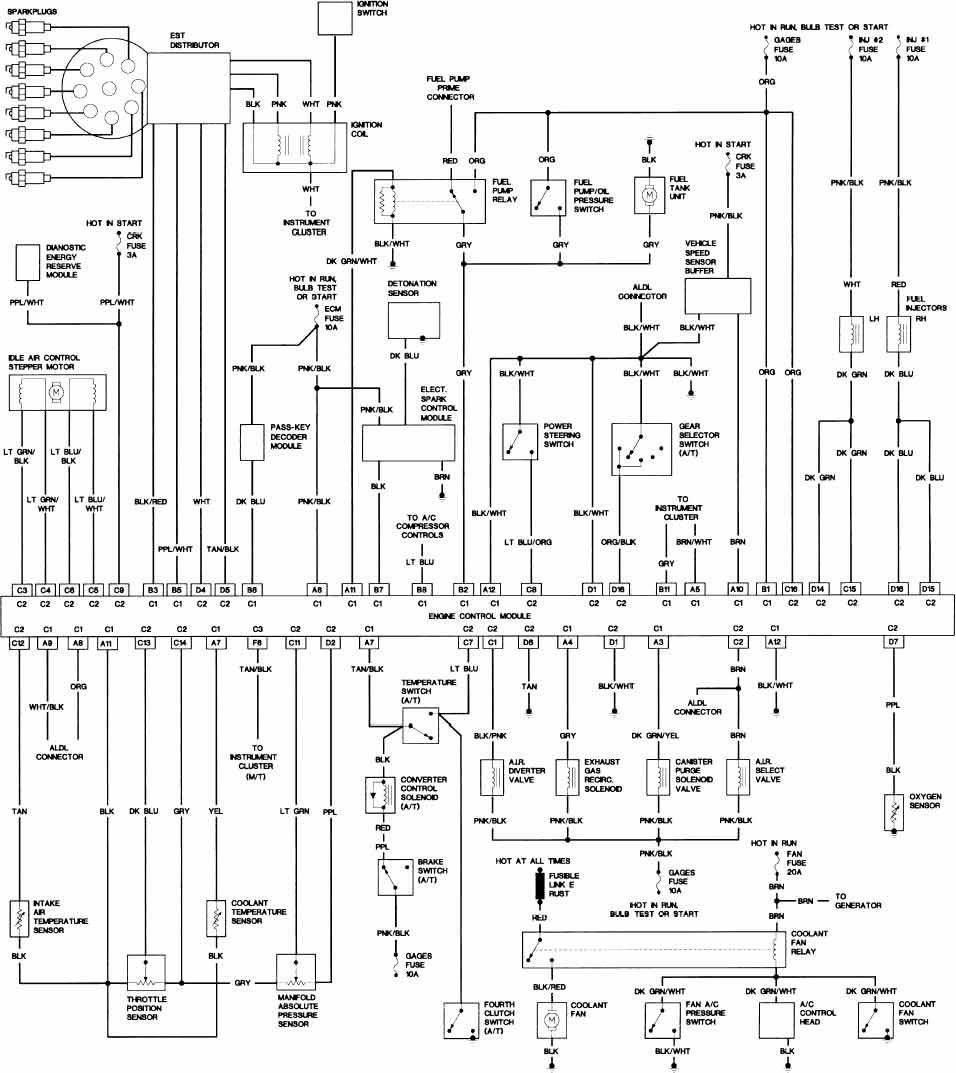

does anyone have the wiring for under the hood for a 92 camaro. looking for the engine light and and some other wires that are by the brake booster. also does anyone know were the vats control module is on a 92 camaro?

oh yeah also does anyone know were the fuel pump relay is on a thirdgen car? I need to conect the wire from the new harness to it. and also the vats module i was told by the 350lt1.com guy that i can use the factory vats i just have to hook up the blue vats wire to the factory vats box. can anyone help?

Here ya go bro.
Attached Thumbnails 92 camaro wiring-c-documents-settings-matt

And the fuel pump relay is in the very corner next to the brake booster on the driver side. It is held on upside down by 2 or 3 bolts.

that is too cool thanks alot. does anyone have the same kind of wiring diagram for the 95 camaro? i like this diagram. thanks sean
and also the tranny wiring for the 95 camaro?

looking through the diagrams anw wirung graghs does anyone know what color the 4th gear clutch switch wire is. im looking and cant find it?
Engine controls for the '95
http://www.e-toolbox.com/ads/wiring/va098095.pdf
http://www.e-toolbox.com/ads/wiring/va098097.pdf
http://www.e-toolbox.com/ads/wiring/va098098.pdf
The transmission wiring is included in the third link.

thanks for the reply this will help me out alot now i can get the few wires that i have left hooked up
