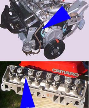

Engine ID
stope21,
There should be a number on the BLOCK just in front of the Passenger Side Cylinder Head, Right behind the Alternator. It might be a little tough to find. You'll also may need to scrape away some grease or paint to see it clearly. Write down that number and dial up the following:
http://www.mortec.com/castnum.htm
You should have no problem finding your number and determining what the block was when it started it's life at the GM Factory.
You should check the head casting numbers as well and post them when you get them. They can only be found by removing the valve covers and reading the number. CHECK THEM BOTH! They should be the same.
The other guys know a lot more about heads so one of them will have to help you figure out what you have there.
Hope that helps....

Old Aug 7, 2005 | 10:24 PM
stope21's Avatar
Joined: Jul 2004
Posts: 48
damn, I tried I looking back there to no success Any suggestions on how I can take a peak ? Thanks alot for the very nice diagrams.

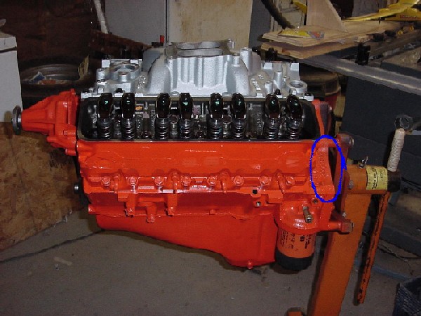

vrtc350's Avatar
Joined: Feb 2005
Posts: 471
From: Frankfort, KY
Car: 81 Corvette
Engine: 355, ported vortec heads
What is circled is where you need to look. Check both sides, I believe there are numbers on the other side as well.
Old Aug 8, 2005 | 01:02 PM
stope21's Avatar
Joined: Jul 2004
Posts: 48
Ahh cool, even better pic . I can even see the numbers on it, i think this will work.
