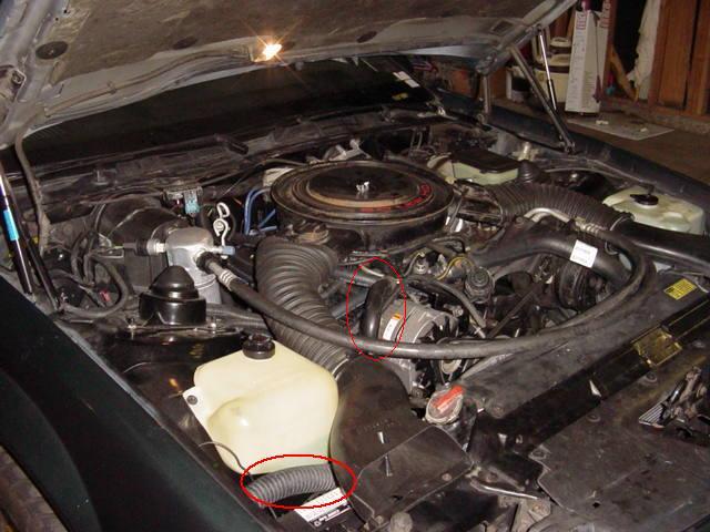

Not really. The blower itself is over by the battery inside the fender. Pic shows the hose that goes from the blower to the engine and plastic tube that goes up to the carb.

Originally posted by five7kid
84's didn't have electric fuel pumps.
LG4's didn't but L69's should have?

What you are describing is the air injection pump and tubing, it vents air to the air cleaner when not pumping it to the exhaust manifolds or the cat converter.

No, it isn't. It's an electric blower to cool the carb, P/N 14094394, mounted over by the battery inside the fender, as recommended in service bulletin 86-34, revised in 87-131. The A.I.R. pump is belt driven and mounted on the engine.
