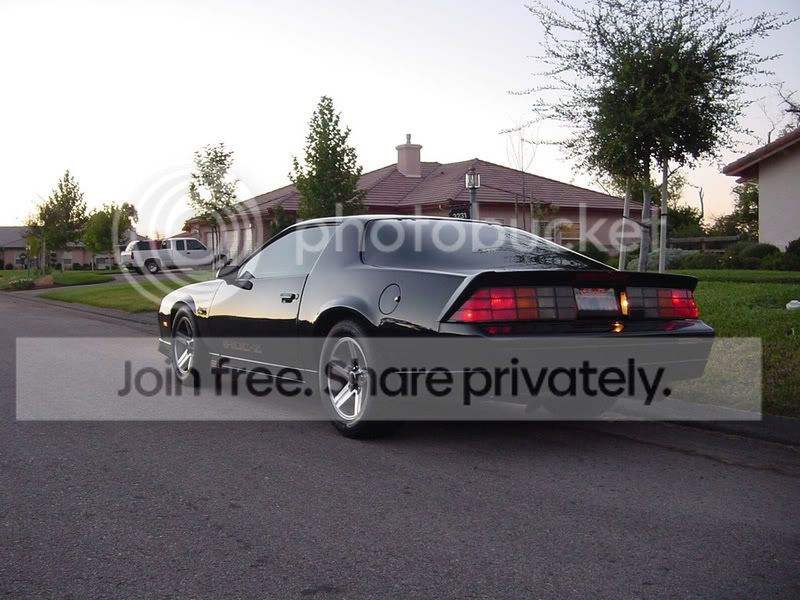

Hey all, me and my buddy Todd have begun tearing out my perfectly good 305 in order to drop in a hot little 350. This is the first engine swap on a late model car for both of us, so everything is a new experience.
Once the 305 is out, I plan to clean up the engine bay by painting old brackets and whatever else I can think of. It is my only car so I have until late August to have it running - In time for me to get back to college.
I have already done up most of the suspension on the car, so after this I will have pretty much gone through everything. A T56 swap will come next, after the new 350 is running smoothly.
I'm putting this up to post pictures of the work as well as a spot to ask questions if we get screwed/stuck.
The Car:

The Car:

Clean lookin' Z you've got there.
