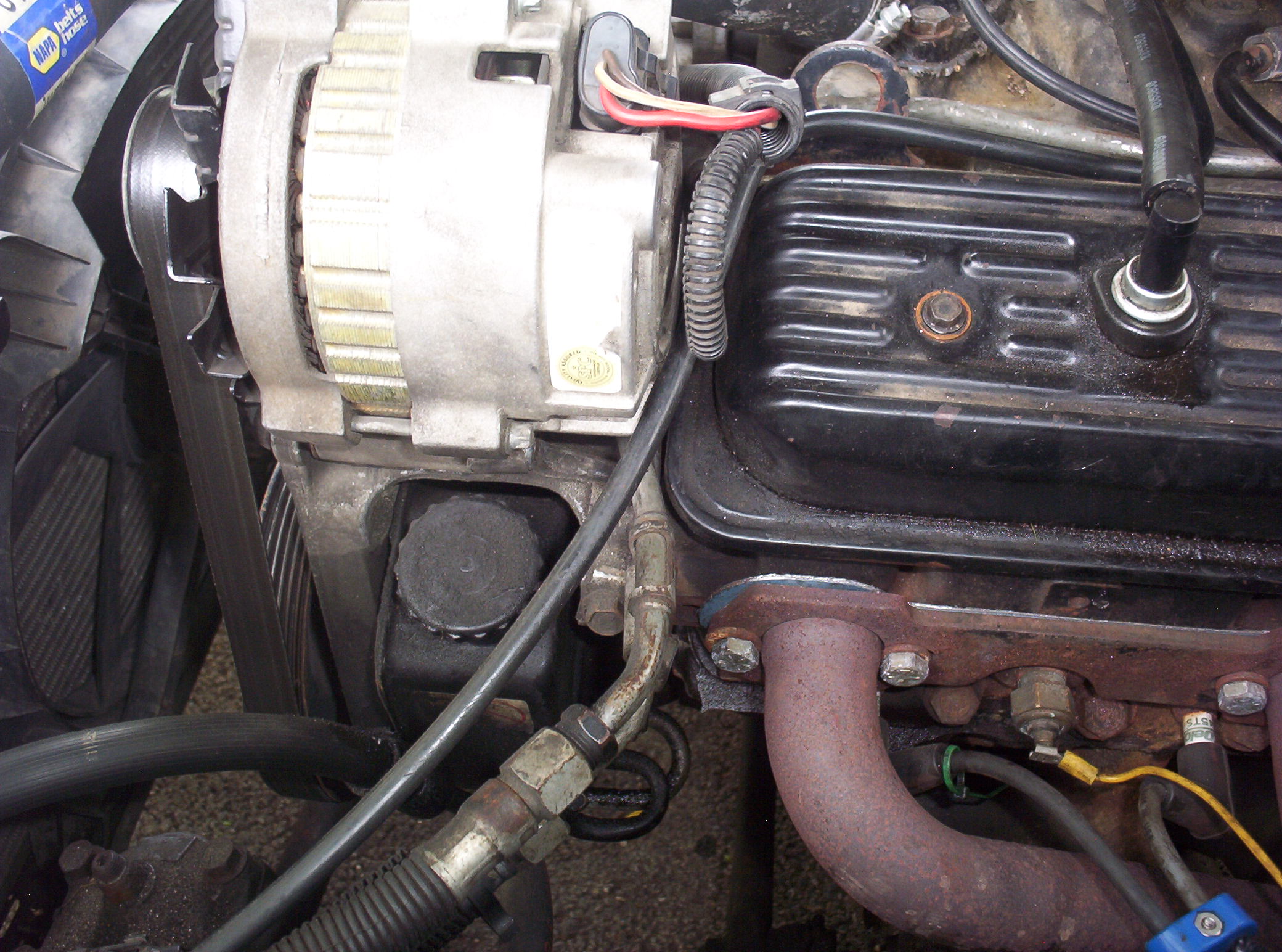

You mean the factory Gm part? My concern is the bracket that goes on the driver side bolts in to something on the head that i dont think i have.

Re: Bracket Problem, Need advise
The gm factory one is what I was referring to. Heres what mine looks like. I think the GM factory one piece all you need. I didn't see any other brackets.
Thanks for taking the time to take those pics. Im not sure if that would work for my setup or not because im just gonna run an alternator, power steering and water pump. I orded this part today, it says it will fit. http://www2.partstrain.com/store/?D=...982+9891&Nty=1
