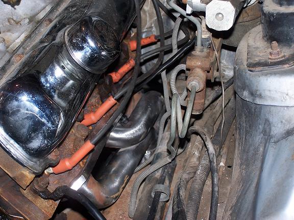

thay are 1 7/8 x 3"
Attached Thumbnails olds swap-car-4.jpg   olds swap-car-3.jpg   olds swap-car-2.jpg

Who made those?

sanderson they are for steet rod sbo. i didnt know if they would fit. they went in with the engine in place.

Wow! That nice of a fit?
Sanderson... Do they have a website or link? Where did you purchase them?

Here you go, http://www.sandersonheaders.com/

yah right in. but i did have the heater box out on the pass side. the drivers side had to come up from the bottom. also the starter was not hung at time of install.
