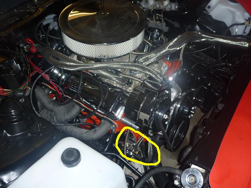

this is my reg and were located it.....and i did not use the return line...do i have too?
Attached Thumbnails fuel pump problem-3.jpg   fuel pump problem-1.jpg   fuel pump problem-2.jpg
Old Feb 15, 2010 | 09:38 AM
SeanW's Avatar
Joined: Nov 2009
Posts: 170
Re: fuel pump problem
You can't use a return line with a dead head style regulator. Hence the term "dead head" not to be confused with a regulator that follows around the Grateful Dead. That summit pump has and internal relief valve and so it doesn't require a return line. Your set up is fine. Just noisy, like mine.
