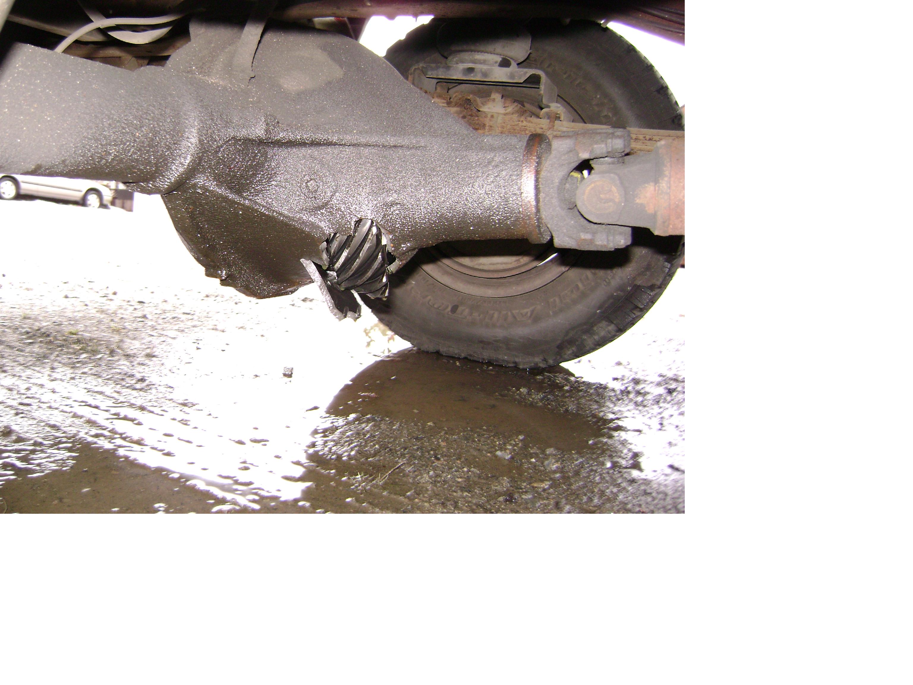

Don't make the mistake I did.
I installed a 355HP motor in front of a rebuilt TH350 and thought my old 12Bolt would be OK. I beat on it for a few years and stuffed the pinion gear through the bottom of the carrier.
Don't put off upgrading your rear end and rebuilding the stock 700.

I just fixed the Pic in my previous post
Have a look
Attachment 194882
12-bolt???

Originally Posted by five7kid
12-bolt???
Yes 12-Bolt.
You'll see I'm still driving my Truck
