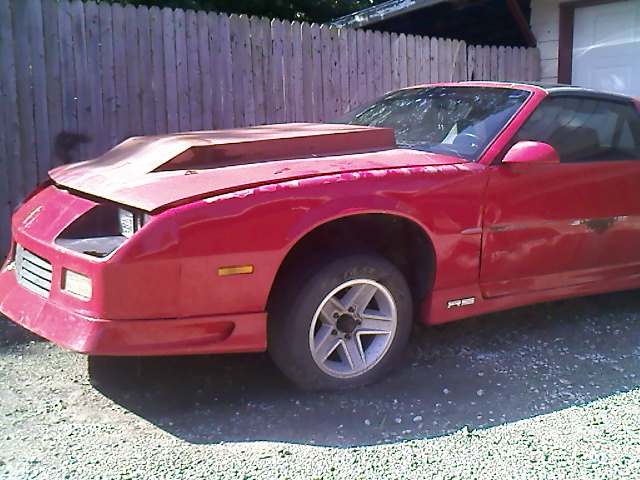

now i got my tach in, we pulled the windshield out lastnight, it was cracked and we just went ahead so it will be done before we paint it. here' pics of the tach

oh yeah, i forgot to add pictures of the other donor car i bought last weekend, prepar you eyes! haha
now i know it's "to each their own" but this takes it to another level! haha homemade cowl hood! look's like it should be on a modified race car!
i only got the car for the nose cone and all the ground effects!
