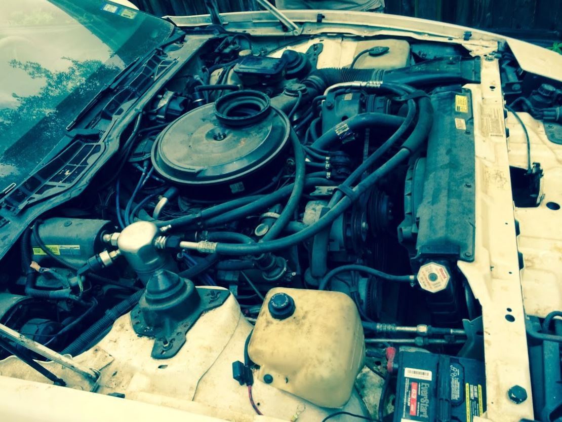

I was looking back at this old thread of mine, and I have to laugh. I was so naive and worried about dropping the fuel tank. I ended up doing the LS swap. It took me 4 years to accomplish, and I paid an installer to do the tough stuff (I obviously took some breaks from the project). I got to know that fuel tank real well. I read through countless threads to find solutions to integration problems. There were a lot of them! I know now what I didn't know then. Either keep the original air/fuel/emission system, or be prepared to work with the fuel pump, ecm, and ignition. I almost went with a 350 crate engine. If I had gone that route, I would still replace the quadrajet with a quick fuel carb or efi. I like the cleaner engine bay. For those still around, thanks for patiently answer my questions.
Before:
After:

Re: what to get with gm performance crate engine
Originally Posted by johnw999
Hard to believe, but somewhere under all this mess is a SB Chevy.
And this is why people choose to delete the SMOG system. Thanks, treehuggers! It's not like our cars even have that big of an impact on the environment anyway!
