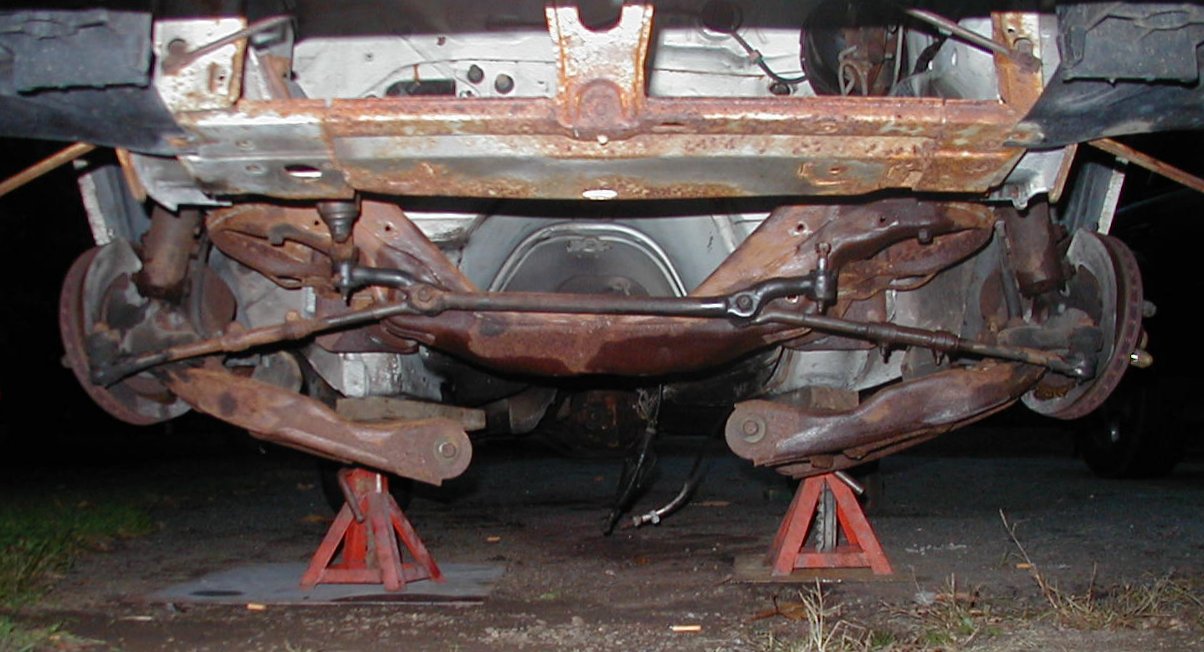

im gearing up to drop my 350 in, and im trying to remove the mounts without removing the a arms or springs, is this possible or any tips tricks?

Bottom mounting bolt/nut can be removed with a ratchet, short socket and swivel. The 2 upper nuts can be removed by holding them in place with a 15mm wrench and turning the ratchet from the other side.
Getting them off isn't easy - but mounting them is even worse.
I had to replace the motor mounts in my 85Z when I found out I had a bad one after pulling the motor last week. Even with the engine already out,...... I STILL decided to drop the control arms JUST to make installing the new motor mounts easier.
If you don't drop the control arms be sure that you use flared nuts - like the factory used - inside the X mebmber. They will be easier to hold in place on the 15mm wrench than non-flared nuts when working inside the X member !
P.S. Also a good idea to have a magnetic pick-up tool handy to recover the nuts that you drop inside the X-member !

i changed the engine mounts by myself with the engine on... Get a cherry picker to make life easier. Its 3 bolts on each engine mount. one bolt u need an extension that gives u angle on the socket; the other two bolts, u need a wrench going thru a whole on the k-member.
No needs to drop the control arms just to change the engine mounts

go under the car and take a look at ur k-member. I used the following tools: 2 ratchets, long and short 15mm sockets, extension, swivel and 15mm wrench. For top use the ratchet with the long socket. On bottom: one nut, u can remove with the short socket swivel and ratchet. the other two nuts, you can use the 15mm wrench. u have to insert the wrench in a hole that it is located in between the lower control arm bushings.
