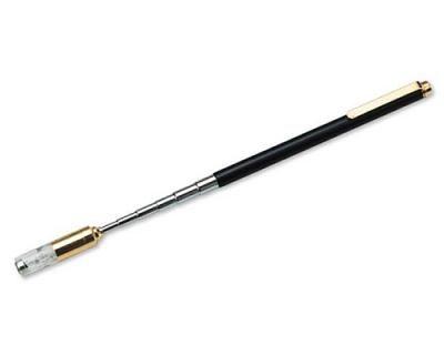

Oh wow. Just kidding. Do you have one of those extendable magnetic parts retriever? That and a flashlight.
Good luck!

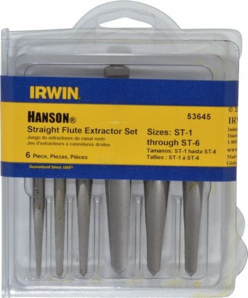

these

Thanks I should of thought of that earlier, but the hole has the end of the sensor is broken so i need to remove that before i can fit something like that in there. Do you know of a way to remove that?

At the auto parts store, they work great!

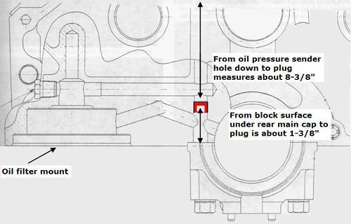

See the diagram below.
Your drill bit is sitting about 8~ inches in a vertical position. Get a magnet tool and pull it up out!
THANK YOU I Appreciate the help I'm going to get that bolt extractor later today or tomorrow.
