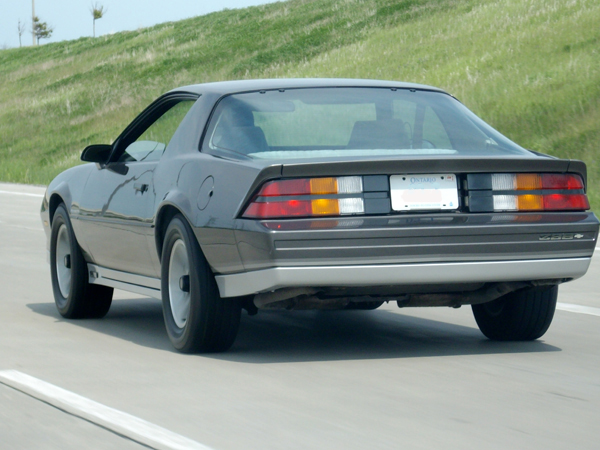

350 290hp to replace old LG4 -> advice please
My 32 year old LG4 owes me no more. I am considering replacing it with the GM crate 350 290hp engine. I have been advised to not use the intake and Q-Jet carb from my LG4. Does anyone know how this might work or not work? Thanks, Gary.
