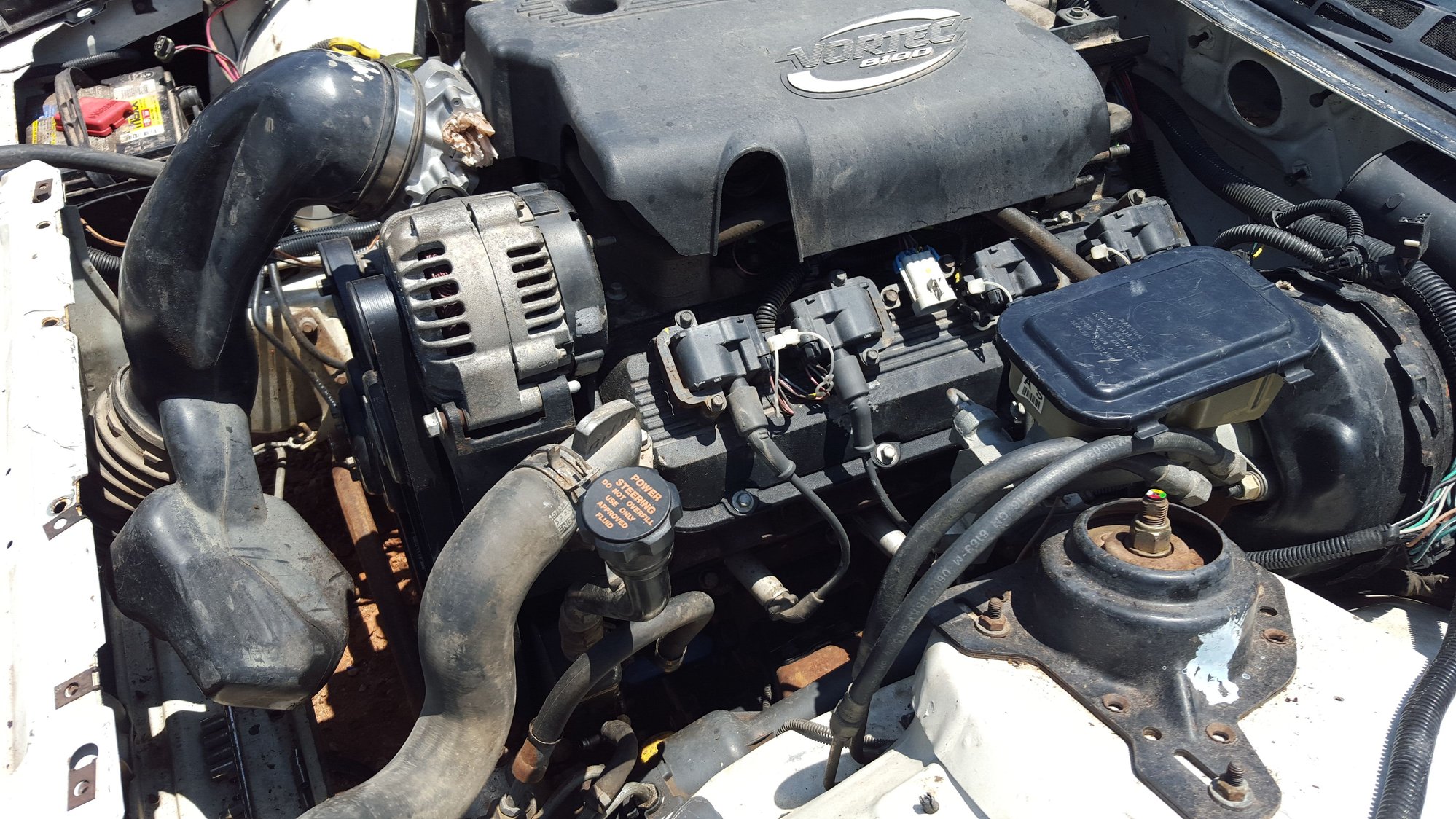

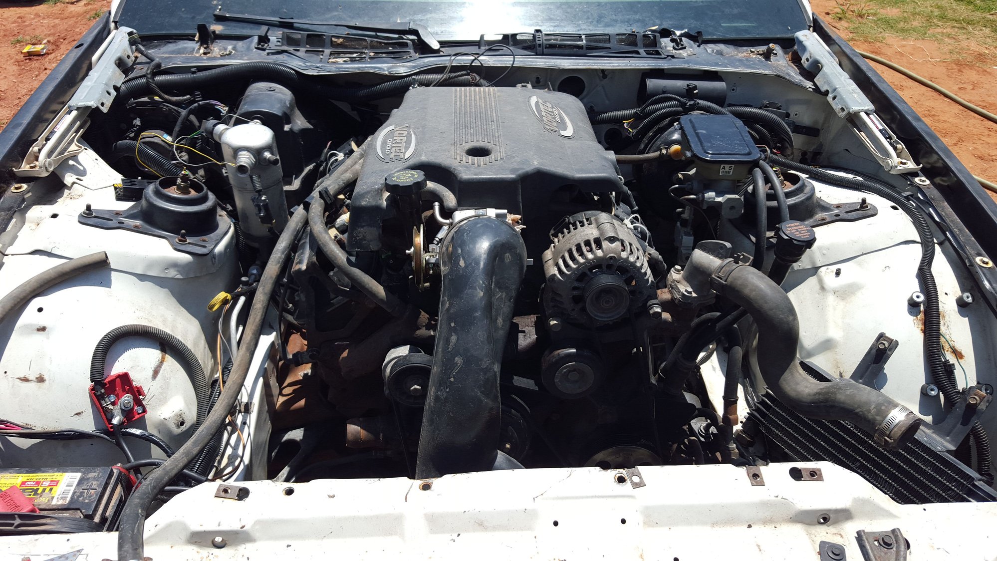

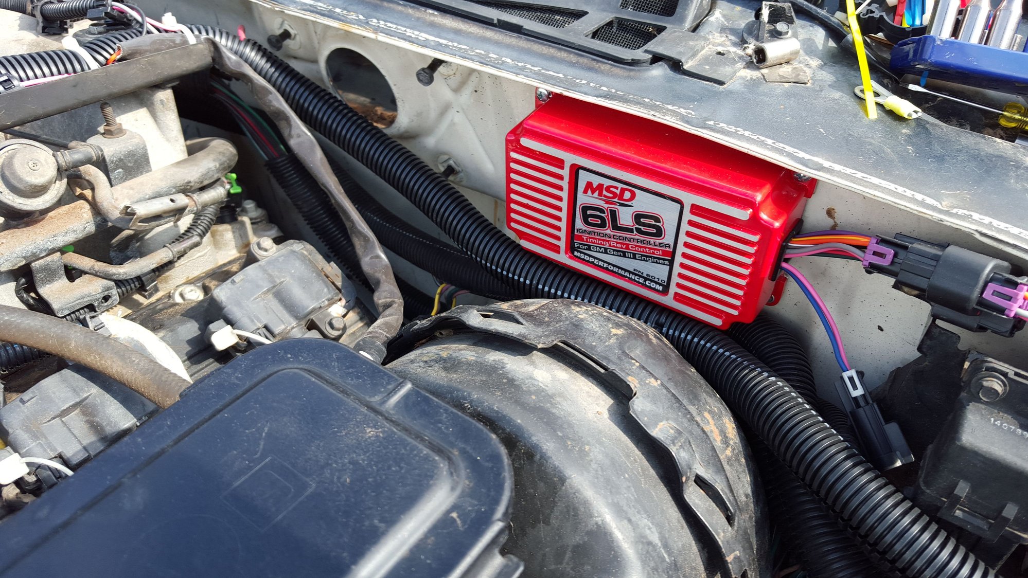

Some progress on my 8.1 the alt will need to be moved to the passenger side runing msd 6ls and a microsquirt

cj599 thats a tight fit ha, itll make one hell of a sleeper for being a budget build, have you done any top end work or is it stock? can you build to much power with that low of RPM plus the limited amount of bolt ons for it? and yeah i just got a GED and have been thinking of some basic gen ed college myself, since i program cars for a living and usually can make my schedule flex since its my dads company, although my boss is kind of a ***** hah.

Check out raylar they make heads aswell as dart they also make cams rods etc, this is stock or now its a prequels for the 489 since ill be using the same headers efi and ignition on the 489 but the 8.1l can be a beast i would go with the 6.0 or 5.3 unless you have deep pockets like i dont
