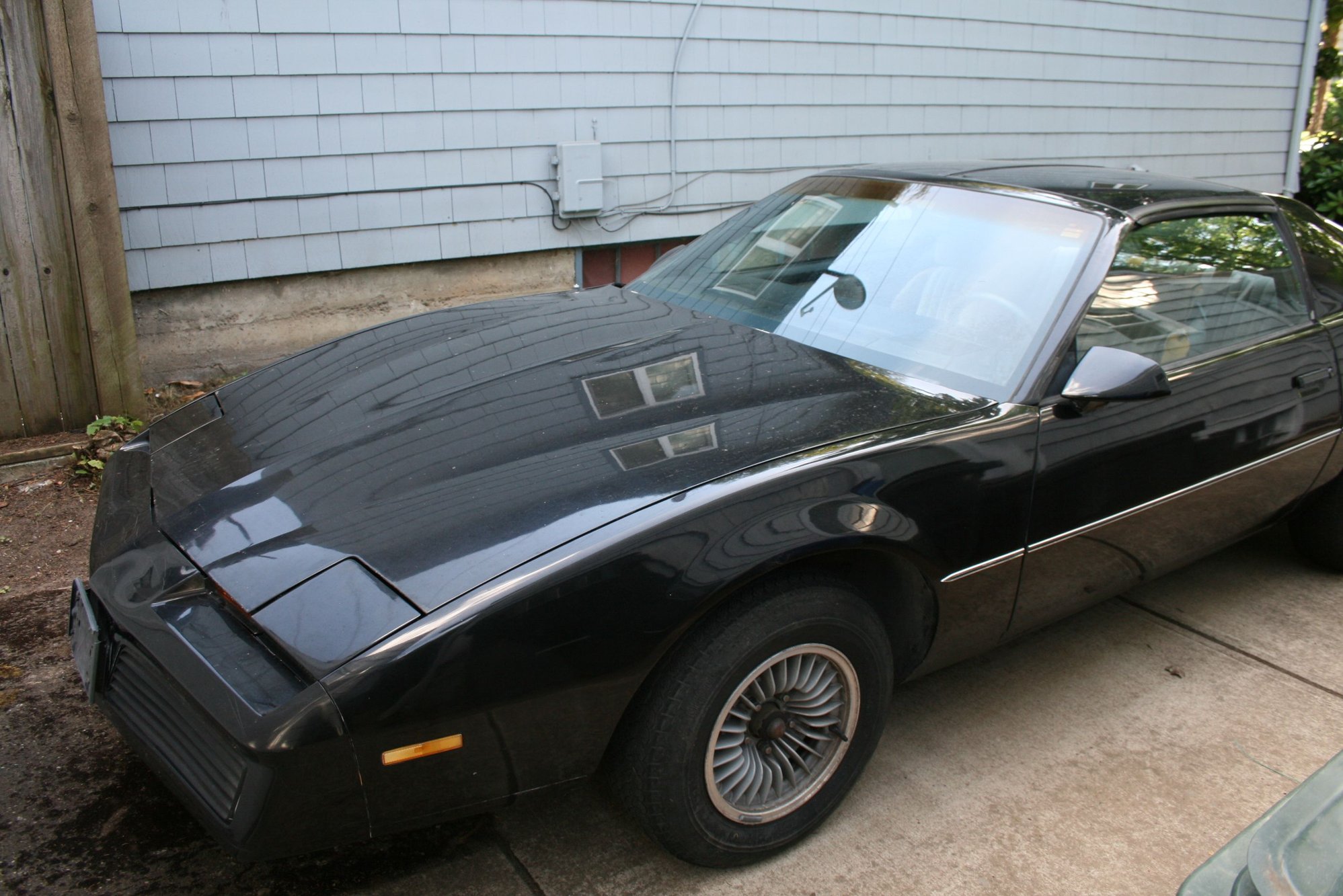

Bought an 1983 Pontiac Firebird S/E and going to be fixing it up.
First thing was to pull the original 305 small block Chevy engine w/ trany.
Next is to buy a rebuilt Gen 2 461 Pontiac Engine
Going to need to do some conversions to get it to fit. Anyone have advise on a set of front springs to hold the new weight to keep the car straight?

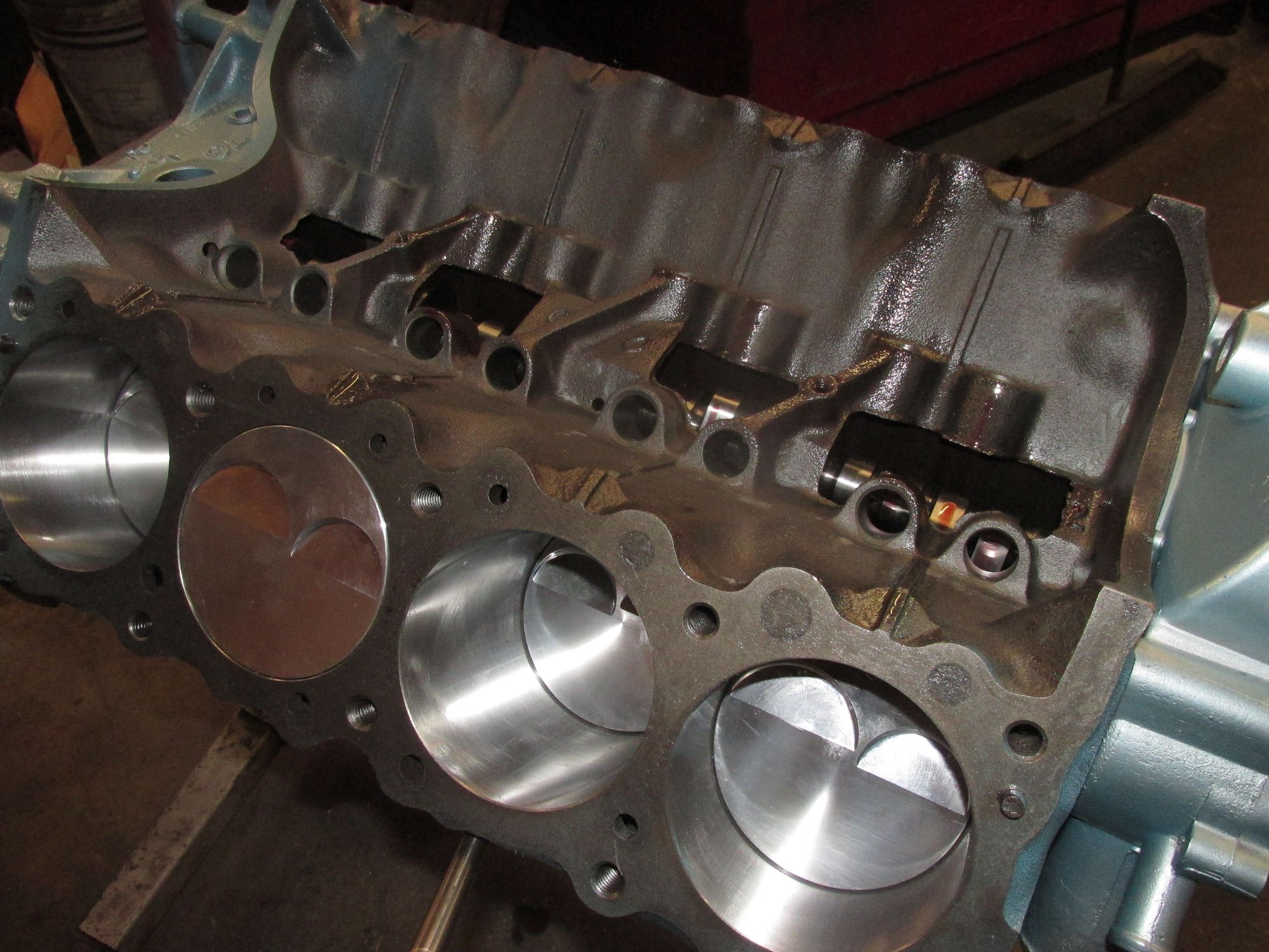

Quick question for you experts. Can you tell by these photos that the heads were baked in a thermal cleaner and blasted with stainless steel shot?
I was told by one person that they were, and told by another that they definitely were not. So, I have conflicting opinions. Thoughts?

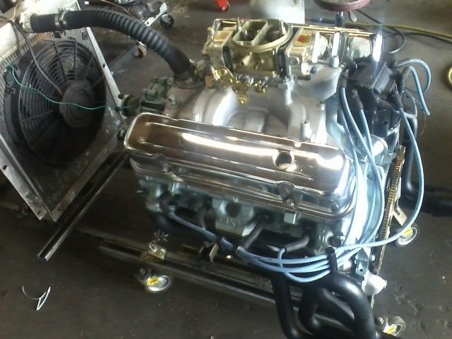

Started the Engine on the Run stand. Ran into an issue.
After about 10 minutes, boiling water started up come up out of the top void on the center of the right head. My mechanic said the first time they ran it the top hose blew off. Really disappointing as I was hoping for a uneventful run. They think that a gasket may be blown. I contacted the builder about this and he thinks it may be a cracked head. Either way, it's going to have to be pulled apart to figure out what's going on.

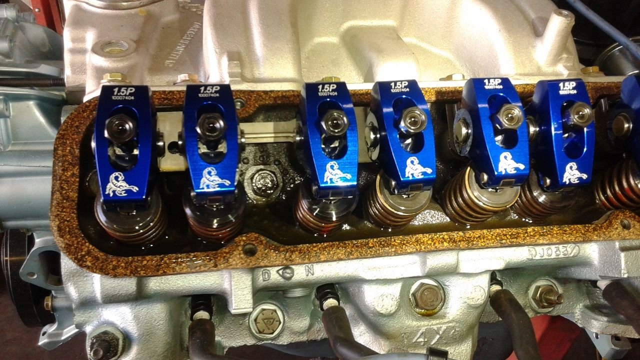

Scorpion Rockers
