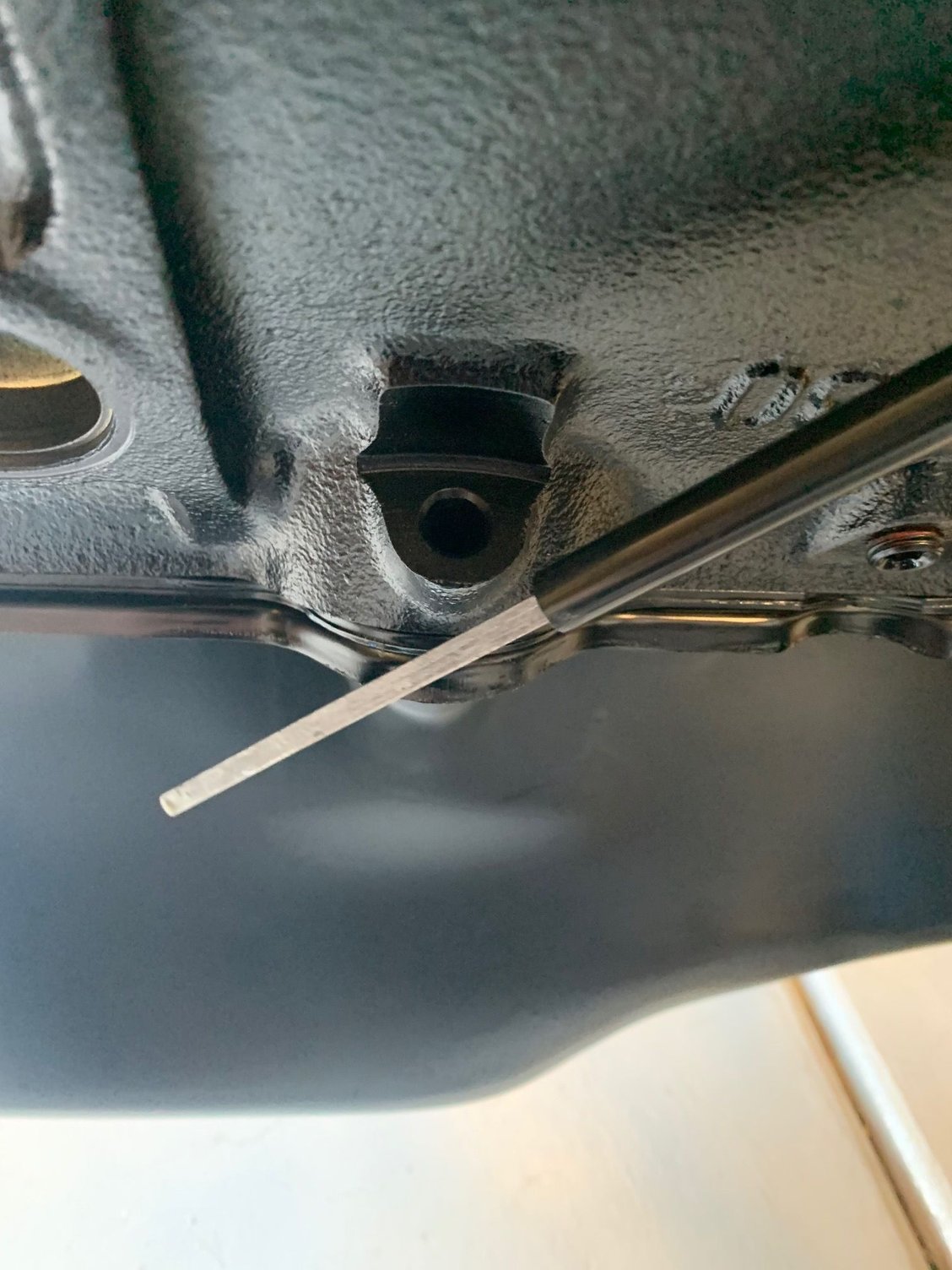

I've got a couple questions. I'm putting a crate 350 in my 1989 RS. First what type of gasket goes between the passenger exhaust manifold and the adapter piece that fits into the exhaust pipe
(see picture)?
Second how do you get the dipstick tube into the block without breaking it? This is how it arrived from the company that built it. I've checked youtube and nothing on there looks like this.

Oil dipstick tube install tools do exist. DO NOT attempt to drive it in with a screwdriver on the bubble or a hammer tapping on the end of the tube.
Neither will work without destroying it.
If you have the room, find a steel spacer that just fits over the tube against the bubble, and you can tap on that with a punch.

Thanks for the reply but there's no bubble on this one. It's just a straight skinny tube about 1/3 the thickness of the one I pulled from the 305. The tube from the 305 was much better. I've looked for installation tools and all I can find is very specific years that need a bubble on the tube to work.

No gasket goes in that exhaust place. Wire-brush, sand, grind, & file it down ABSOLUTELY FLAT on both sides, so that the pieces are in perfect contact.
If whatever dipstick tube ("gauge & tube assembly" in parts book language) you have is uninstallable, get another one. Pretty sure those are readily available from GM as well as plenty of other sources. Life is too short to waste it on stuff like that.

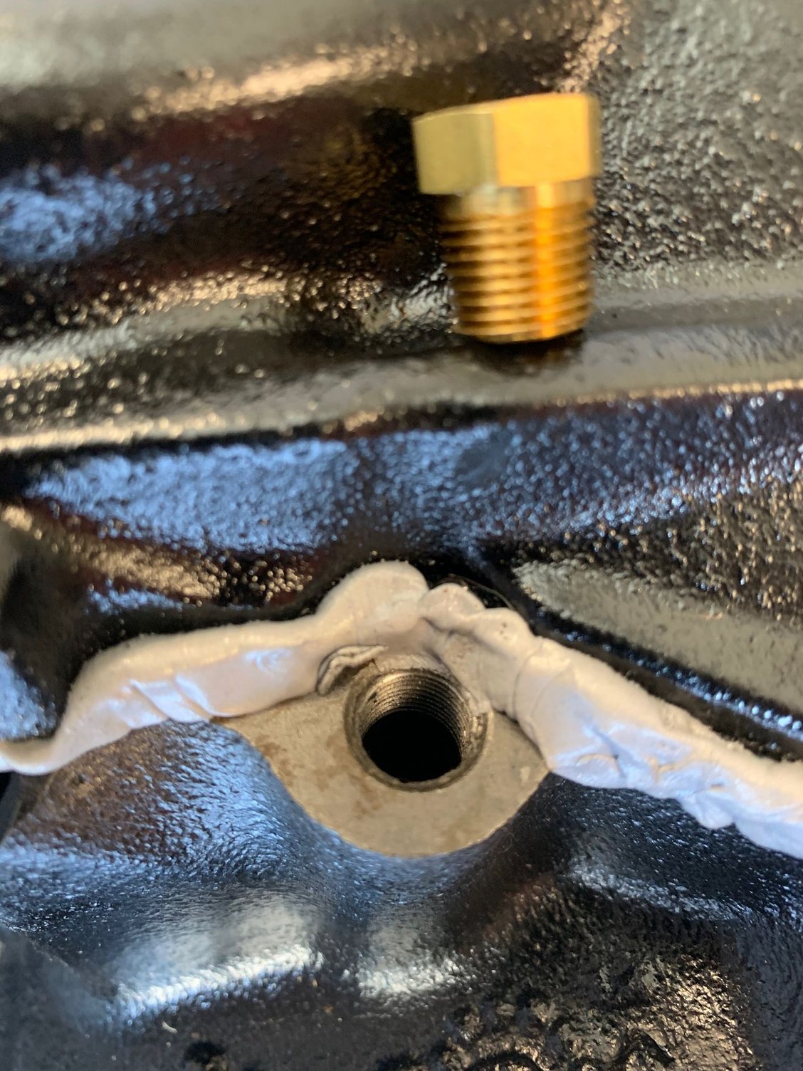

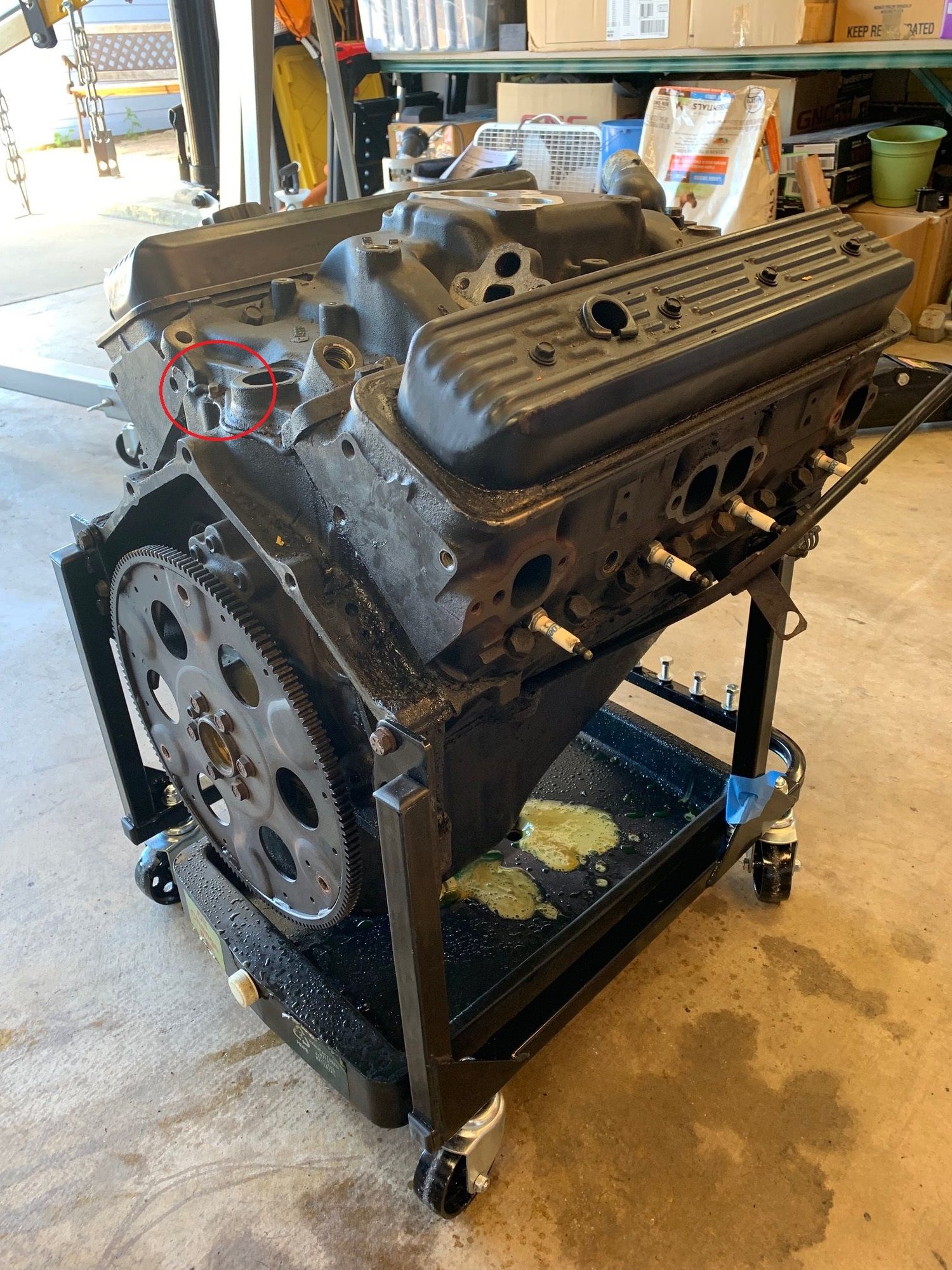

Okay, I need help again. I can't find a plug/bolt that will fit this hole to save my life. I circled what was in my old block so you can see what I'm talking about. I assumed my new engine would come with this hole plugged so I didn't save the old one. Anybody?

1/8" pipe. Unbelievably common. Home Depot and the like, or any parts store or hardware store or plumbing supply place, will have that.
Put it in with Teflon tape on the threads, being VERY careful that it doesn't escape off the end of the plug and dangle down into the hole; or, "Hi-Temp Automotive Thread Sealer with PTFE" from Permatex/Loctite, hanging on a card in the sealer dept of your favorite auto parts store.
That said, the oil pressure sending unit goes there, in most applications. Not sure about yours specifically. Usually requires some additional fittings, like about a 2" pipe nipple and an elbow.

Your oil pressure gauge fitting or sending unit fitting goes in that hole...

I've been to NAPA, O'Reilly's, and Autozone and none of them could figure it out. My sending unit is down by the oil filter. Thanks for the info, I really appreciate it!

That brass plug you already have is the correct plug (1/8" NPT). That's tapered pipe threads. It will get tighter the more you screw it in.
If nothing is required in that hole (sensor), then put some pipe thread sealant or Permatex on the threads and screw it in.

It won't go in the hole, I tried a couple times.

Is the initial thread in that hole buggered up?

I just checked and it went right in. This engine is cursed I swear. It forces me to make a dumbass of myself before it will comply. I appreciate your help!
