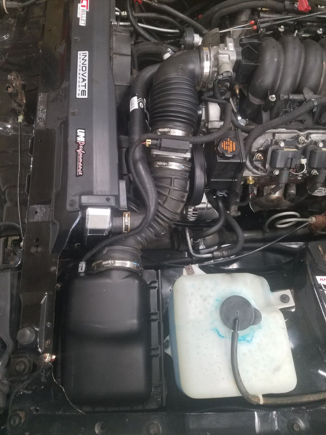

I wanted mine to look stock. I hate the look of shiny tubing and k&n filters so I made a trip to the junkyard lol. Air filter and box from a buick roadmaster(sucks air in from front of box and i put air inlet sensor where they had pcv hose connected on boxlid) the rubber offset hose is from a 08 dodge ram & the pipe with the 90 is from a late 90's cadillac sts.
A little tight crossing upper radiator hose so I used a hose made for 04 dodge neon and it fits better offsetting towards radiator more and fits perfect no trimming

Shifty, that is a good shout. The seperator plate they made is very nice! Sounds like a bit of work to pipe an air intake all the way down there! But that sounds like the best option for air flow in our cars.
2knight, thank you! That looks fantastic! That seems to a be a great inexpensive option. I think I may have to copy that...

It only cost 25 bucks but alot of searching to see what would work. The hard parts done lol. I was going to put a hole in the bottom of airbox and use a holesaw to cut through tray area and use a gasket to seal it up and draw in cooler air. I didn't do it because i didn't want to cut it up in case plans would ever change. Air temps stay cooler than k&n setup as is though so I'm satisfied and it was cheap and i think it looks as stock as possible.

ebay is the lazy way lol. Glad i could help. I did have to heat up elbow that connects to throttle body with a heat gun and stretch it and it fit very tight but it will fit after stretching.
