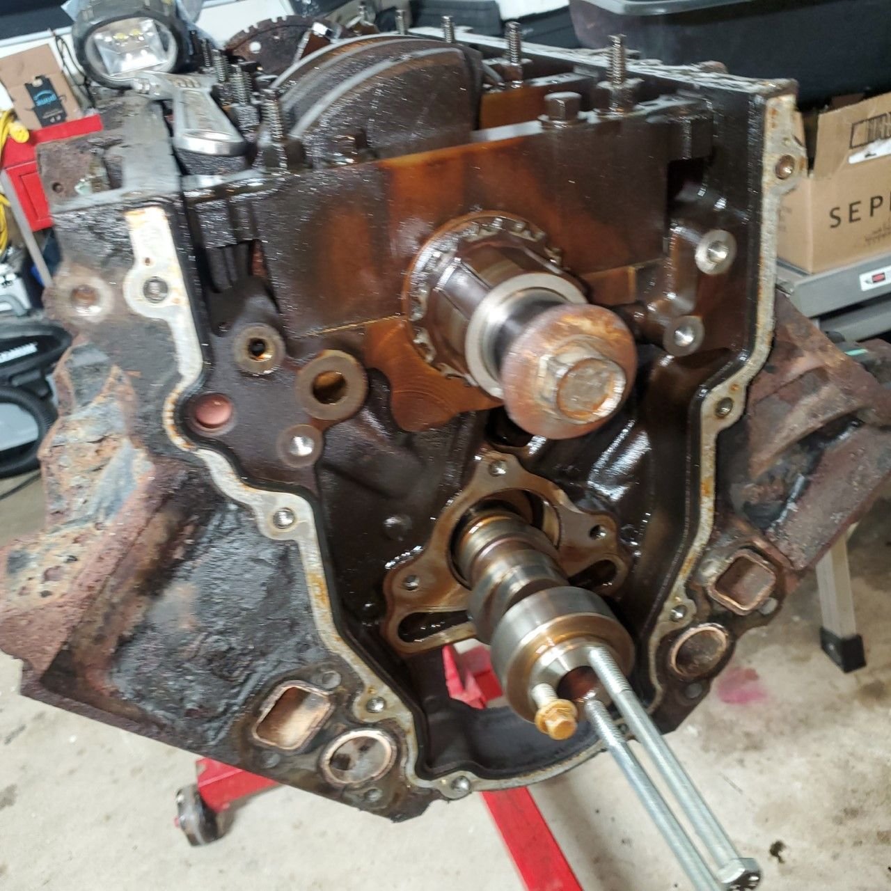

Hey guys, I have a lq4 basically completly stripped down, all thats left is the cam, crank along with the pistons. I am having a very difficult time removing the camshaft, I have some long bolts attached to it for leverage but i can only wiggle out a third of the way. Could there be an issue with the camshaft bearings?

oh, okay Ill send a picture of where im at

Looks ALOT like a journal is hanging up on a bearing.

What could I do if thats the case?|

I had a hard time getting the cam out of my LQ4, wound up that one cam bearing had come out of position with the cam and was getting hung up. You will probably have to pull hard and turn the cam at the same time. Maybe even set the block on end so the bearing isn't stuck on a lobe or journal while you're pulling
This. Also, take the rear cover off and look in from the back. You should be able to see the other side of the cam and what it might be hanging on or if there is a bearing that walked out and jammed against a lobe.
This is what I'd do. It's AHELLUVALOT eeeeezyer to persuade reluctant parts by pushing, than by pulling on them.
I'm guessing a bearing will come out along with the journal it's involved with. You'll probably have to cut the bearing in half to get it off, to then get the cam the rest of the way out.

Sorry, I ment to reply to this but this is the sucker

Gonna take the block for new bearings and to be hottanked

Yeah that's kinda what I was expecting to see... bummer, but only a minor stumbling block really.

Buddy had to go through his LQ4 for the same reason. Cam bearing walked out.
