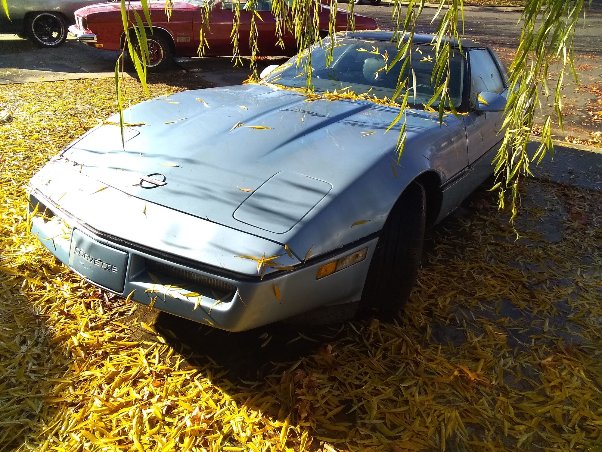

Horacio's Avatar
Joined: Dec 2020
Posts: 3
From: Modesto California
Engine: 2.8l v6
Re: I'm trying to put a 1985 l98 Corvette in a 1989 rs camaro body
my donor car and my RS pride and joy XD
Old Dec 14, 2020 | 01:22 PM
427seven's Avatar
Joined: Jan 2019
Posts: 576
Likes: 507
Car: 1989 Firebird GTA
Engine: Motown Aluminum 427
Transmission: TH400/GVO
what kinda rear end is in that vette?
