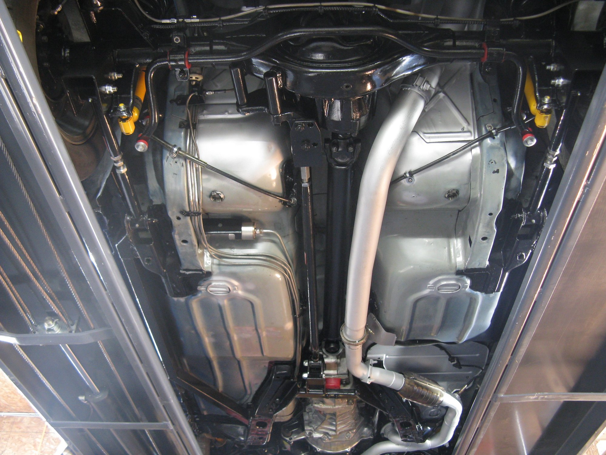

The piece you see on the left, but that isn't present on the right, is CRITICAL to the performance of the SFCs. Without it, there's still NOTHING but the floor pan, holding the car together.
Ideally, SFCs would have a flat strip or something, maybe 3 - 4" wide, that would tuck right up to the floor pan in that area so it would go up over the exhaust, instead of that bar that just barges right through the middle of that space. I've never seen any such thing though. Wouldn't be too hard to make something like that to retrofit onto most any of the better SFCs like those in the pics.
Alternatively, it would be great if there was a way to run the exhaust in the tunnel close to the transmission, instead of taking the outer route that the factory used. That would cause other problems though, not sure if it's really practical at all to do that if for no reason other than ground clearance. That spot is already in danger for ground clearance in these cars, especially with a T-56 crossmember.
I don't agree with what you are saying. Do you actually have evidence of that? It did reinforce the chassis. The right side is welded further down to the subframe. Upon lifting the car with a floor jack one corner at the time, the doors open/shut perfectly where before it would not shut and offset almost an inch. It prevents the floor from flexing. It did eliminate rattles and squeaking sounds. That's hard evidence.
Now those are not the ultimate option but they work fine, are affordable and can be installed easily. It is a nice upgrade from stock. Really made a difference on the street, where this car spends most of its time.
Just my eyeballs. I saw a "frame" on either side of the tunnel, and a nice square-tubing SFC down the sides of the car, and NOTHING connecting them together on the pass side except for the floor pan.
Without that connection, sure, they're an "improvement"; but WITH it, ... it becomes almost a solid car instead of a wad of tinfoil.
No that pic is not mine. I ganked it from somewhere A LONG time ago.
