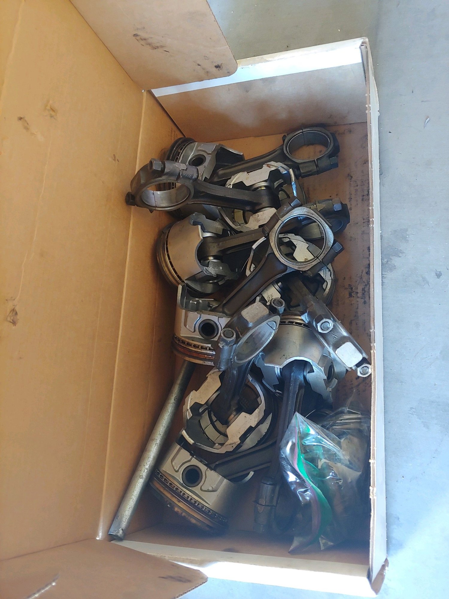

So I do know that it was bored .040 over, making it a 357. I have Edelbrock heads on it, as well as a carburetor setup from my mechanic's Corvette he is parting out. I had new pistons installed, but they were bought of someone else who never took them out the box, so I don't really know what type. I'll add a pic. And I upgraded the distributor to an HEI. Oh, and new headers and will be installing straight pipe exhaust off of another Corvette.

Let's hope that what's in your motor now is better than what's laying in that box. Which incidentally isn't stock to begin with, the motor had already been "rebuilt" at least once.

The Edelbrock heads are a good sign, as far as they go. They're not "The Fastest" thing out there, but then, that's not what they were meant to be. They're a VERY GOOD street head although not a racing one. A good foundation to build on, as far as that goes. That would depend on what the pistons and cam are, which if you can post the PART NUMBERS off of the boxes, we can maybe identify them, and point you further in the right direction.
