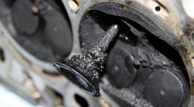

The Fuel-System and Injectors are a high maintenance System, and will build-up large deposits in time that will hurt performance.
The Image below is from the wonderful GM (Isuzu and Suzuki designed) 3.6L V6 Engine (but is just as bad in the Gen-5 SBC):
When this bad, the Engine must be disassembled... cleaning services will not do enough.

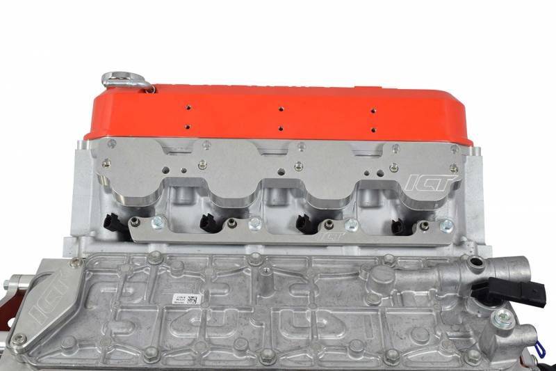

Or do the Gen-5 SBC but disconnect/ block-off the Injectors, and install an aftermarket Intake-Manifold that uses Port Injectors:
