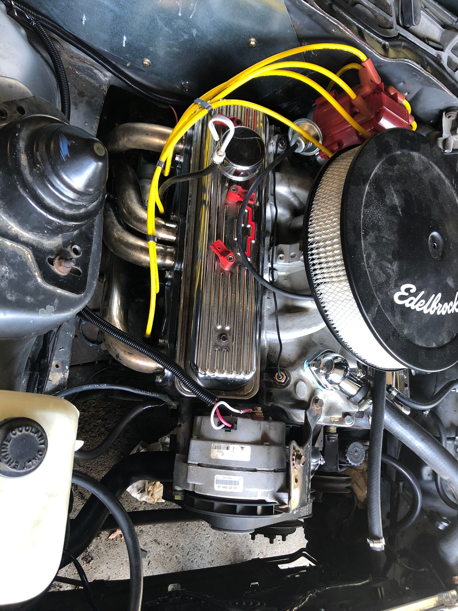

Please post some pics of the motor

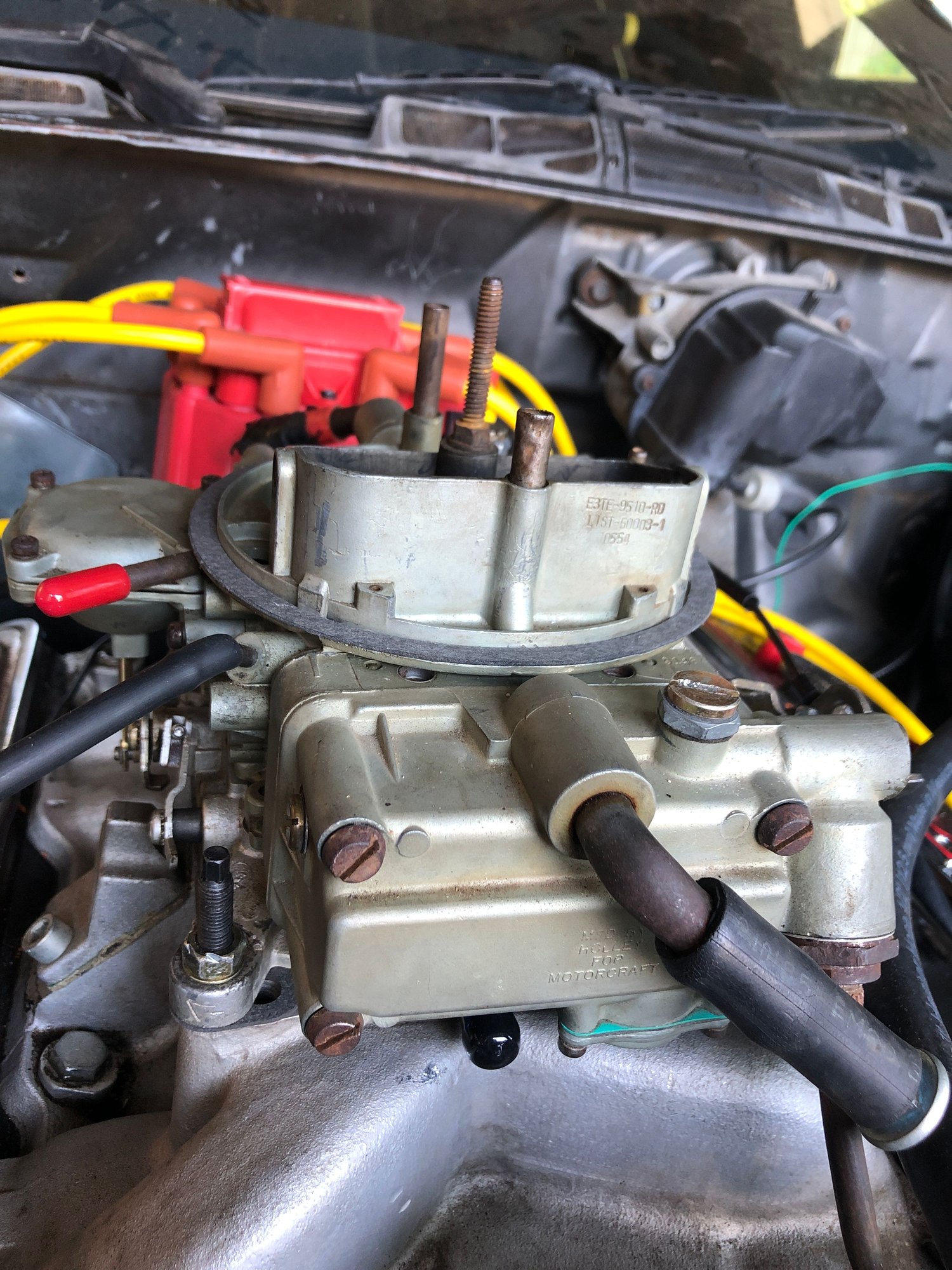

I see a Holley built Carb for a Ford "Motorcraft" Engine.
Actually Holley built Carbs for many different companies...
There were quite a few GM Rochester Carbs built by Holley.
Old Oct 14, 2021 | 11:19 PM
Posts: 28,025
Likes: 2,496
Re: Help i put a 350 Chevy in my v6 camaro and I can’t get it to run right
Yeah as Holley carbs go, that's about as pitiful of one as there is. But that's OK; it should still run plenty OK, just, maybe not as good in some ways, as some others might.

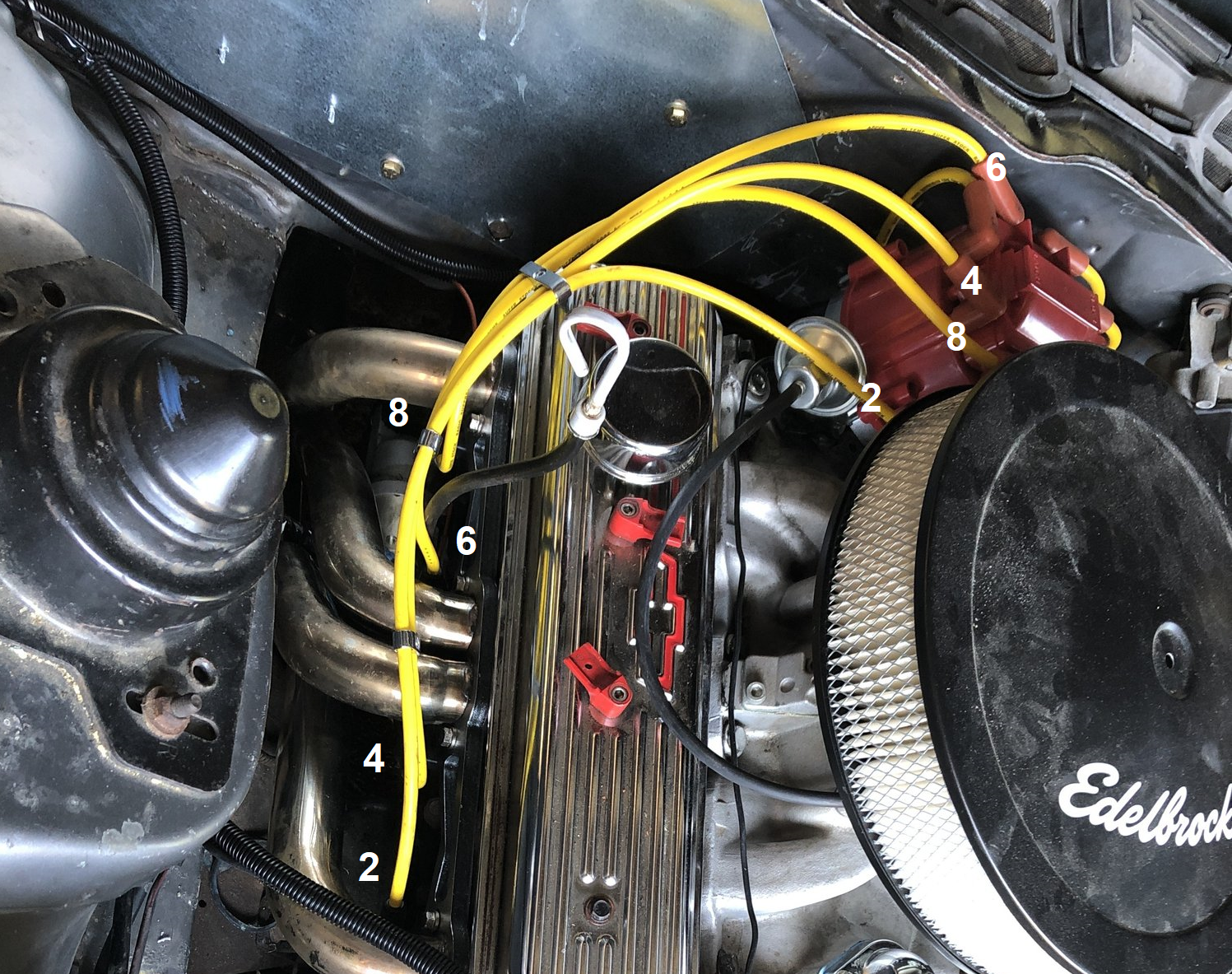

Guys, try tracing his spark plug wires. There is no way he has them connected correctly - 18436572.
Edit: maybe I am wrong. This is what I was able to trace (WHITE numbers). Green are my guesses.
Great catch!!!
Unless the Distributor Cap has the Terminals rearranged... like some aftermarket Caps do, to try and neaten up the Ignition-Wires.
