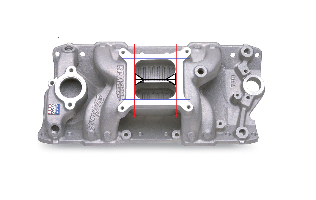

That information isn't lost on me. From most accounts, the Air Gap gets the job done.
Still, there a those that say if north of 6500 is a target, then maybe a single plane may be the way to go.
But...
BTW, a slightly modified and ported Vortec Performer-RPM Air-Gap Intake-Manifold beat out the Victor Manifold in all but one Test for Peak-HP.
That is interesting.
I've read and watched the Performer intakes stepping up their potential with a carb spacer but haven't seen anything (verifiable) with a spacer on top of the RPM Air Gap. That too is something I'd like to experiment with when I'm back at the track.
Old Nov 29, 2021 | 09:55 PM
vorteciroc's Avatar
Top Answer: 1
Joined: Jul 2006
Posts: 2,867
Likes: 789
From: 212 is up in this Bit@#
Re: gen 1 sbc into 92 z28

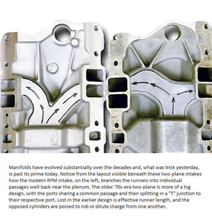

An Engine with a higher RPM operating range/ higher power band, can definitely benefit from a Victor Jr. or Super Victor.
Also there are single-plane Intake Manifolds that are intended for lower RPM use... and can increase peak HP.
When comparing a Dual vs a Single Plane Manifold...
If the Engine makes peak HP at 6,500 RPM...
and the Single Plain Manifold produces less HP below 7,000 RPM...
Well there is no point in using the Single Plane for that application.
The Vortec Performer RPM Air-Gap Manifold, and the Super Victor Manifold produce results of a similar nature.
Also by removing the Dual-Plane Divider (increasing Plenum Volume), adding a 1" Spacer, preferably a HVH Spacer (increasing Plenum Volume), and some minor porting...
The Vortec Performer RPM Air-Gap Manifold can beat out the Super Victor Manifold, in Peak HP (below 7,500 RPM), while retaining the higher Average HP of the Dual-Plane design.
Not to mention, keeping the higher Average and Peak Torque of the Dual-Plane design (not as important with 400+ Inches... but i would never actually use these Heads for an Engine that size).

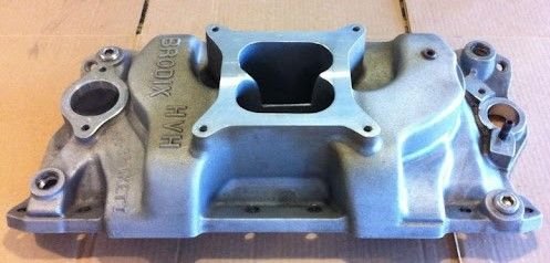

Originally Posted by skinny z
This quite possibly the direction I'll be going.
Nice!
When I modify those Intake Manifolds...
I TIG weld the HVH Spacer to the Manifold, and re-shape, contour, port, and blend the Plenum opening and Spacer into one uniform opening.
The material/ areas that have Black Lines outlined, are removed and re-shaped to be more like a Single Plain opening:
The taller Manifold/ larger Plenum area, with the transition from the ported HVH Spacer into the ported shared Plenum space...
along with some Runner transition porting, and Port-Matching... really improve the already great performance of the Intake Manifold.
The HVH Spacer is shown Upside-Down in the Image Below:

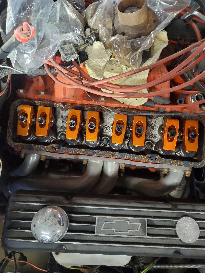

ok got some info on my gen 1. 350 4 bolt 30 over. world products heads roller rockers summit 1102 cam, air gap performer intake with a Q jet. Does this combo make sense for my gen 3 92 z28 305
Yep.
Pretty much like any of the hot rodded 350's that are in these cars. More or less.
The devil is in the details regarding if that engine performs or not. But as for fitment, it'll drop right in.
I like the concept and way that spacer extends into the intake - looks like they more or less took one of their standard 1" spacers and milled down the mounting surface. I could see where that would help a good bit on certain combinations.
I've had really good results using the big Brodix 1016 dual plane with a Street Sweeper spacer (below) on 406 combinations making upwards of 600HP. I've never dynoed the two, but I've built near identical 406 combinations using a Victor Jr and the 1016 with the Street Sweeper made better power based on the ETs and MPH - they shifted at the same RPM also. The dual plane combo was a good bit more responsive.
Not meaning to derail the thread (it's kinda related), but curious if you've ever tested one of the 1016 Brodix intakes. I'm pretty sure the Air Gap wasn't available back when I built those engines and wondering if the next one I build If I should go with the Air Gap.

Take notice between the two designs.

Without getting in High RPM (7,500 to 11,000) or High Power at High RPM Designs...
The Gen-I SBC Edelbrock Performer-RPM Air-Gap Intake Manifold is an AMAZING Part!
That visual gives an excellent representation of how difficult it is to actually get a defined runner length for the Air Gap.
Virtual engine building (Like the old DynoSim program I fiddle with) loses that input value whereas with a single plane, the runner length can be used for tuning an overall combination.
The reason I tried the Brodix 1016 with a Street Sweeper to begin with was an old Circle Track dyno comparison against what I think was an SP1 on a 406 making, best I can remember, around 540HP. I think that was in the mid-90’s (?) and I looked to see if I could find it on the internet.
I wasn’t able to find it but I did find the following dyno comparison on a 430-ish HP, 355. The combo isn’t really relevant to something I would build, but thought it might be worth posting
https://www.motortrend.com/how-to/su...fold-benefits/
While the single planes may be a little easier to look at to determine which one might be designed a little better than the other, looking at this dyno comparison, it appears dual planes aren’t as easy. That said, the above test was an RPM against the 1016 and I probably will try an RPM AirGap with the Street Sweeper spacer on my next dual plane build. I really like the air gap separating the runners from the intake floor - now that is an easily seen design improvement.
