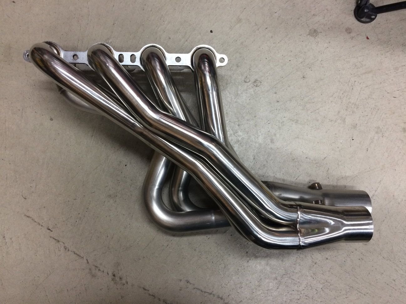

The hooker headers are made higher quality materials but you can't beat the SE headers for the money. I bought a set of the Hooker headers and wasn't happy with the fitment but I'm using the hawks engine mounts so maybe that was causing the clearance issues? In my case the SE headers fit better so I went with them and returned the Hooker headers. The SE headers have been on the car for about 3 years now with no issues. I took a few pics of the headers stacked on top of each other for comparison. The SE headers slide in extremely easy with no hassle at all. The hooker headers were a battle, one side hit the k-member badly.
FYI - I used this ball/socket type of connection on the SE headers, they are small so clearance is very good.
https://www.jegs.com/i/JEGS/555/31934/10002/-1
The SE headers are almost a direct copy of the Stainless Works headers as you can see in the last two pics. Of the 3 sets of headers that I've tried on my car the SE ones fit the best overall. The only fitment issue with them was the shift linkage. I welded and ground down the nut that attaches to the bracket on the trans shift lever to make it clear. The SE headers clear the frame rails much better than the SW headers. The SW headers were extremely close to the frame rails on one side, I had a slight bend welded on one side for extra clearance before the flange. The SW headers are nice though and overall fit well, I would have no issues using them either.
Good luck, hope this info helps.
SE vs Hooker headers
SE vs Hooker Headers
SE vs SW headers
SE vs SW headers
Interference with nut on shift linkage nut with the SE headers.
