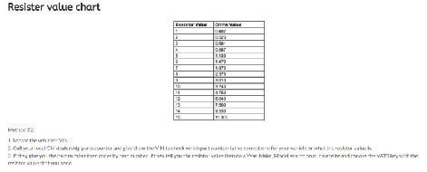

15 different key resistances values. Or just use this
https://www.ebay.com/itm/29509600694...3ABFBM8Neel71h
to get to crank will need to bypass the starter enable relay under the drivers side kick panel.

The vats passkey module has 15 possibilities of resistors used. The hz module will send a frequency needed to enable injectors. Since it’s sat for so long you need injectors anyways but can test for injector pulse with a noid light. Several ways to defeat vats if your just missing the resistor in the key you can get the 15 pack of resistors to try off eBay , a vats delete chip or hz modulator all options.
if you wanting just vats delete and can mail in your computer chip I can do it for much cheaper than the link. But the module or chip reprogram are the best ways to tackle this problem. The key reader bypass still leaves the passkey module in the system as a failure point. Vats is nice to have can always get the resistors have a key cut after you find what resistance is.

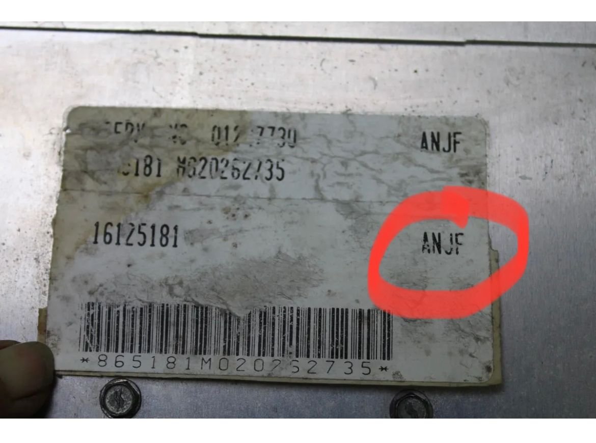

I think your talking a the ecms chip, if original it has a service number and 4 letters on the same tag showing what chip was used for engine transmission combo.
Broadcast code?

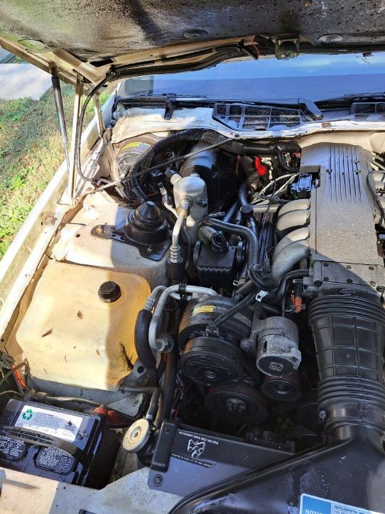

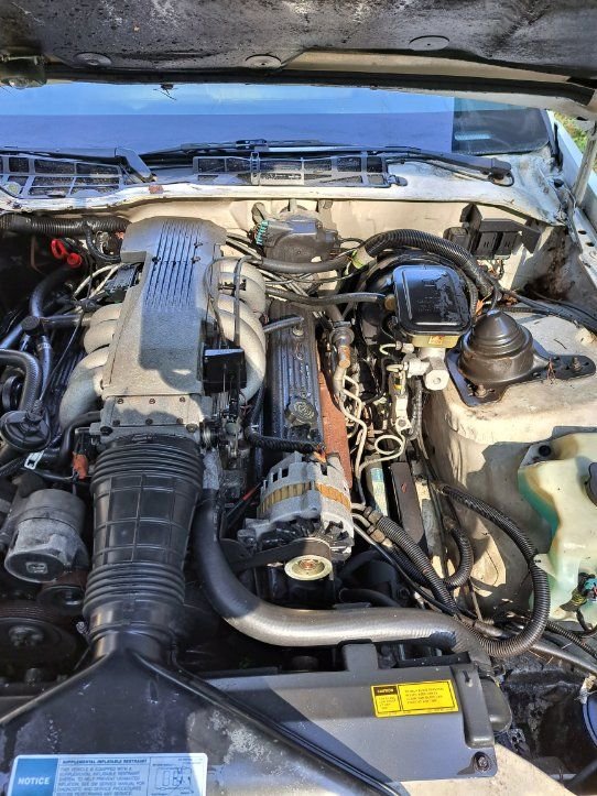

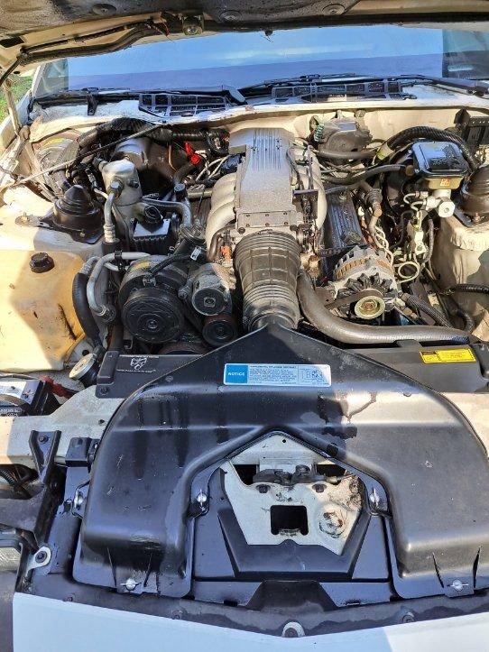

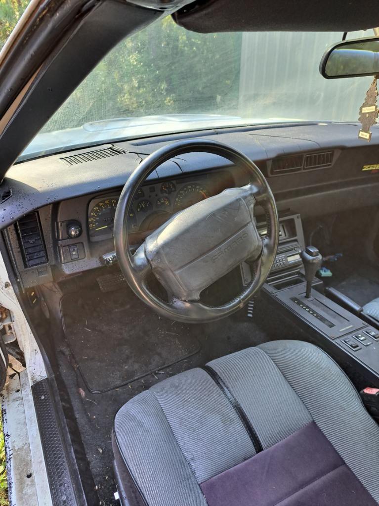

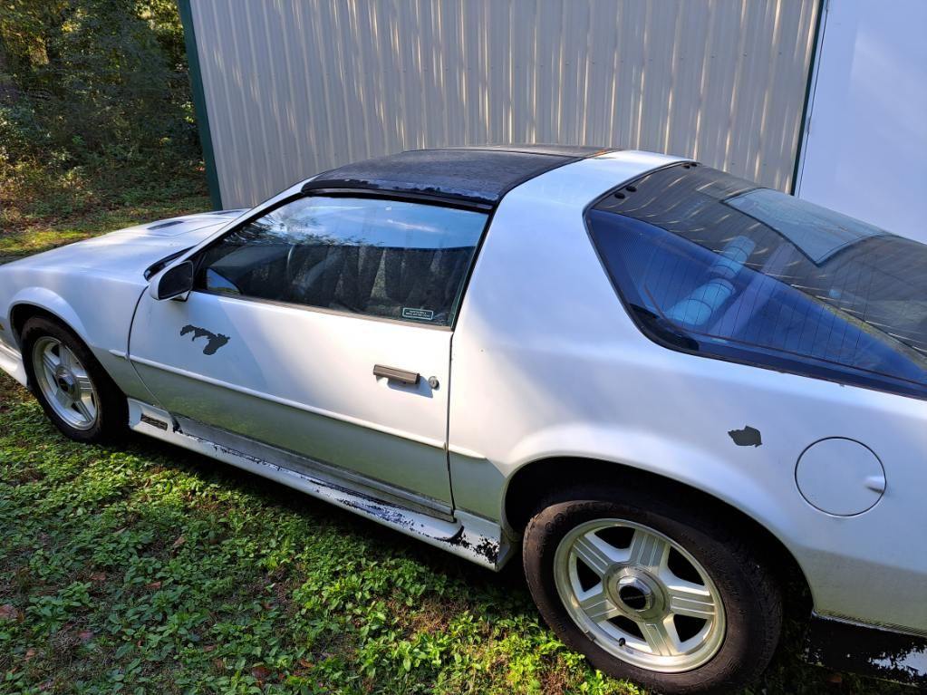

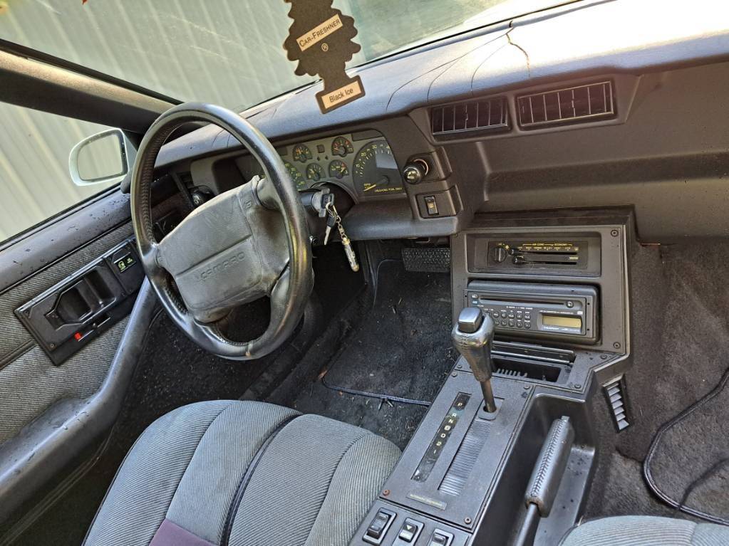

Just got pics of the car. This is the first time I've seen this car in 10 years. Kind of pissed. They didn't even keep it under some kind of cover. What the hell

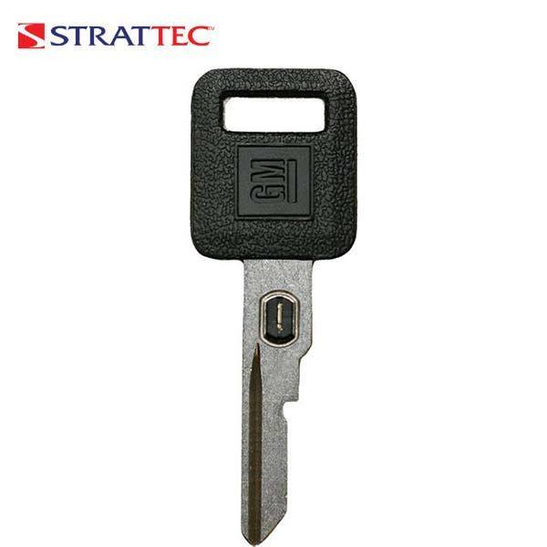

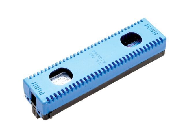

Here is a pic of the chip in the key. The black plastic with the metal tab in the shank of the key is the chip. This activates the Vats and enables the injectors to pulse.
This is the "prom"that the ECU chip sits in. It is under the blue cover. This is located in the ECU which is located under the dashboard on the passenger side. If this was removed the ECU is probably just laying on the passenger side floor board.
Lastly, the "Chip" this is what gets programmed. This controls way more than just the vats so if either this or the prom are gone it won't do much of anything. Neither of these 2 ECU items have anything to do with a VIN. # specific. The 15 resistor codes do and those are what is in the Key. Hopefully this helps and gives you a visual of what you are looking for when you get to the car. I can with great confidence tell you won't need a engine swap because the only way this fixes your problem is if you go carb!

Re: HELP NEEDED! Z28 1992 needs engine swap because missing chip?
If hawks has a memcal just have them reprogram the soldered in chip.
it’s uv erased. No need to buy there adapter in conjunction with a memcal.
if it’s a 305 automatic AXXB broadcast code 350 automatic would be AUJP or ANJF would work. Several codes will work for 305 automatic but it’s always a good idea to uses the latest tune released. Hawks charges $200 for a 1227730, $175 for vats delete chip and who knows how much for a real v8 memcal. Cheaper replacement options a 730 ecm working should be $75-100 shipped . Memcals are the harder to find for speed density . I don’t see anything listed on hawks site and scarce on eBay even.

Thanks man, so it sounds like I need to get an ecm computer, a prom chip (I think it's gone but I'll double check) and a key chip? Or, I have to somehow get the key chip to bypass vats so the injectors can pulse, which is where getting a chip that is tuned with vats comes in?
The PROM is inside the ECM, so if they weren't separated then you're missing both. It looks like the key is in the ignition and it's been turned so it's right for the car, so don't worry about VATS for now. It's more common for people to have VATS issues than missing computers and it was unclear from your original post what the problem was.
Your first step is to get the right ECM with the correct PROM in it and plug it back in. It is highly likely the original problem with your vehicle was not VATS or the ECM. What you were doing back in the day is called a neutral drop, and it's a great way to destroy a transmission. So, likely a rebuild or replacement there, but that's something you'll need the car running to diagnose.

Not to be an a**h*** but are we in La La Land here?
The least of your concerns should be the ECM. Easy fix.
However, by the look of it, you are going to need more than an ECM to get it going! I would try turning the engine manually first. Then if turns, I would put a battery in it and check for fire, smell and look for smoke. Then, I would check the engine oil and maybe drain it to see what it looks like, might find pile of water. Then I would use a starter by pass device to activate the starter see how it turns. If you make it that far, not so bad. Then maybe look at the body see if not too rotten. And then, maybe see how the wheels are turning
I would not spend any money on an ECM before you do all that. If you are satisfied, you have more work ahead of yourself before even thinking about starting that engine.
Fuel tank needs removal and assessment
Fuel filter needs change
Injectors are probably shot
Fuel pump probably shot
Brake system probably shot
Tires are probably dry rotted
Would look for mice nests (air box) and wire damage from rodents
And if you ever get it going, there is probably so much mold inside, you'd probably get yourself sick breathing in it... not counting mice droppings.
And if you make it that far, after driving it for a bit everything is going to start falling apart since it sat so long.
Just the brutal reality before you spend $500 on ECM and EPROM
