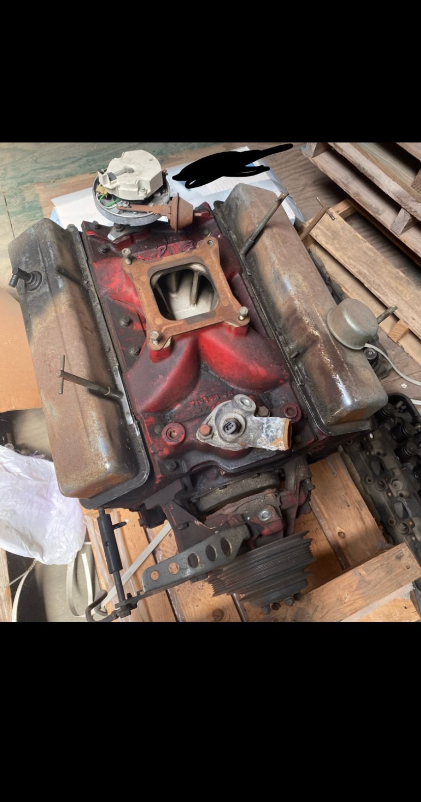

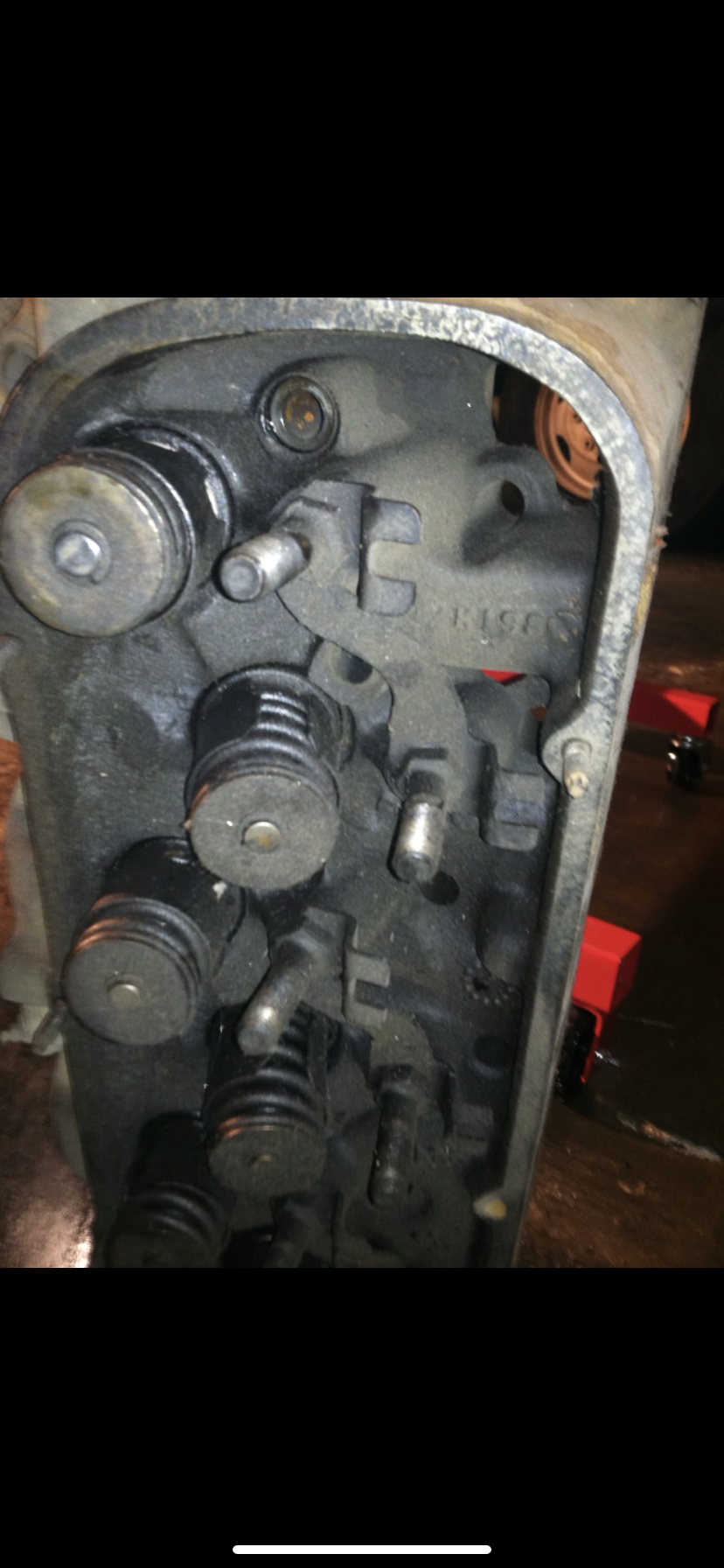

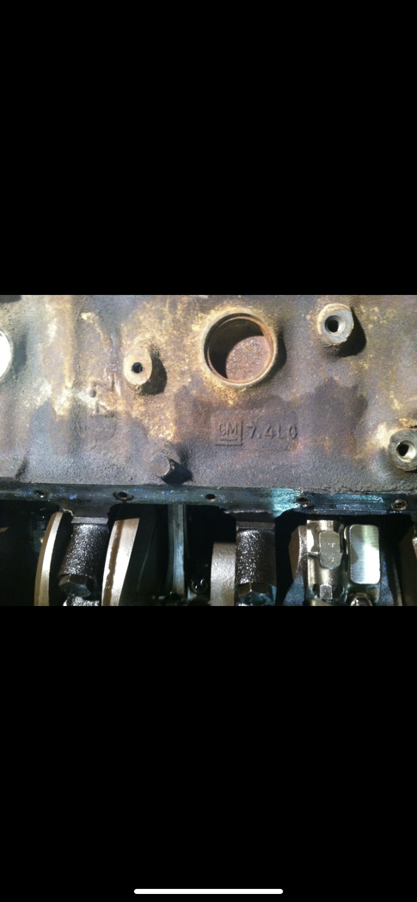

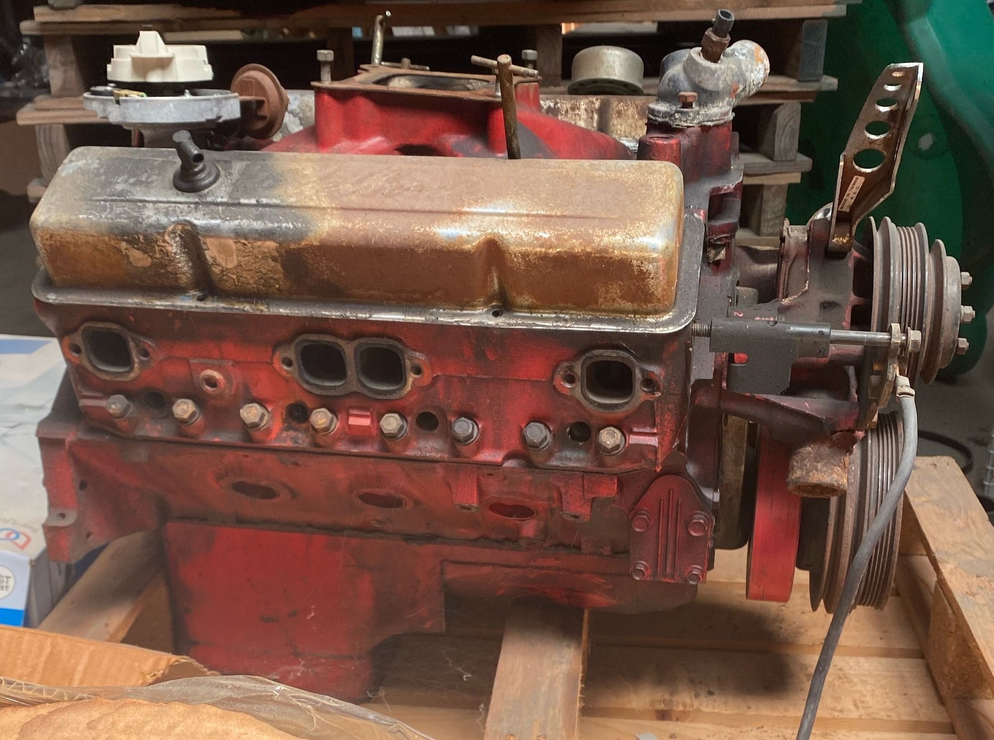

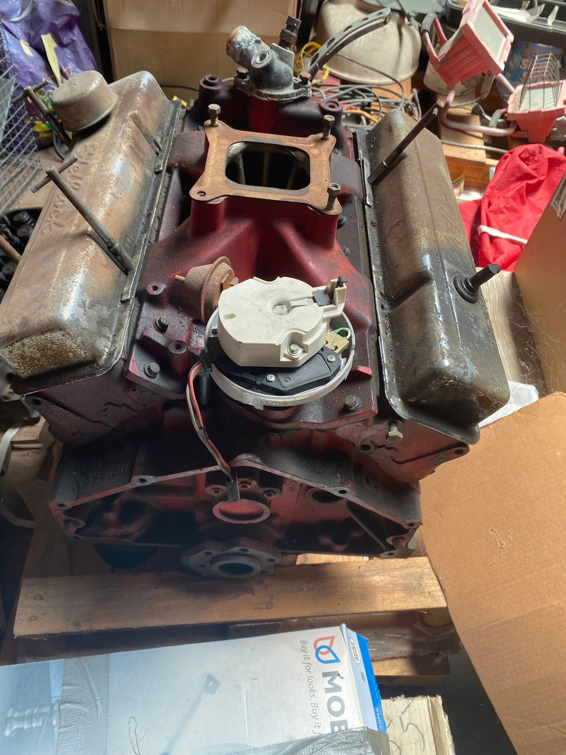

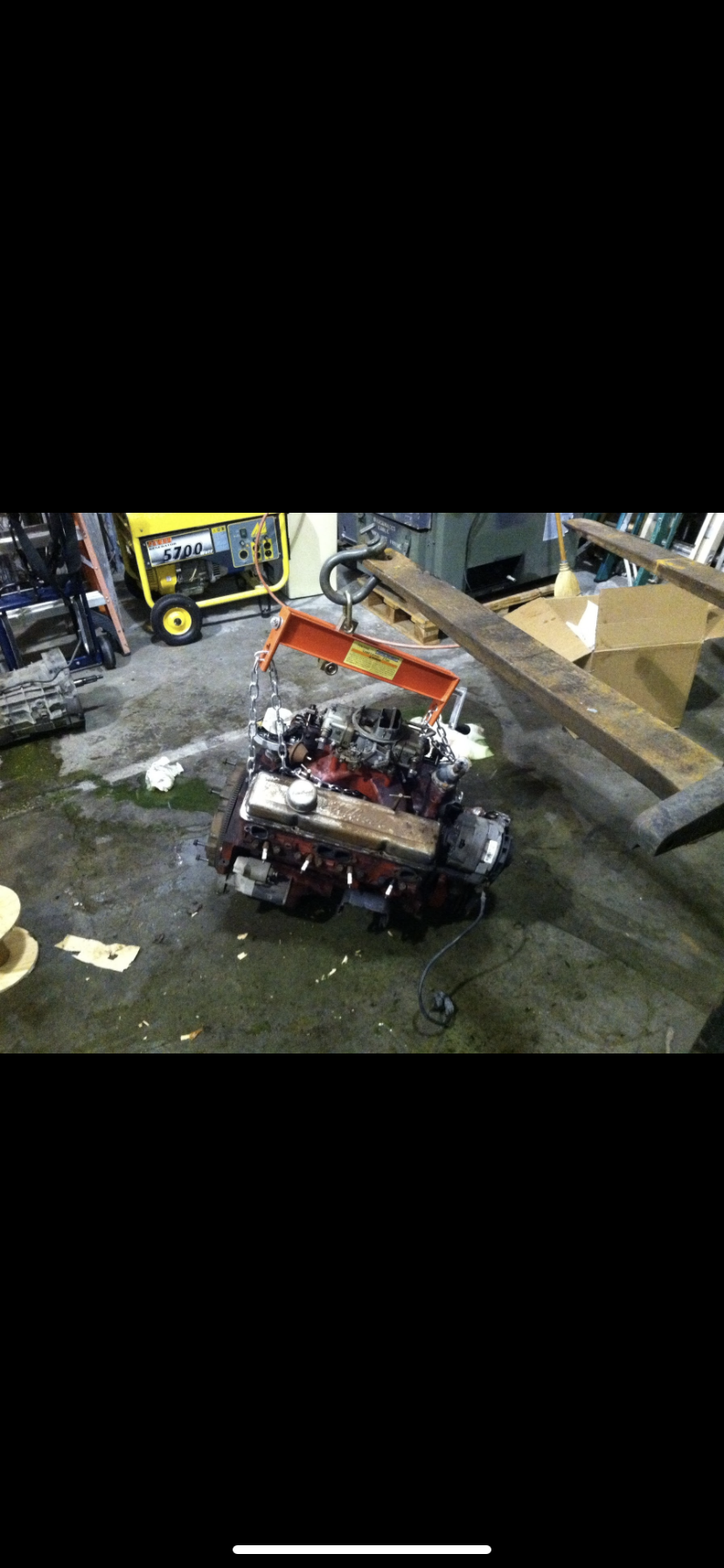

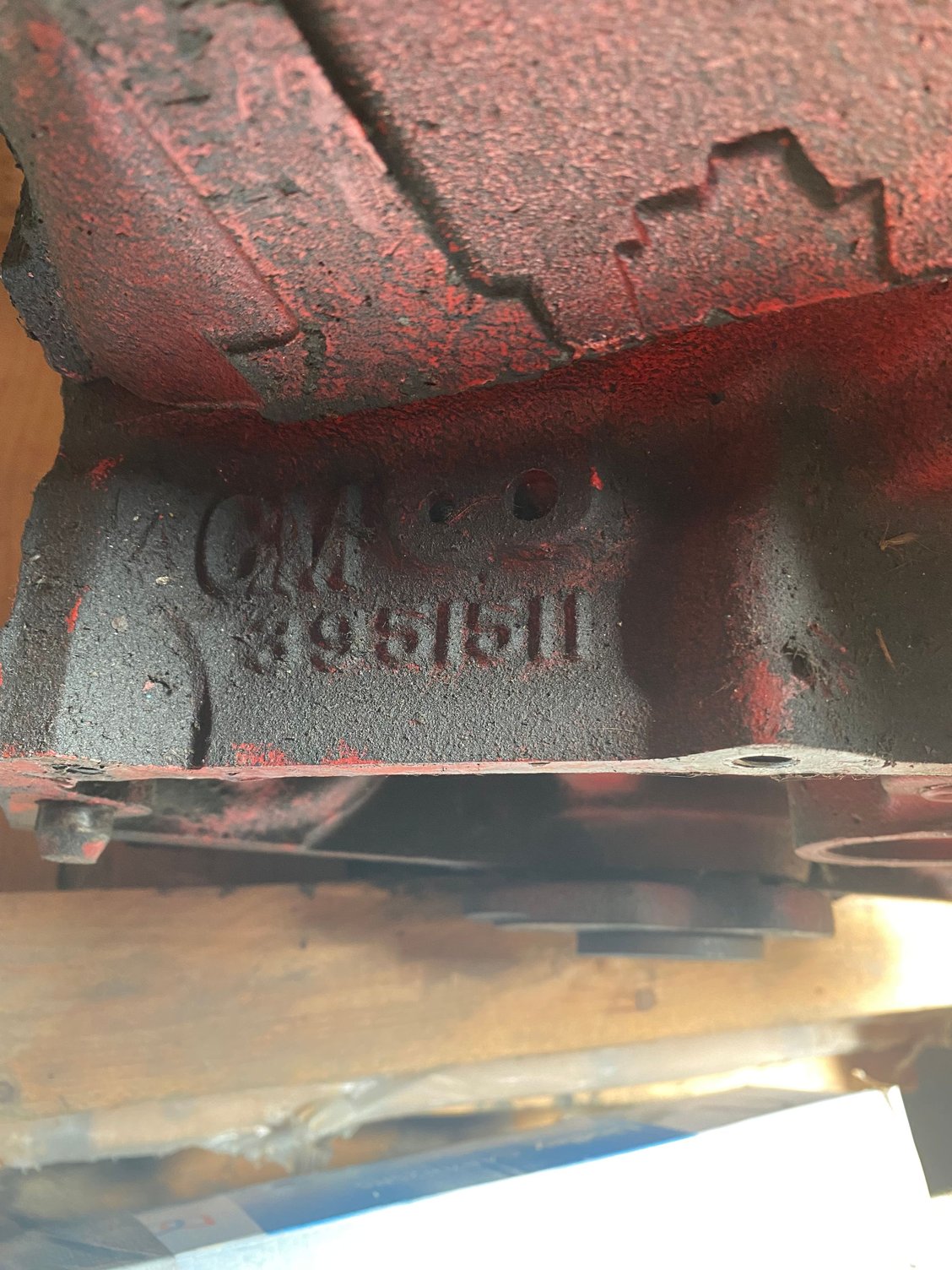

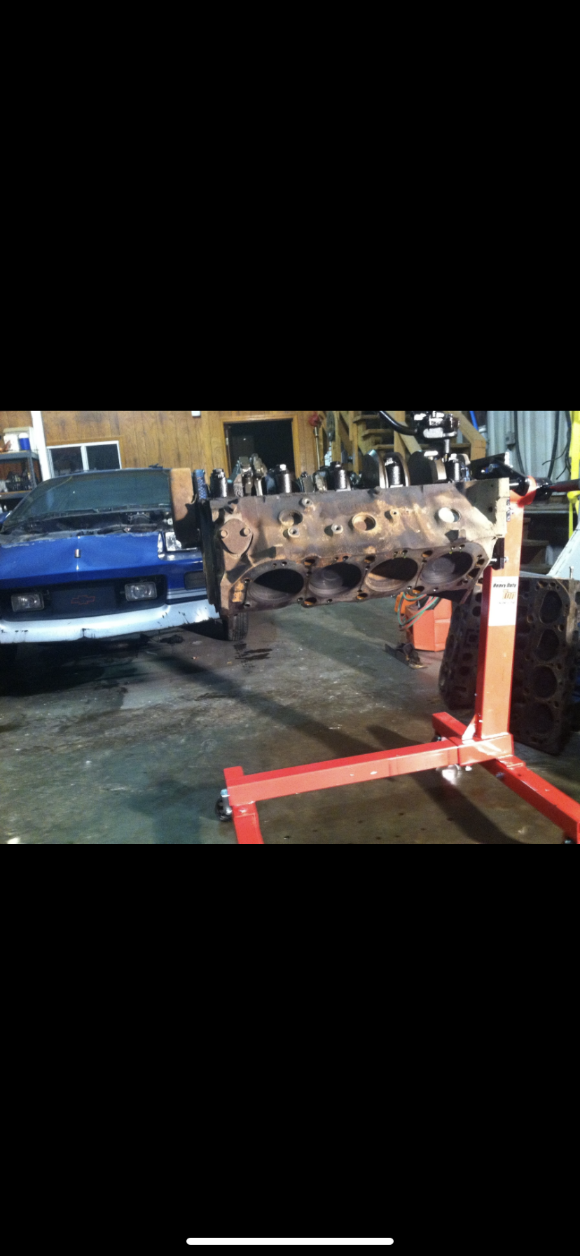

these are the only photos I could find of the engine and I can’t tell if these are photos of the engine for this discussion, but these photos where taken in the same time frame of when my dad pulled the motor out of the car so I’m not certain it’s the 377 because I don’t know how to read any stamps or markings on motors. Worst case scenario I’ll just drive over to the warehouse and take some in detail photos for myself and the thread. Hope this helps. And the car has been off the road since January of 2013.

Re: 377 Stroker
The pictures above are of the 454.
I'd be keeping that regardless but the small block Chevy is what you're looking for. The 400 will have 3 frost plugs per side whereas the 350 will have only 2.
The 400 was converted to a "stroker" by using a crankshaft out of a 350.

The 1st 2 pics (the one in the car and the one with the krome valve covers) are a small block. Could be a 377 but there's no way to tell from those pics.
All the others are of big block stuff. A relatively late-model 454 block, and some big block heads.
Block casting # is on top of the bell housing flange, behind the driver's side head. This one is a 509, a 73 400 block.
The only 400s that had 3 casting plugs were the early 4-bolt main ones; which aren't as good as the later 2-bolt main ones with only 2 plugs like all the other SBCs, because the 4-bolt ones have far less metal in the webbing around the caps, and since they already have the factory's straight bolt holes in them, it's MUCH harder to put in splayed bolts.
Here's a crappy pic of the same 509 block that the casting number is shown.
You'll have to turn the crank and try to get a casting/forging # off of it to see what the stroke is; or, just directly measure the stroke. 3.48" is 350 stroke, 3.75" is 400 stroke.
Head casting #s are down among the valves & rocker studs. Will have 6, 7 or 8 digits, something like 3927186 (referred to as 186 casting). If you see a number that looks like B120 (1 letter & 3 digits), that's the casting date; B120 would be the 12th day of the Bth month (the 2nd one, February) in a year ending in 0. On some stock heads there's a casting mark on the end of the heads; sometimes that's meaningful as well. These are the heads on that 509 block in the other pics. Note the "double-hump" mark; that's one to look for, on stock heads. If the heads are aftermarket you'd need the part # at the least, but even that won't necessarily tell you what valves are in them, etc. These are 186 casting with the double humps.
The heads in your pic with the krome VCs have angled plugs, and appear to be cast-iron and have the accessory bolt holes in the ends probably, so they might be GM 292 casting, World Products such as the Sportsman series, or Dart Iron Eagles.

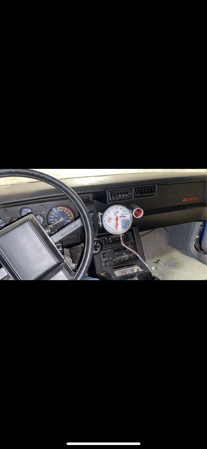

Car looks like it's been worked over pretty hard... hard to tell much about it though. Its usefulness as a project car would depend on what all has been done to it (like if it's a gutted race car) and what you intend to make it into.

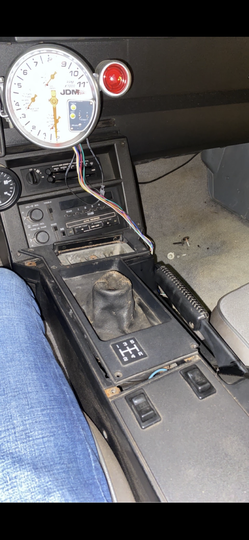

I missed this was a stick car. Totally put a t56 in it w the small block. It will be a blast to drive.

Under the hood, it looks like it's been kinda ... worked over pretty hard. I see harnesses everywhere, no A/C and probably no heater, etc. I'll give it somewhat of the benefit of the doubt though, in that it looks like the motor is in the process of getting yanked. What you showed of the interior looked fairly recoverable though.

The transmission that was in the car with the 377 was a T56 manual 6 speed. if you look in the photo of when the motor was on the ground where you can see the angled plugs you can see the T56 transmission in the background.

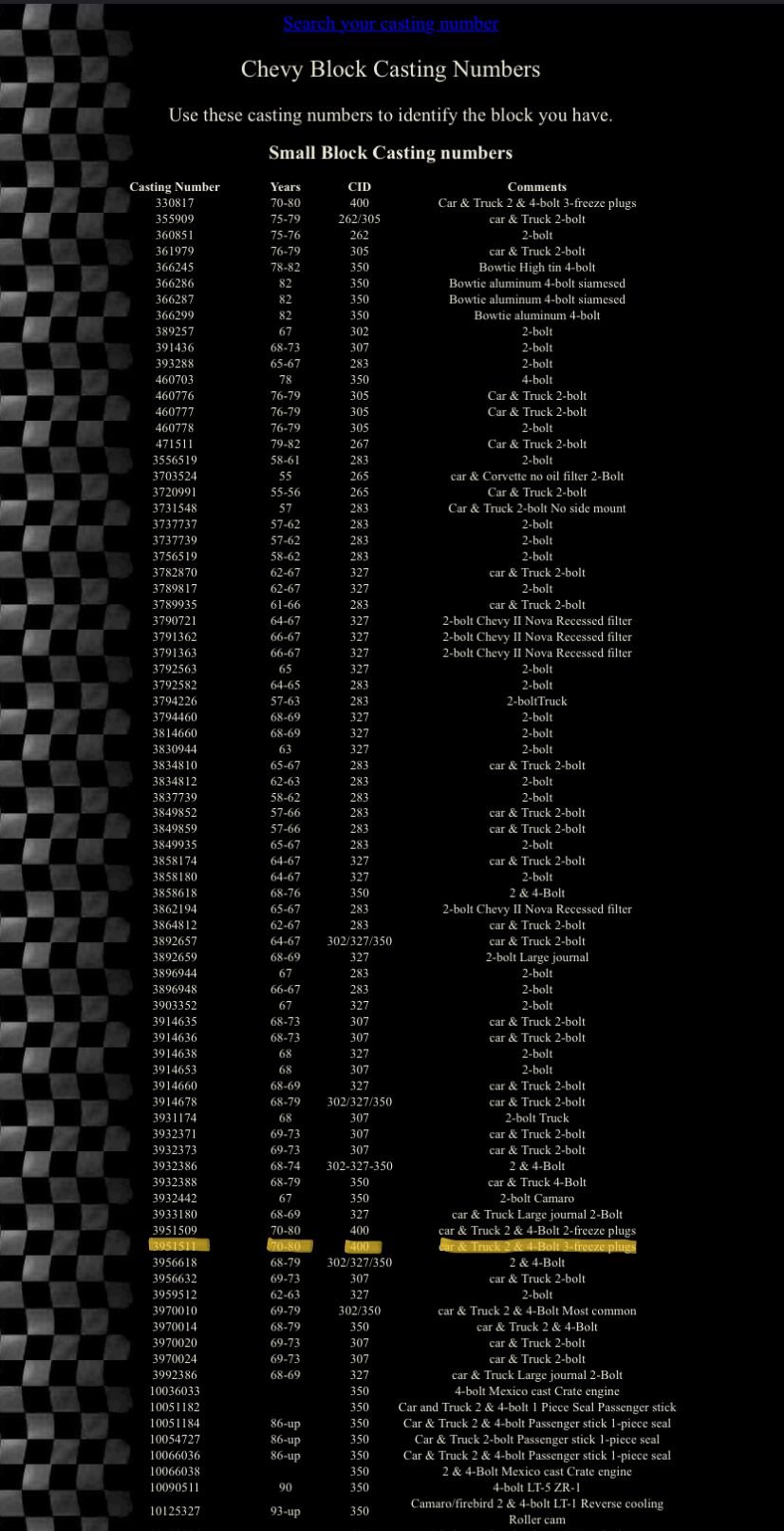

looks like a 400 block to me. The casting numbers come back as a 400 small block made between 1970’-1980’ out of a car or truck.
Posts: 27,893
Likes: 2,436
Re: 377 Stroker
511 block: that's the early (70-71) 400, 4-bolt mains, weeeeeek block webbing. As a 377 then it will be .030" over 400 block w 3.48" (350) stroke. Probably has bearing spacers to accommodate the smaller journals on the crank unless it's a REALLY HIGH-$$$ one with the 400 main journals which would be a seriously special-order deal. Can't tell whether the crank is cast or forged, looks probably forged but hard to be sure.
Heads look like GM, the 292 casting that only has 6 digits. There's another 292 casting # that has 7 digits but that one had the double-hump casting mark like the 186s in my photo up there.
Looks like it had an electric fuel pump in its immediate prior life.
Carb gasket looks like it had one of those Holley 3-bbl carbs on it, but they didn't modify the gasket like it needed, so about 1/3 of the rear barrel was obstructed.
Hard to tell much more than that from the photos.

The webbing was just ... lightweight ... in those. It's just the way those 3-freeze-plug blocks were. You gotta remember, in 1970, those things were put in vans, land yachts, stuff like that; and all had 2-bbl carbs. There were 2 "400" motors in those years; the "400 4-bbl", which was a 402 (.030" larger bore 396), and the "400 2-bbl" SBC 400. Think, grandpa motors, as they came from the factory. They had the worst heads, the worst gears, just the ultimate crap everything. Anybody that wanted anything even remotely "sporty" would go for the 4-bbl. They were set up for max torque; think, tight steering in parking lots with the AC on kind of duty. I don't think the factory ever thought that anybody would ever try to use them for anything more stressful than that. The later 2-freeze-plug 400s, like the one I posted photos of, are ALOT more like every other SBC of the time. My wife had a 74 Monte Carlo with a 400 back then, which was a pretty typical car application for them by that time. It was all but indistinguishable from a 350, viewed from the outside. Cool old car... triple black, every option I know of that they came with, except no tape player. She loved it, drove it well up into the 90s.
511 is the last 3 digits of the block casting #, 3951511. Most of the later ones were casting # 509. There was also a 817 but there's not as many of those. I don't know what difference there is, if any, between 509 & 817. Always looked pretty much the same to me.
