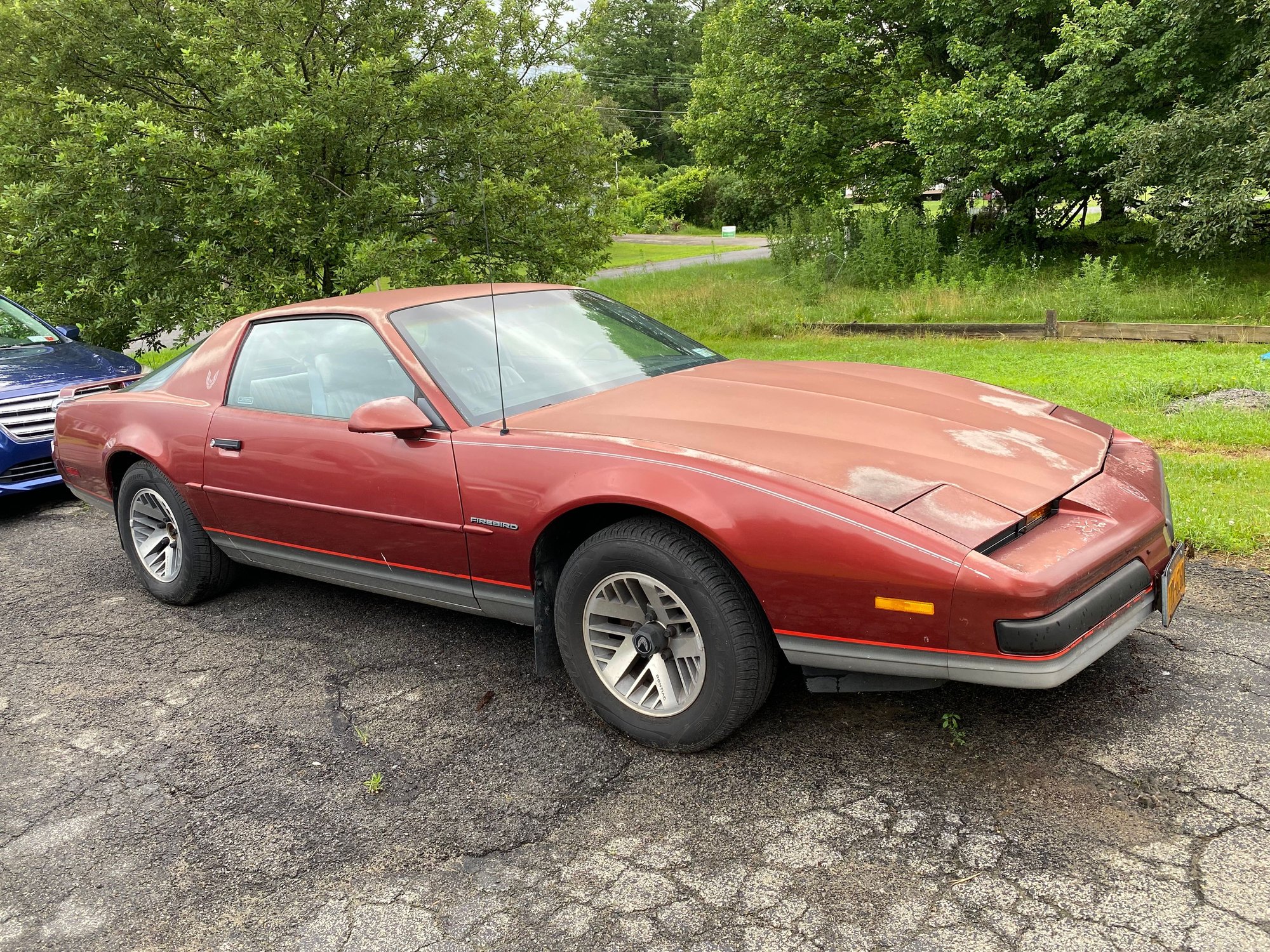

Hi from Rich in upstate NY this is my first post and i am looking for some advice. I have a 1989 Firebird that my Father had purchased brand new and rarely used it. The car has just over 14k miles on it and unfortunately it has a 2.8 v6 and auto transmission. I was looking at the 3800 v6 option but this looks very complicated. I have been looking at the GM Crate SP350 because I would be happy on the 300+ HP range.
My other thought is just put some fresh paint on it and keep it that way it is, any thought would be appreciated

Okay, now I know what we're dealing with.
I guess first things first, it's not worth much because of the paint. It might as well have 150K miles, doesn't matter any more. We're not going to lower its value playing with it.
With that said.... that is the PERFECT candidate for a hot rod build! It's super nice where it matters and won't give you any problems with broken crap, rusted crap, worn out crap, doesn't even need anything done really. What I mean is you can dive into the modifications right away and not have to fix a crappy car like so many people do. Money sunk will be money lost though. It's hard to raise the value of a base model unless it turns out remarkably good.
I was going to ask.... Can you even do that in New York?

I live in upstate NY and you don’t really have to worry about emissions, go ahead and swap to the 350 if you want. As mentioned your car is a perfect candidate for it considering it’s condition.
The car is OBD1 so they will not even put it on the computer so no worries about a sniffer test or any of that non sense. My car has EGR and SMOG deleted via tune and hardware removal and I’ve never had a problem but I upgraded the cat with a Magnaflow when I did the new exhaust as new converters are much better than the old junk.
Now by law if you remove the catalytic converter and all emissions equipment you could get dinged but most guys who work in shops have no idea what these cars came with new for emissions and if they fail you go to another shop. I would keep or get a new performance catalytic converter just to be safe on that front.
Seeing your car i would maybe try to get the hood and roof etc re-sprayed, will look better than it is as the rest of the car looks good IMO and would be cheaper than a full re-spray. I had my hood and spoiler done for about a grand a few years back and it really improved the look.
